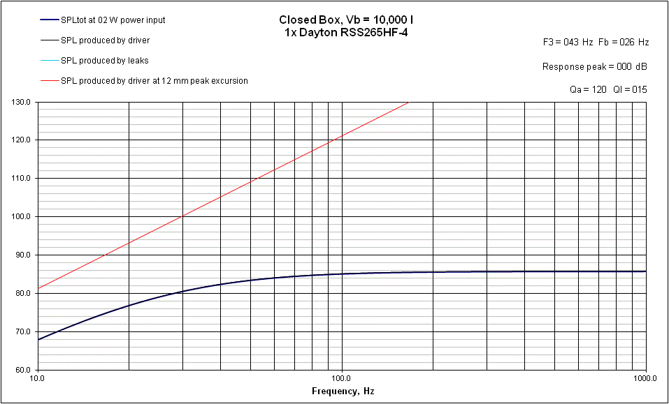

Hi Jeshi,
just out of curiosity, I simulated the RSS 265 in a smallish OB, without any room gain, one single speaker. To make 96 dB at 25 Hz at 1 m distance, the poor driver will have to do +- 34 mm of cone travel. Therefore it´ll need 80 V of input, which makes, due to low impedance, a whopping 1830 Watts...
OB bass was never meant to be effective. But the non-effectiveness, which is due to the omission of any mechanical amplification through resonance, leads to a potentionally clearer reproduction.
Of course, your nearfield applications will change thoese numbers a little bit. In fact, I´ve somewhere read about people using dipole woofers for subwoofer applications, positioned very close to the listener, something like less distance than dipole path. This will change a lot, but I´m not sure how to quantify the effects.
However, a relatively large flower with an 17-cm-driver might actually work in the near field... I wish you good luck and a lot of fun with it, looking forward to learn about your first aural flower experiences!

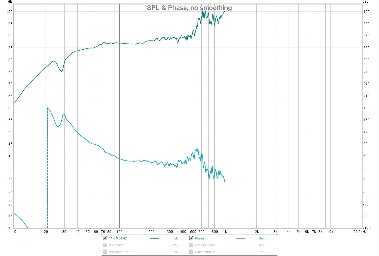

Ok how about this, here is an actual measurement of my RSS265HF at 30cm with no baffle. It is outputting 86db in the flat region so my simulations show this would be with less than 1.5watts output since that would be at 1meter. And the 25hz point actually measured 79db. This perfectly matches with my simulation (79db at 25hz) without any additional OB losses. This is without any DSP correction, just the bare driver. In fact it looks like it is aligning with the simulation almost perfectly from 20hz up to 500hz where the cone brake-up starts to alter the driver response.
Can your simulation replicate this measurement from 20hz to 500hz?

Your measurements look quite good... I could try to resimulate it, but need to know the voltage of your measurement.
It might be that the measuring distance of 30 cm is part of the "problem". Though this is perfectly near-field, it may blend out room effects, which are part of the dipole approach. I choose listening distance for my measurements, and results seem to be in good correlation with the simulations.

I suspect you are right though that the 30cm distance is too short for the dipole losses to start appearing, but I don't think it is quite as awful a situation as your simulations predict. I may be forced to use a U-frame, large baffle, or aperiodic enclosure though to get enough bass.

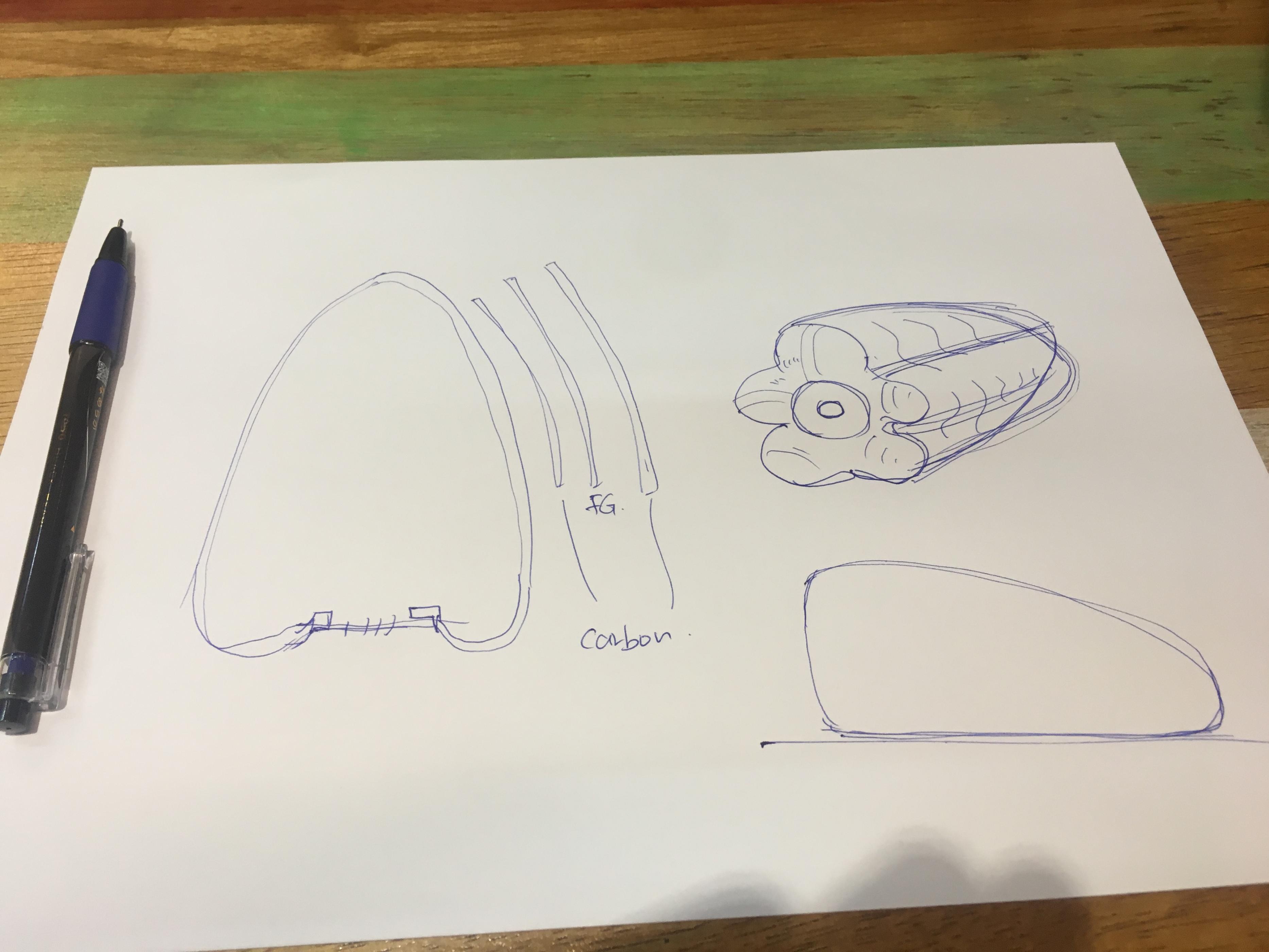

We were talking, and an idea formed in my head. How about doing the flower baffle, but merged into an organic looking enclosure. He has a lot of surfboard foam scraps, so I'll use that to shape an enclosure, and he will help me cover it with carbon fibres. It will be 3 layers. Inside is carbon, middle fiberglass and outside carbon. It will help kill the resonance from the carbon, along with the foam inside.
We were brainstorming this afternoon and came up with this sketch.
He gave me a bunch of foam, so, I'll test my talent of sculptor soon!
Could be fun!
Could be fun!

The Flowers have been a dipole approach, which of course would not work with the single TB 2313, it would need something for the bass. If you strive for a vented or closed enclosure, I´m not absolutely sure if it´s worth the time and efforts to do the flowers. I would think that the teardrop enclosure type should be easier to fabricate and should be sufficient, just study the different commercial realisations (Eclipse, B and W) and the lots of good ideas and discussions here in this forum.
The main reason for the flowers was to mitigate the baffle effect, and I think with an enclosure it´s not worth it.
Laminating with carbon over foam is most possible a good idea and a pretty sophisticated way to do the enclosure, at least if you want to have it visually nice, high-gloss outer shell and such...

The plan is for sealed, which of course will not be a bass monster, but could be used with a sub or two to implement bass.
And yes, it shall be high gloss outer shell... my buddy can do that, and it would give him something to do during those hard times.
Since I'll forego the "flowers", I'll probably move this to the W6-2313 thread again.

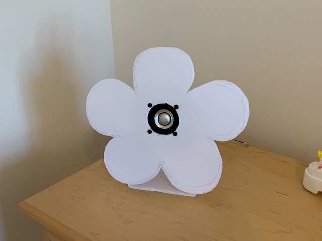

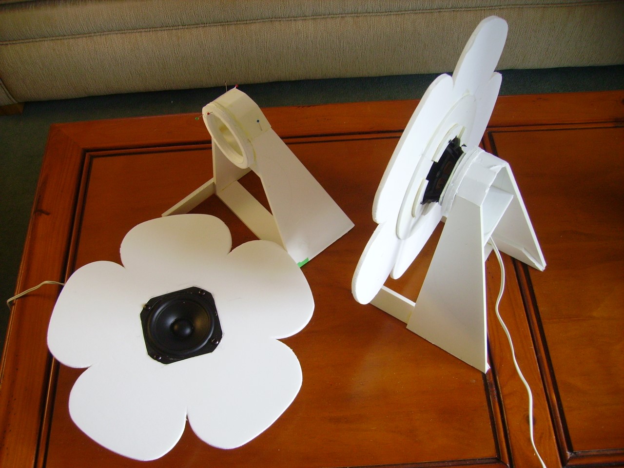

I tried a flower petal open baffle and it sounds a great.

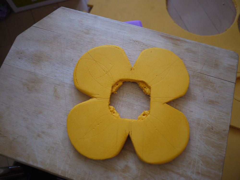

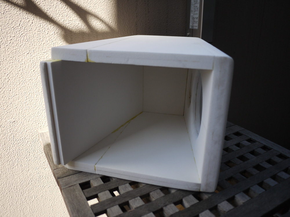

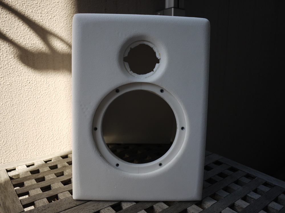

Interesting thread. Great potential here. Although some guidelines have been provided for preferred EVA density (100kg/m3?), it's difficult to get detailed information in imperial terms here in the States. Only information I could find said that 100kg would be roughly 6lb/ft3, which is hard to source. Certainly not inexpensive. Minicel T300 and higher (3lb/ft3) may work though...
I’m not sure the density is that important. Just look for cost effective stuff - similar to the floor mat stuff.
I was thinking more in terms of stiffness. I thought the higher density would be stiffer while still being easy to cut and sand/paint etc.
If stiffness is a concern you could try bonding the EVA to some foamcore as a backer.
Not a huge concern, but I am interested in possible multi-way builds and there appears to be multiple grades of EVA quality. The gym/yoga mats seem to be 2lb/ft3, equivalent to 38kg/m3, which I believe Jeshi mentioned as less preferable. However I was mistaken about Minicell, which is Crosslinked Polyethylene (XPE), not EVA and therefore not as easy to use.

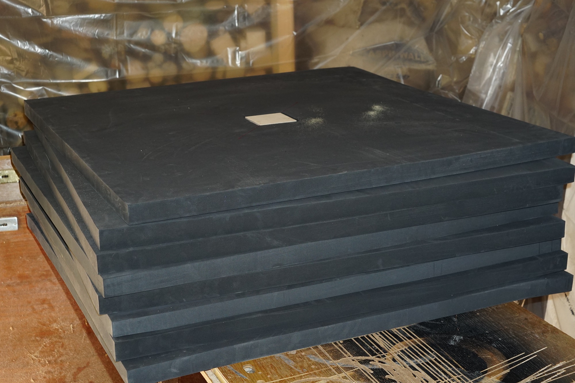

think I was the one who brought up the 100kg/m³ data... but during material tests, I found this density (translates to around 6lb/ft³) preferable to other materials I tried.
There are a lot of factors in play, and all also depends on what you´re doing, so my choice might only be valid for my application. Factors I was concerned with include damping, stiffness, routability, sandability, surface appearance, availability in large and thick pieces, and glueability as well, but that´s mainly a glue question (I used black epoxy).
I searched for long and got my EVA for quite a high price in the UK. Would have been cheaper in China, but minimum order there was one container full of EVA... maybe a group buy?
Mattes
Thanks Mattes. Yes, that high density is hard to find. In the States the only option I have found is the Minicel T600, which is a special high density EVA. It is much more expensive than cheap gym mats at $51 for 48"x72" 3/8in. But still less messy and easier to handle than mdf or plywood, so I wouldn't mind paying more. Amazon also has some possible options that claim 5lb/ft3 (85kg/m3).
