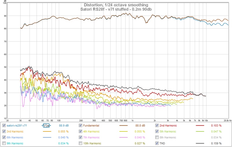

Here is another measurement at 0.2m 90db of my latest configuration with the fiberglass stuffing. This is measured at 0.2m and the level is dropped very low so that it measures on my SPL meter as 90db at 0.2m. This SPL level is close to my normal listening level but rather quiet (about 75db at my listening position). I am doing this to show how getting closer and optimizing the mic placement can cause that >10hz dip to disappear (my "broken" waveguide). Also at this low level and close distance almost all the room artifacts (<1khz) disappear. Also this is too close causing an artifact (close to the crossover point) to appears around 1.7khz. This 1.7khz dip is not real and is only heard at this close distance.
![500185d1440380088-eva-foam-performance-speaker-enclosures-satori-rs28f-20150824-v7f-stuffed-hd-90db-0.2m.jpg](https://www.diyaudio.com/forums/attachments/full-range/500185d1440380088-eva-foam-performance-speaker-enclosures-satori-rs28f-20150824-v7f-stuffed-hd-90db-0.2m.jpg)

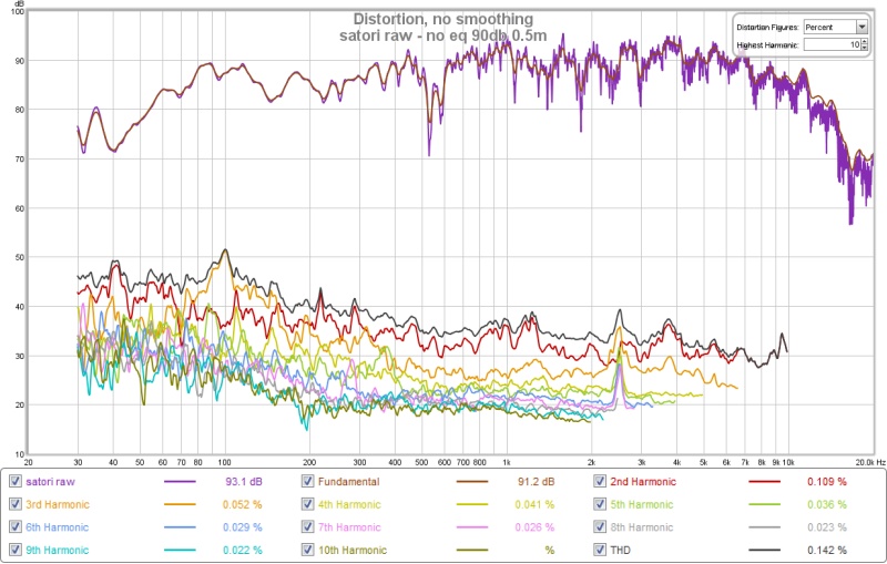

compared to the same speaker at 90db at 0.5m
![499851d1440253971-eva-foam-performance-speaker-enclosures-satori-rs28f-20150822-v7stuffed-hd-90db-fixed.jpg](https://www.diyaudio.com/forums/attachments/full-range/499851d1440253971-eva-foam-performance-speaker-enclosures-satori-rs28f-20150822-v7stuffed-hd-90db-fixed.jpg)
Changing my measurements to 0.5m has made me realize that something is terribly wrong with my "waveguide" and why I want to make a new front baffle for the RS28f/satori.
I was initially doing all my measurements at 0.2m to remove all the room artifacts, but now I think this is too close for a 2way (the angle to individual driver is rather extreme). Now I am not sure I trust if this close a measurement is accurately describing what I hear at 0.75m-1m. I am certain my ears/brain know my room and make also sorts of adjustments to compensate.
Just shows how different mic placement, distance, room effects, SPL... can dramatically alter the measurements (recording). We don't have anechoic chambers. Maybe one day when I get very close to a final configuration, I will take the speaker to an open field for a "room free" measurement
