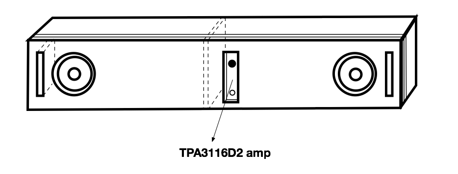

Here's a rough sketch of what I'm planning to do.
Drivers are 3". WinISD comes up with 6 litres for each chambers, which will be sealed separately. 1x10cm. 9cm long for 65Hz.
That should be about 20"x6"x6".
Baffle is doubled, drivers will be sandwiched in between. I'll also put a TPA3116D2 50w amp there, with a 3.5mm plugin.
There will be some bracing, no shown in the drawing.
Will probably need BSC. Getting parts for it will be the challenge!

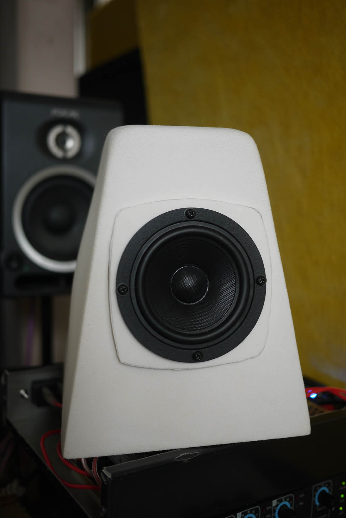

Yes the 10f/8424 finally arrived, actually just today. Placed the order on July 25th and arrived on Sept 7th. sigh... That is the last time I order drivers from EuropeAudio. They never once returned my emails. And it seems like they misplaced my order at least twice. And then they forgot to actually ship it after issuing the invoice, changing the status on their website and even setting up a FedEx tracking label. But someone then forgot to put it in a box and hand it to FedEx. Maybe they are nice people, but they really don't know how to run a business.Noticed over comparison thread they arrivedhope cost and trouble was worth it and they back as very good performers.
Sorry been really busy the last couple weeks so haven't had much time for proper building and testing. I did manage to build a new baffle for the SB65 and Satori and did some initial listening and measurements. I will do the same with the 10f/8424.
I can at least share some photo to tease you

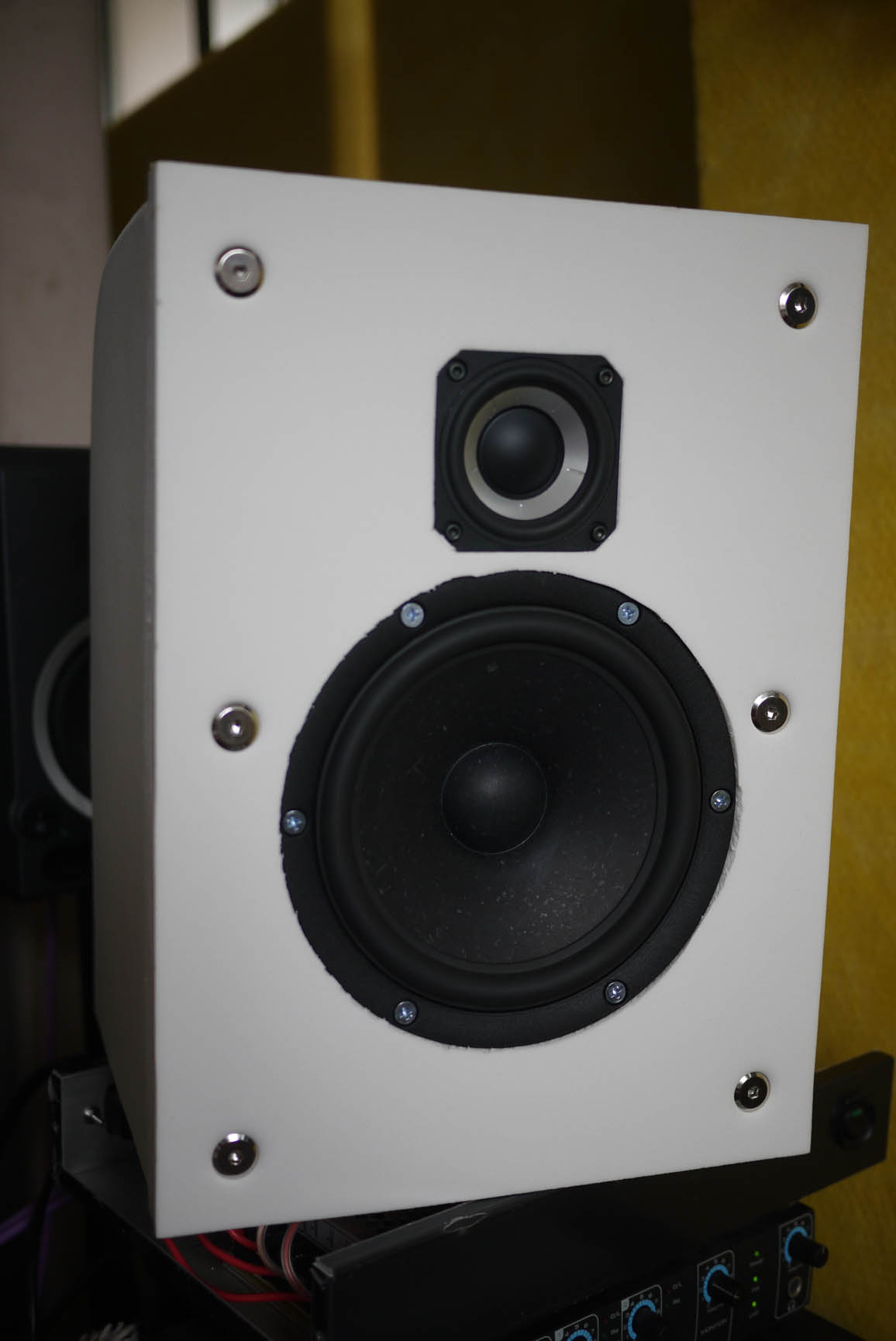

The 10/8424 in the sealed box with just a quick-and-dirty piece of scrap EVA (not flush mounted) press-fit adapter just to get a first impression. And I DO LIKE IT
Nice! That SB65 looks just like a 1in aluminum dome tweeter! Do you have any measured XO plots for the SB65/Satori combo?
10F/8424 looks perfectly at home there.![]()

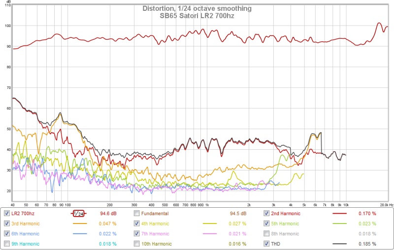

Yes I do have some plots but it is a bit complicated which I why I was trying to hold of a bit. The problem is that the Satori is so good that it is showing some of the limits of the SB65. But ok twist my arm, here are some
Measurements are at 25cm but I don't know the actual SPL level, something around my normal listening level. I was trying all sorts of crossovers from LR2 to Harsch and at many points (350hz, 450hz, 500hz, 700hz, 800hz, 900hz). I was changing XO and then listening to music and change, repeat....
At the end of that round I decided that the 700hz to 900hz sounded the best and gave the best measurements and I preferred the LR2 to the Harsch. But the SB65 seemed to have less dynamics than the RS28f dome tweeter. So even though it worked and produced a clean, high quality sound, it just could not quite reach to the level of the RS28f/satori.
Here is the LR2 700hz XO which is about the best I could get

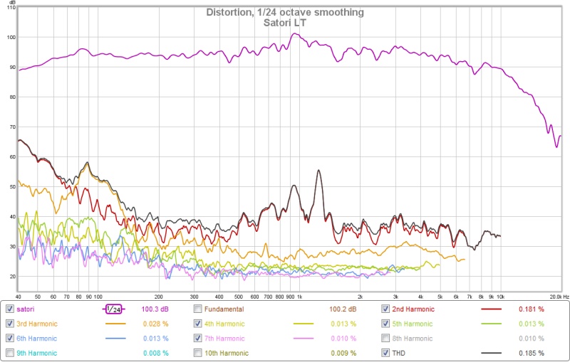

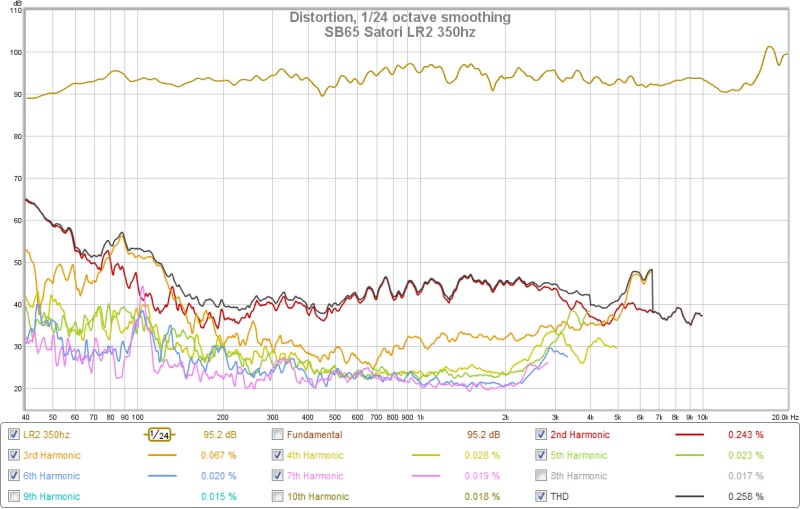

Here is LR2 350hz and you can see how much lower distortion the Satori is compared to the SB5. The distortion in the 350-700hz range is now higher than when the satori covered it.

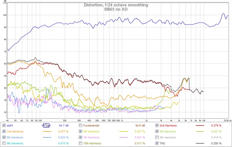

The only other measurements I have are the raw drivers before crossover to help me get a feeling for how they will blend. The satori has only the Linkwitz transform applied. It shows me where the Satori HD starts to rise and where it starts to get some breakup peaks. These are at 25cm but unknown DB and they are level matched. Basically the drivers as they are ready for XO but without XO.
Not sure what is happening with the extra distortion in the satori in the 500-1500hz range. My guess is that the two drivers are in the same box, the SB65 is not isolated in a separate sub-enclosure and I guess that the satori is causing resonance in the SB65. I don't see this with the RS28f/Satori combo. If I would want to go further I would need to build this sub-enclosure. But his would only improve the HD, it wouldn't improve the dynamics problem. And with a 700hz XO I am kind of avoiding this trouble region. Yes I know this is not the best-practice build, but I just wanted to explore.

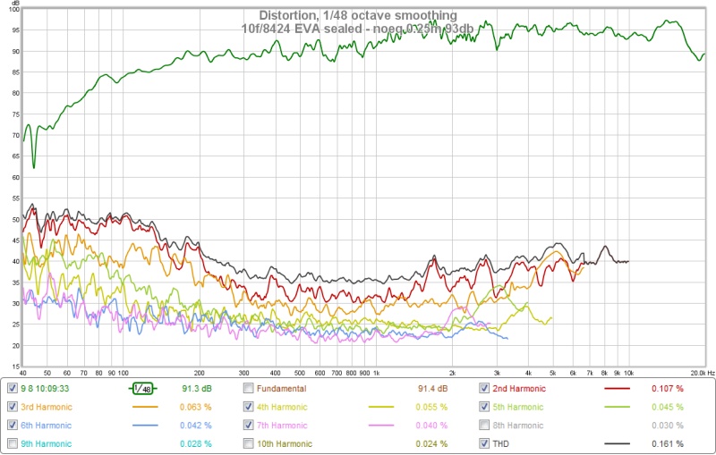

here is my first measurement of the 10f/8424 in the sealed EVA box at 25cm 93db. This is about my normal listening level (but of course I don't listen that close to the speaker).

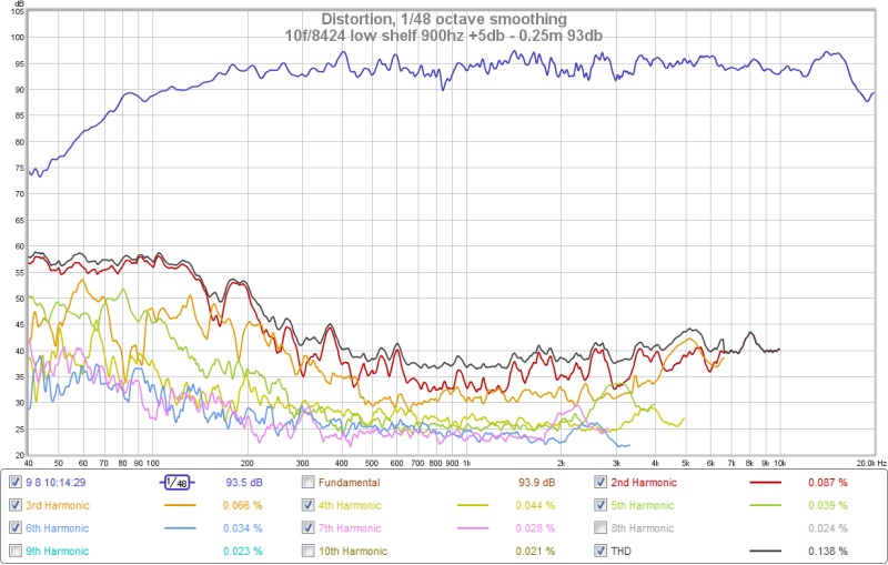

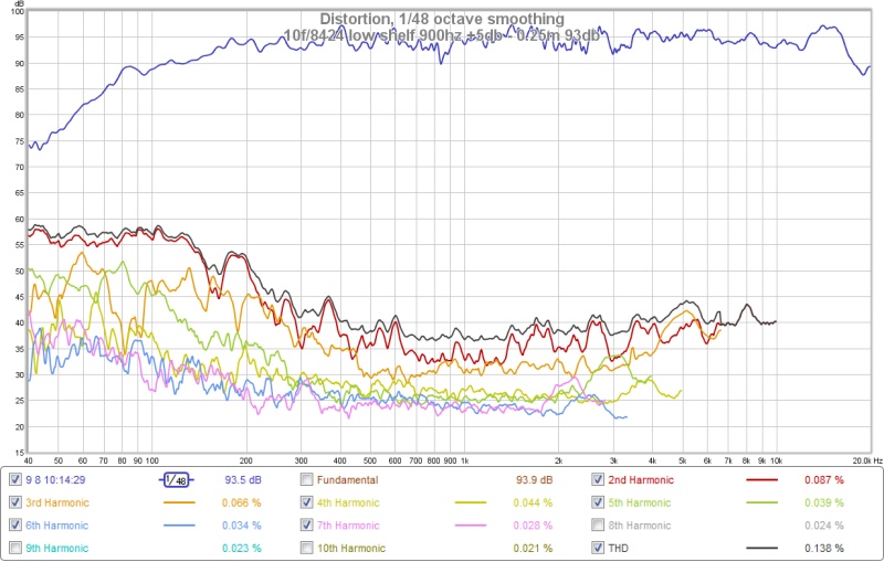

and here is with a simple low shelf at 900hz +5db q0.7. SPL meter read ~94.5db after this correction.

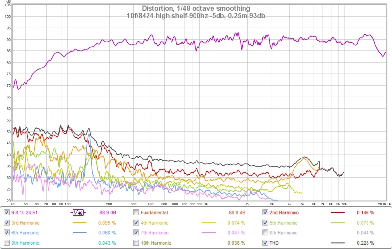

and the inverse, a high shelf at 900hz -5db q0.7 (SPL meter read 90db after this correction)
This driver is SO easy to work with! Really doesn't need any EQ correction (just a baffle-step-correction or LT) and it sounds very clean and detailed. This one really might be able to go head to head with the rs28f/satori (just first impression crush though)...but let's see after I live with them for awhile
![502850d1441674715-eva-foam-performance-speaker-enclosures-10f-8424-0.25m-93db.jpg](https://www.diyaudio.com/forums/attachments/full-range/502850d1441674715-eva-foam-performance-speaker-enclosures-10f-8424-0.25m-93db.jpg)
![502852d1441675322-eva-foam-performance-speaker-enclosures-10f-8424-lowshelf-0.25m-93db-v2.jpg](https://www.diyaudio.com/forums/attachments/full-range/502852d1441675322-eva-foam-performance-speaker-enclosures-10f-8424-lowshelf-0.25m-93db-v2.jpg)
![502853d1441675707-eva-foam-performance-speaker-enclosures-10f-8424-high-shelf-0.25m-93db.jpg](https://www.diyaudio.com/forums/attachments/full-range/502853d1441675707-eva-foam-performance-speaker-enclosures-10f-8424-high-shelf-0.25m-93db.jpg)
by the way this is louder than the level I was running the SB65 at and it is showing lower distortion and is much more dynamic and punchy. And the 10f still has a lot of headroom on the amplifier. The SB65 was running at almost full power on my TPA3116 while the 10f/8424 is running at -12db input gain to get to this SPL. OK I am impressed.

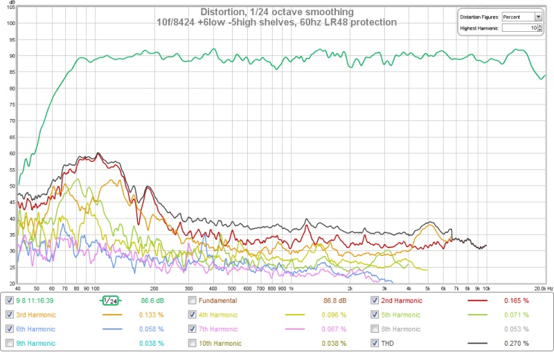

OK one more 10f/8424 EQ.
Low shelf 160hz +6db q0.7
high shelf 900hz -5db q0.7
LR48 HP 60hz for protection
I really think stretching this to 80hz is about the max I feel comfortable with.
WOW this sounds so good!!!!! Listening to some deephouse club music (this track) which a full range should not do well, and it is sounding correct (no problems) and it is punchy, groovy, and super clean. This might become my driver for this sealed box

![502869d1441679091-eva-foam-performance-speaker-enclosures-10f-8424-v1-0.25m-93db.jpg](https://www.diyaudio.com/forums/attachments/full-range/502869d1441679091-eva-foam-performance-speaker-enclosures-10f-8424-v1-0.25m-93db.jpg)
