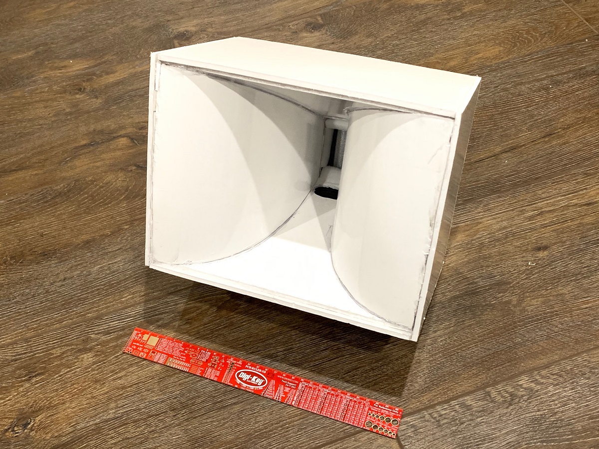

Put the RAAL in a waveguide! I mean for all the hype the ribbon isn't that happy below 3kHz. Hopefully with the WG loading, and necessary filter to achieve a flat response, it would allow it to cross lower and have a good directivity match with the Purifi.
The RAAL 70-20xr is supposed to be able to go down to 1600Hz according to factory data sheet. I agree a WG would be the cat’s meow but would require me to design one and 3D print it. I have made a foam core tractrix for it and had some issues with cancellation dips due to the sharp 90deg sidewalls. I suspect a shallow angle WG would be less likely to have those problems.

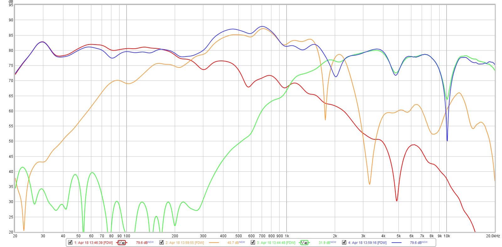

Here is a quick attempt at 3 way with parallel sealed RS225-8 woofers and dual (highly attenuated) 3FE22-8 mids at injection ports.
835358d1587233761-nano-trynergy-compact-tractrix-raal-ribbon-source-horn-raal-trynergy-0-5m-trial-xo-fun-jpg

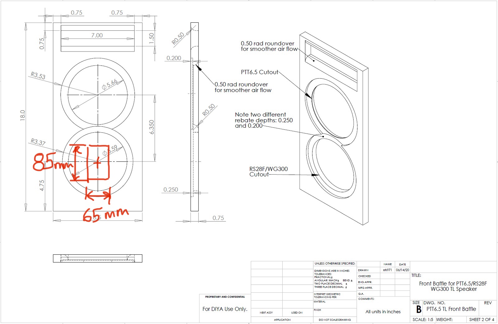

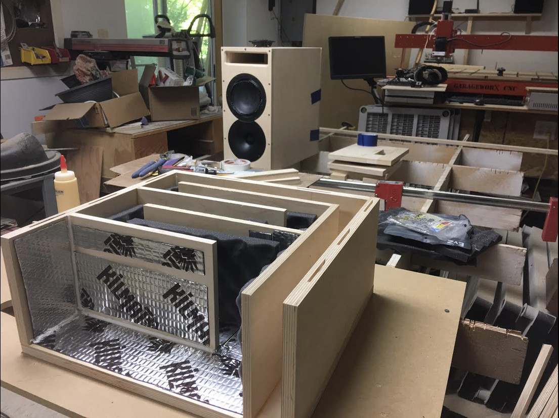

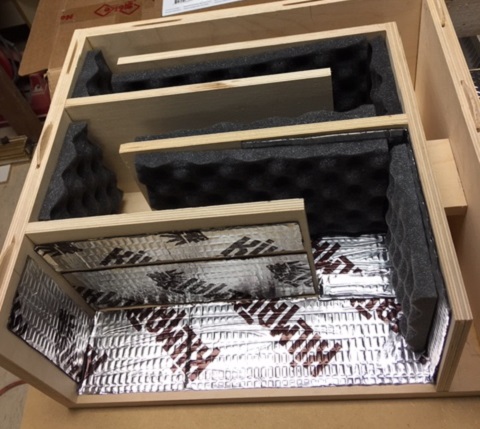

That’s 3/4in BB plywood on exterior panels and 1/2in BB on interior walls. The templates for routing the holes was made of MDF - so that may have caused some confusion. I have a super experienced cabinet maker doing these for me as I don’t have a wood shop nor the skills to make fine joints like this. He tells me they will be delivered tomorrow in the PM. I will still need to install final stuffing, crossovers, and general buttoning up. Will be using square drive socket cap screws to secure the baffle. Should look great.
Here is a template:
855669d1593116129-simple-passive-harsch-xo-using-ptt6-5-rs28f-waveguide-ptt6-5-tl-build-progress-09-jpg
