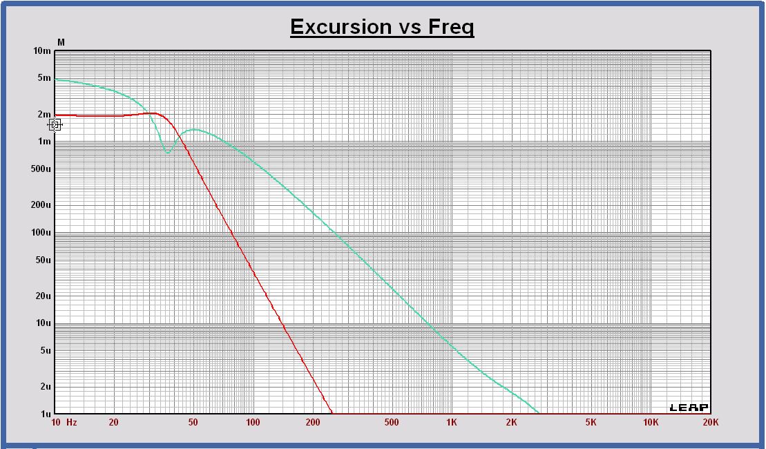

I can't find where XRK did the SIMs on excursion limit vs frequency, but for the HT case where you potentially need high level bass in the 20-60Hz region is there an argument for a slightly early roll off to increase power handling capacity?
I don't know what you mean by the HT case, maybe I have missed something, but if this question is adressed to me, this is the plot of the excursion for the 2-way monitor of the active driver (green) and of one passive radiator (red) at 2.83Vrms. Using this curve, it can be calculated at which SPL level the maximum excursion of 15 mm peak is reached for the passive radiator above 38 Hz for this design.
Of course you can play louder if a more early SPL roll off for low frequencies is applied. But the sound timbre will be different also.

If you calibrate home theater to THX levels that is 85dBA at the listening position per speaker for a -20dBFS level. This needs a LOT of bass. Most of us realistically are closer to the THX domestic spec of 75dBA. LFE channel is 10dB higher, so I've answered my own question, which is that the is fine for music but the sub is necessary for a good home cinema experience (if by good you mean your kidneys are liquified).
With the 3-way I have in mind, with 2 x 6.5 inch Purifi active drivers and 4 passive radiators on the side walls, the SPL at maximum excursion can become 104 dB at 1m. Indeed, for high power low frequency response, you better choose subs with larger drivers.
