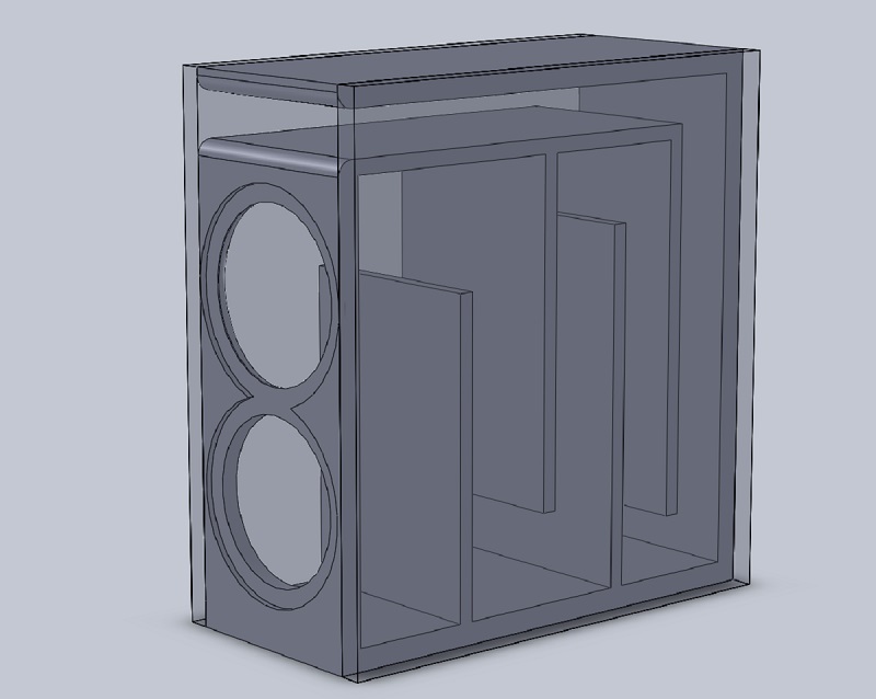

I have a question , I have 4 Purify Drivers and am not sure of the best way to use them - does anyone have suggestions for a design..... ?
..... Or another way to approach this, if you had 4 drivers , how would you use them, what would you build??
If you post the specs, I can use hornresp and come up with a TL. I am currently building a pair of TL's with 2 Peerless 6.5"HDS each. Next project after that is 2 x Dayton RS225-8 per line.
Hi Xrk, thanks for the input... if you can find a TL design , will it work for the two drivers or does it need to be designed for the dual divers?
You could take my existing TL, unfold it to a tall floorstander (maybe 1 turn) and double channel depth. That would work, although it’s a pretty straightforward design to run a simulation. As it’s a single 180deg hairpin turn.
So imaging this box unfolded and tall with the woofer facing front and back about 32in high woofer axis and box 40in tall. Tweeter in waveguide below woofer using passive Harsch XO of course.
