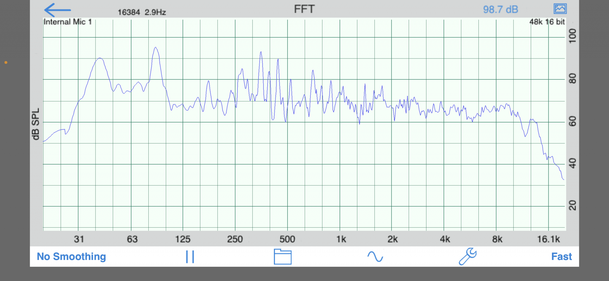

I just got back from Ministry Of Sound Classical concert last night. MOS is a big brand these days and you can say what you want about their DJ roster, commercialisation of dance music, but the original club in London was famous because of its state of the art sound system. unlike most clubs that was about places to see, who to rub shoulders with; MOS was for the punters, the state of the sound system was first and foremost the priority; the visual effects second and everything else a distant third.
As a speaker nerd I measured what I got from my boring VIP seated position that my spouse wanted to stay at. The line arrays gave 100+ dynamic peaks at 50m away.
i come back to my living room the next day and my quad 12 woofers aren’t enough…
