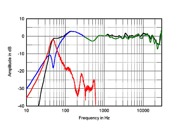

correct. below the tuning the woofer and PR are getting out of phase so forces are more like reinforcing rather than cancelling. There might be a frequency range where there is a bit of cancellation but it is for sure not wide band. The net force can of course be calculated and plotted with a bit of math/physics. The side mounted PRs cancel forces from a simple symmetry considerationNot a stupid question at all. Recall in bass systems using vents or PRs the woofer(s) provide most of the output, until the tuning frequency. At that frequency where the box is tuned the ports or PRs take over and provide the sonic output. At the exact tuning frequency the pressure of the air in resonance holds the woofer almost still while the PRs (or air in vent tube) experience maximum excursion. The graph below is the Stereophile measurements of the GoldenEar BRX also a woofer + PRs system. The blue trace is the woofer output, red trace the PRs outputs. Notice just below 50 Hz woofer output drops while PR outputs peak. Black trace is where they sum to yield the combined system output.
Thus with woofer on front and PRs rear configuration they are not acting in anti-phase therefore minimal cancellation of Newtonian forces.

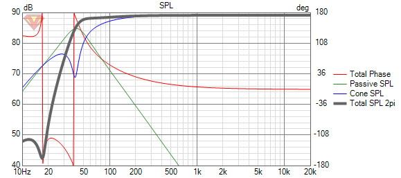

Similar figure in Vituix with 2x Purifi PRs, 12L volume. Between 30Hz to 150Hz there's a clear in-phase PR component that adds up to the main driver SPL. There's an out of phase component as well that will contribute to the cabinet "rocking" if PRs are rear mounted. Tried to figure out the out of phase energy component via LTSpice that is not cancelled out, does not seem like much yet not sure I got it right though.
The Newton forces are simply mass times acceleration for each driver (and hence goes to zero towards 0Hz). At the tuning frequency the PR’s do most of the SPL, ie they have most of the acceleration whilst the active driver excursion is at minimum. since the PRs are much heavier than then active driver they produce much stronger forces than the active driver for the same SPL (eg if the driver was in a sealed box). Having two PRs instead of one quadruples the total mass needed to keep the tuning frequency whilst area doubles. That doubles the Newton force for the same SPL. The least force is obtained using a port (small area low mass high excursion). But even a port gives Newton forces - although it is a bit mind twisting to imagine
