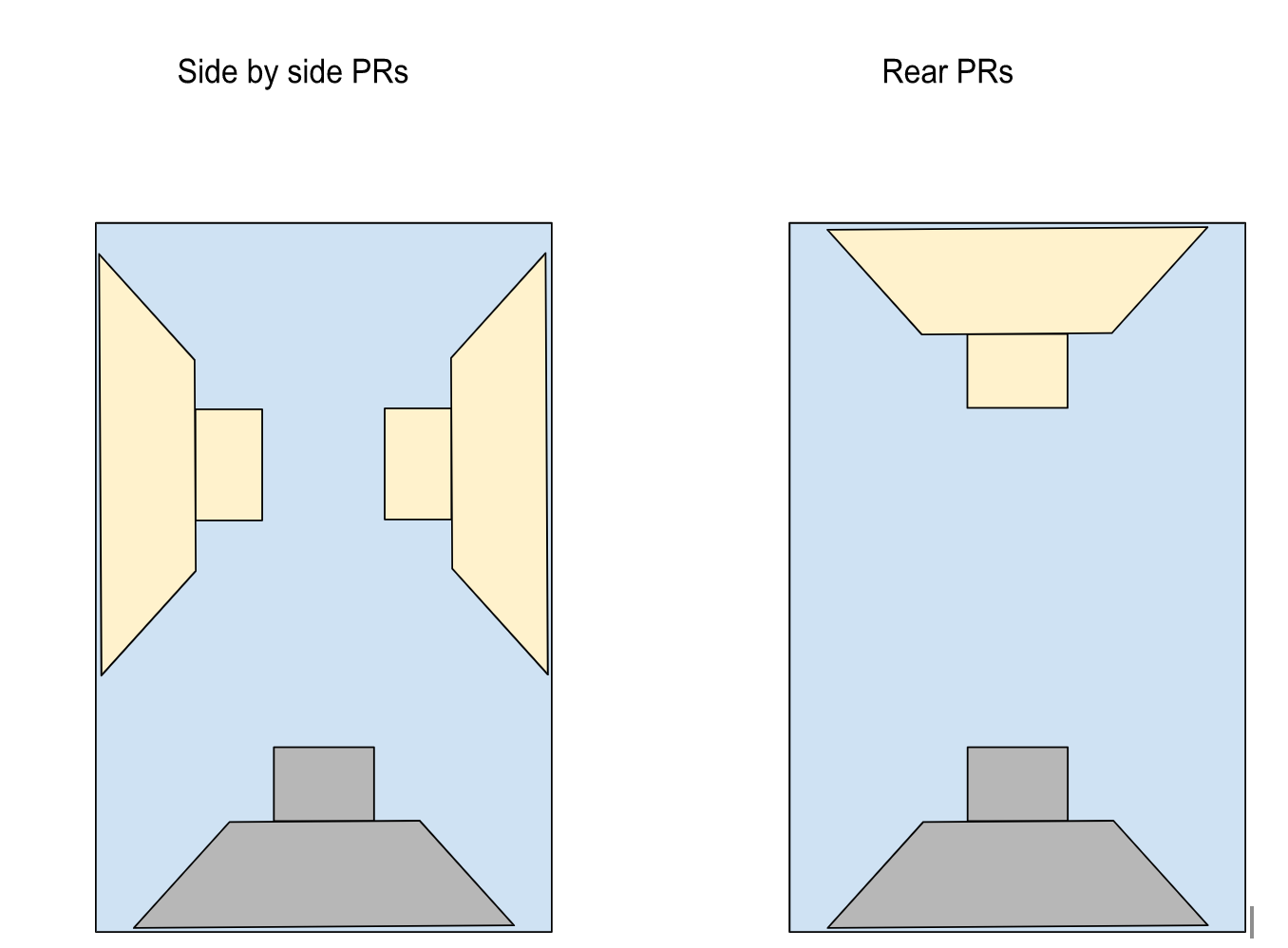

How close is too close? I'm about to do the cut-offs in a 15L Lenovo pack tweaking a Directiva R1 with Purifi PRs and stuff the bottom reducing volume to 12~13L. The cabinet is not too deep, certainly less deep than Evgenyi's Puriwave. Side mounted PRs will be closer to the drive than other designs and that might raise the issue of midrange leakage.The other thing to be mindful of, is the proximity of the passive radiators to the active one. Midrange leakage through the PR cone is a real phenomenon, and If using dual PR I’d try to keep them as far away from the active driver as possible.

I assume rear mount will also get a share of the (more directional) midrange. The drawing is almost to scale, to convey the ratios. What is the recommendation in this case, side or rear PRs ?
Thanks for the patience

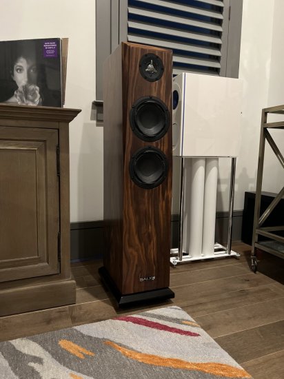

Commerical offering the BePure 2 by Salk Signature Sound
https://www.audiocircle.com/index.php?topic=182516.0
https://www.salksound.com/model.php?model=BePure+2

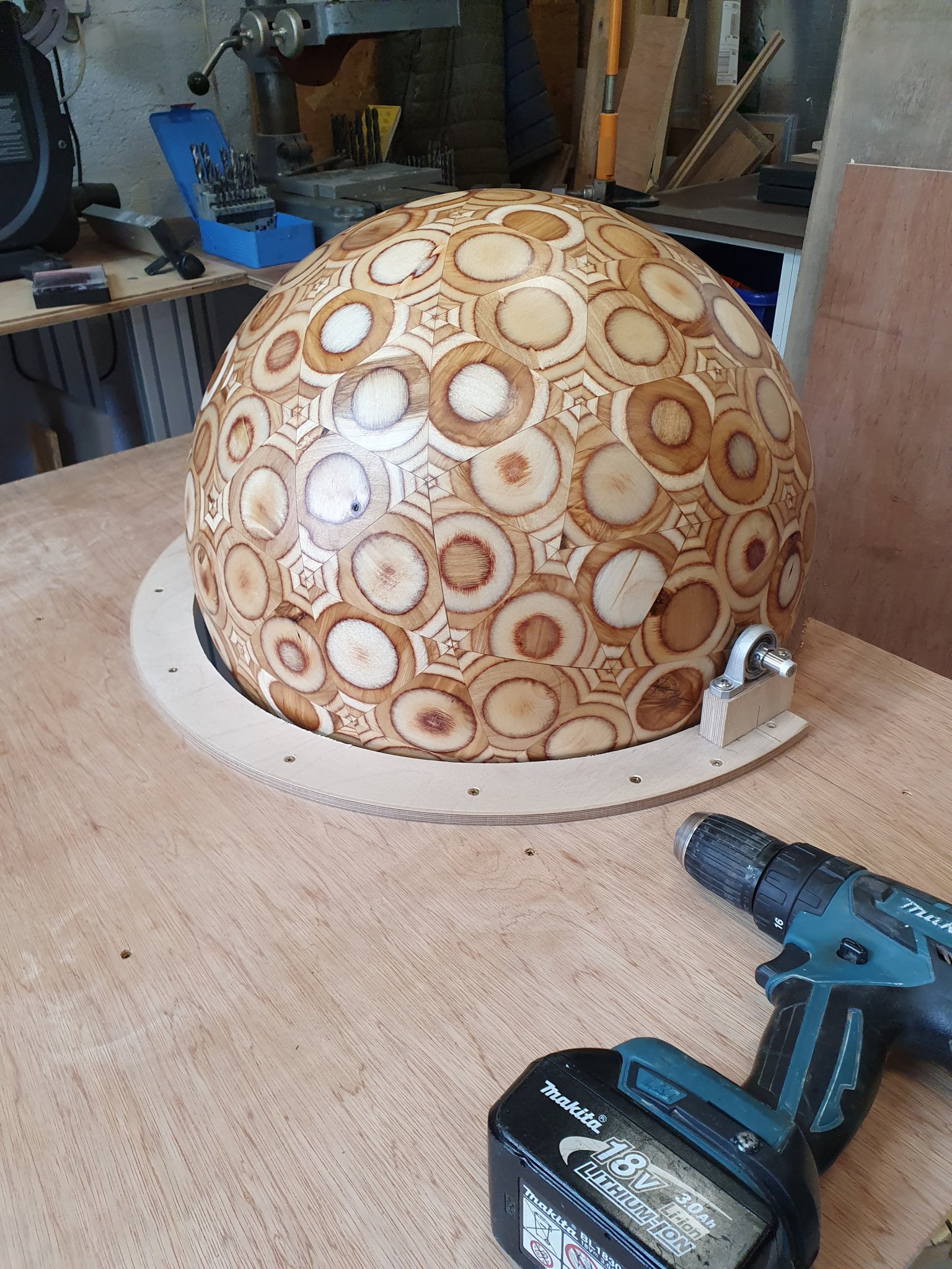

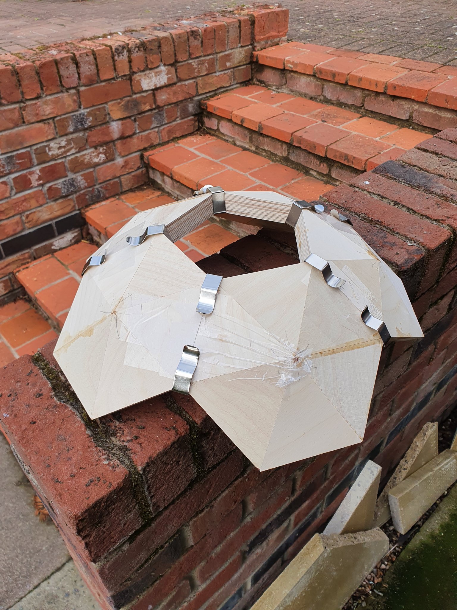

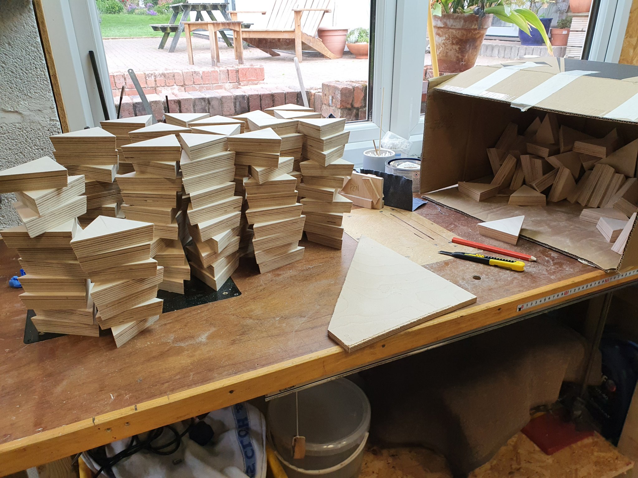

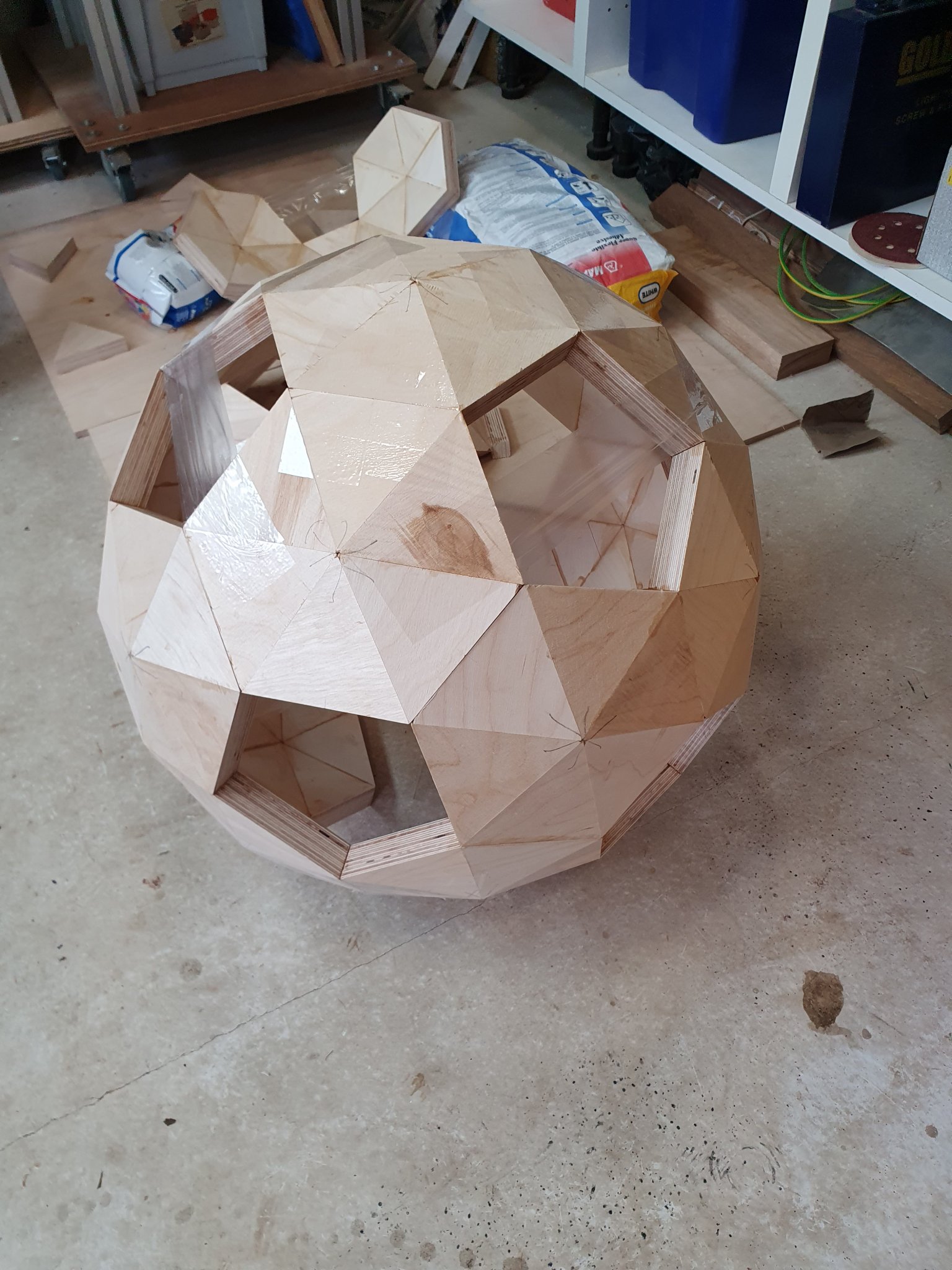

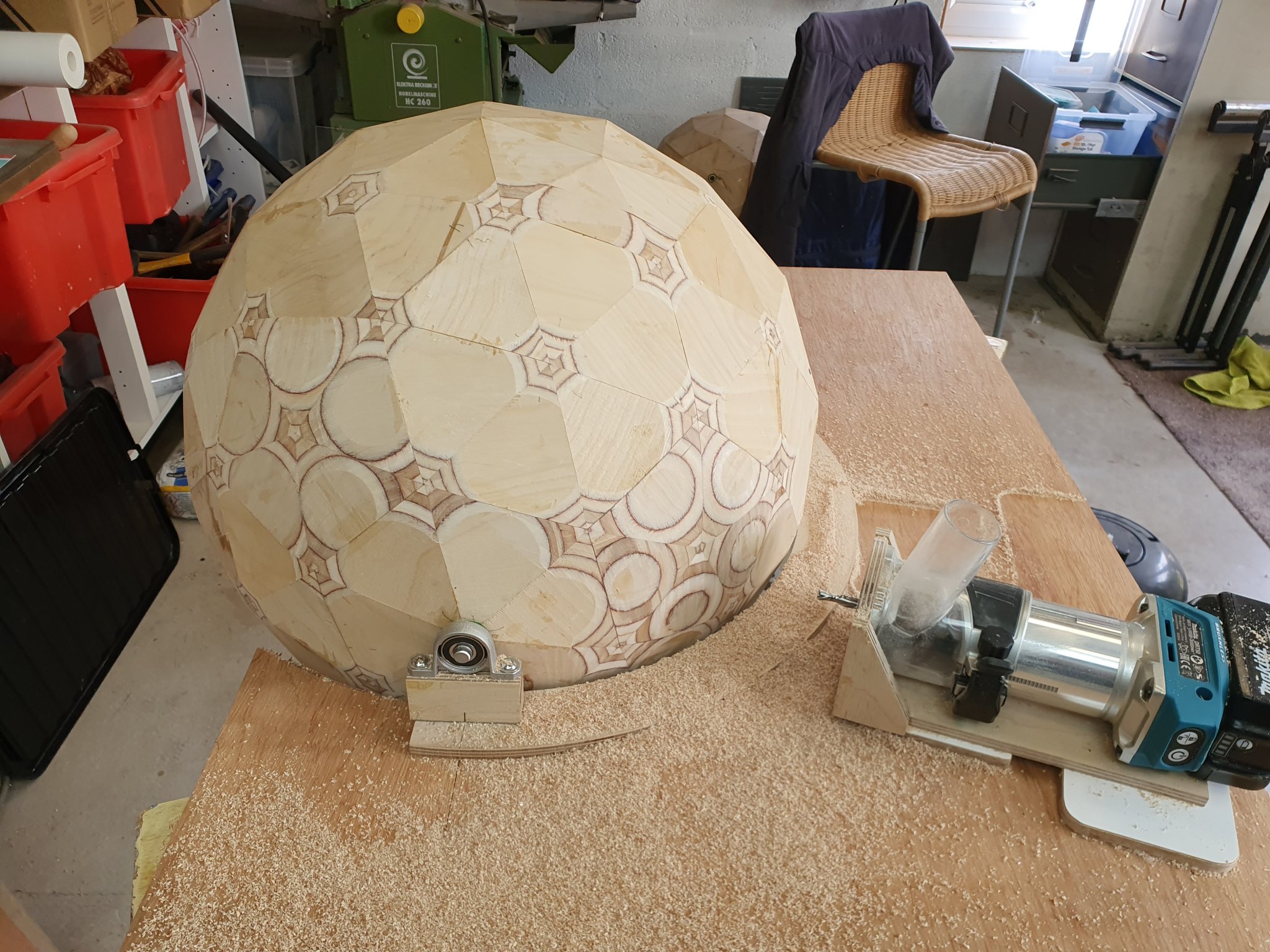

I wondered if you had any info regarding where you would consider the acoustic centre of your 8" driver (or any of your drivers for that matter) is in relation to the mounting face, I am not sure if this varies with frequency but an approximate distance at useable crossover frequencies would be useful to builders.
My active build is coming along slowly, 24db LR crossover and four way Purifi amps are ready, the spherical bass cabs part done (45l volume will be reduce with a smaller sphere offset internally so I can play around with final volume and reduce standing waves)
My Viawave tweeters will be mounted in a close coupled pod and hopefully set back to align the acoustic centres.
The final crossover frequency will probably be 2k2 but will depend on the 8 ohm driver specs (any update available?)
Cheers Steve
Cheers Steve
spresto9 adding my complements to the Birchply spheres. Birchply is my longtime favorite material for woodworking and resulting speaker boxes with exposed layers a preferred look. That is taken to its perhaps ultimate expression in such spheres. Brovo.
I would consider just how powerful the motors are in Purifi drivers and interior box pressures that result. I suggest sealing your spheres with epoxy or something similar based on my experiences with much simpler butt joints.
PTT6.5W04 and the evil twins PTT6.5PR want to explode your speaker box
https://www.diyaudio.com/community/...er-speaker-builds.352063/page-24#post-6383932X2.Great wood working.
The sphere looks beautiful.
I can only dream of making something that nice.
Thank you for the compliments, I'm several months from finished yet, the sphere construction came from the web and the initial accuracy of the triangles came from the cnc shop, me cutting them in my workshop would have led to too many accumulated errors!X2.
Steve
Cheers Steve
Hello Steve,
you won't reduce standing waves with spherical cabinet. You can't reduce standing waves with geometry.
You only shift frequencies depending on geometry.
You will always have standing waves no matter the geometry.
https://www.acculution.com/single-post/037-misconceptions-in-acoustics
Nice built though!

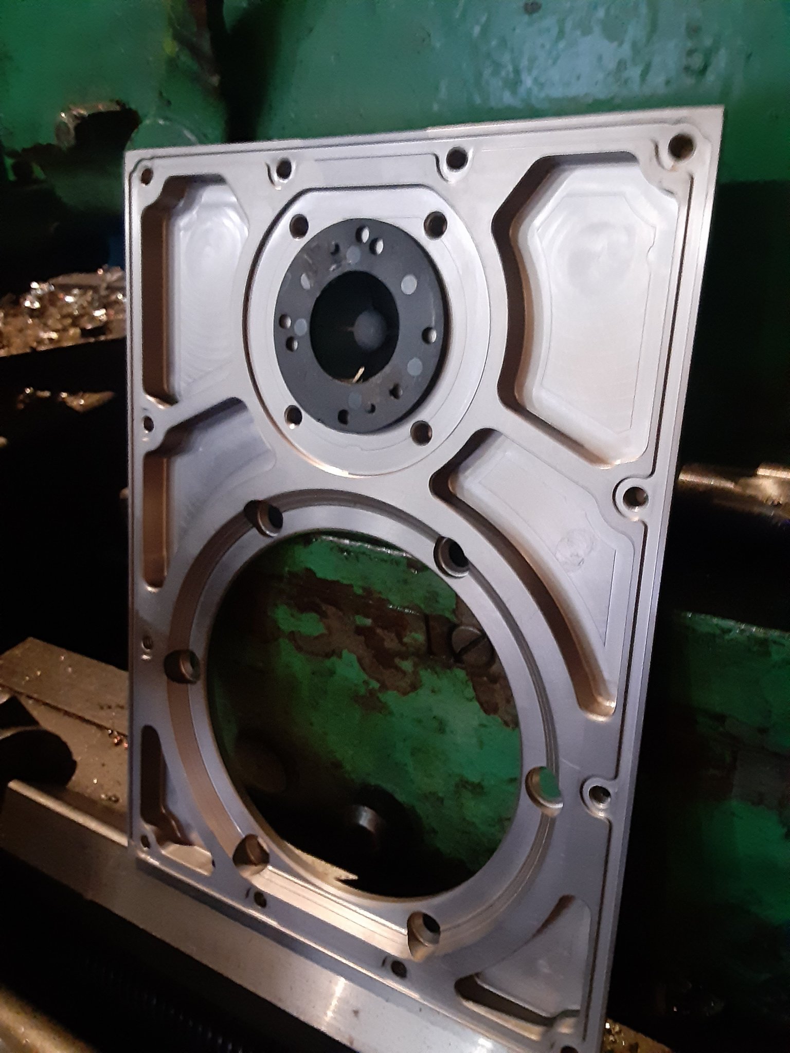

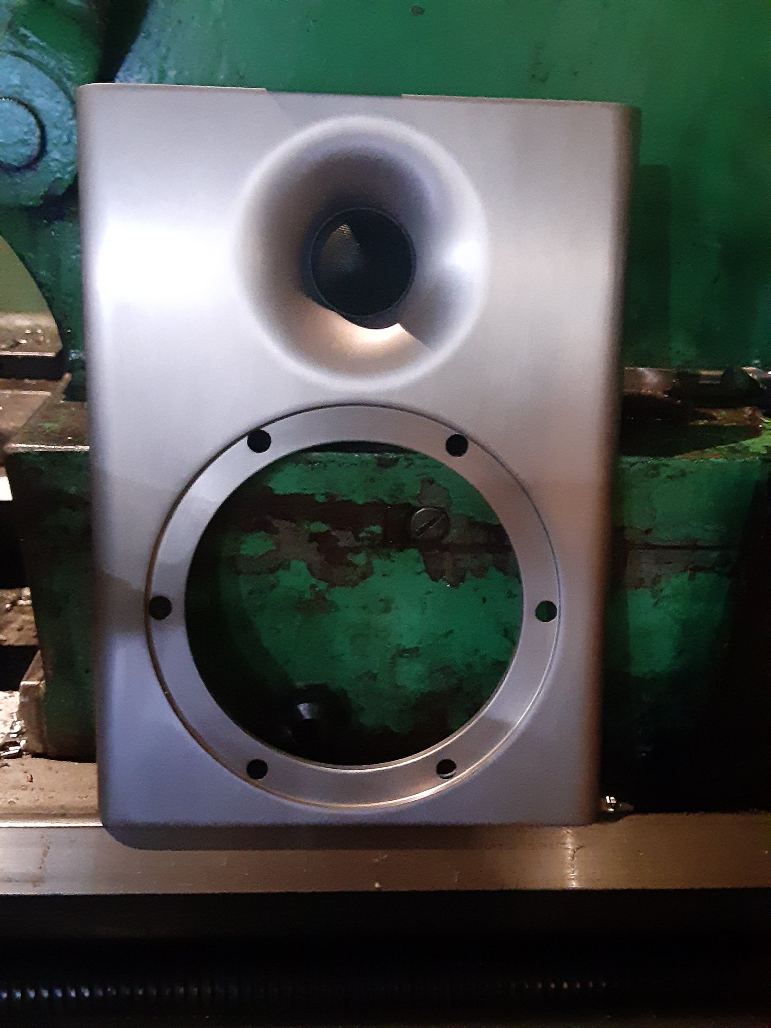

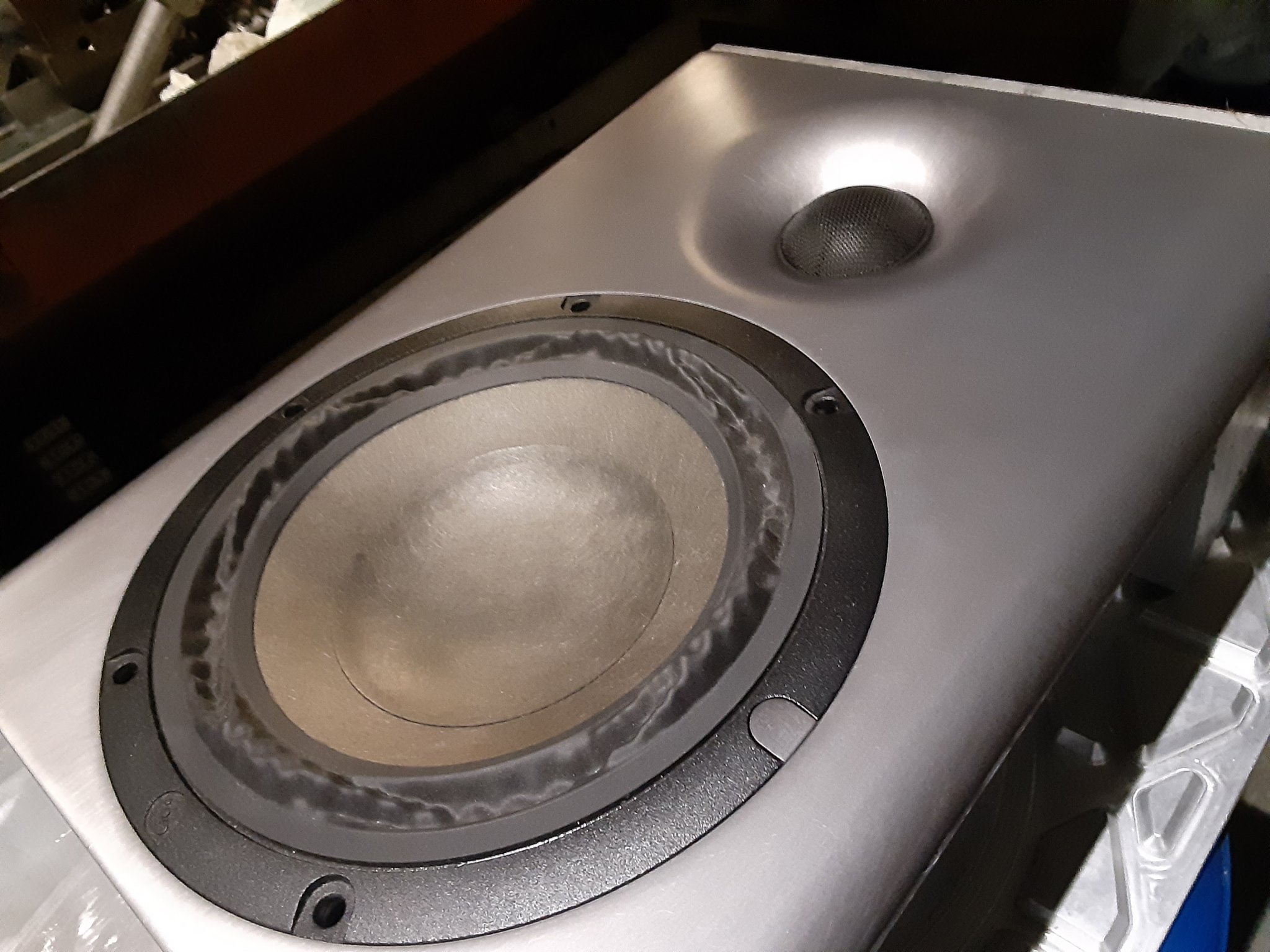

Anyone looking for aluminum baffles? I'm working out a process for making custom baffles and the first go was to make one for the six inch Purifi with waveguide. The main tweaks I'm planning are some minor changes to the rear panel seal geometry and some faster machining strategies. Dialing in the anodize procedure is the other main objective. Note the exaggerated mounting holes; on the rear side they have a deep well chamfer and the idea is to have custom chamfered nuts with a rubber gasket seal. So the mounting bolts don't contact the baffle, and because the driver is essentially free floating the chamfered nut geometry actually handles the centering problem. Dunno whether it's a good or bad design feature, but making tweaks on the overall design is a fairly negligible fix.
I'm thinking I can do em from about 400-1200$ per pair depending of the level of finish. Also working on the flush mount bolts specific to Purifi, as can be seen in one of the mounting holes. So I was thinking to do a baffle plus hardware package for convenience. This was just a proof of concept so if there is any need for this sort of work give me a shout.
