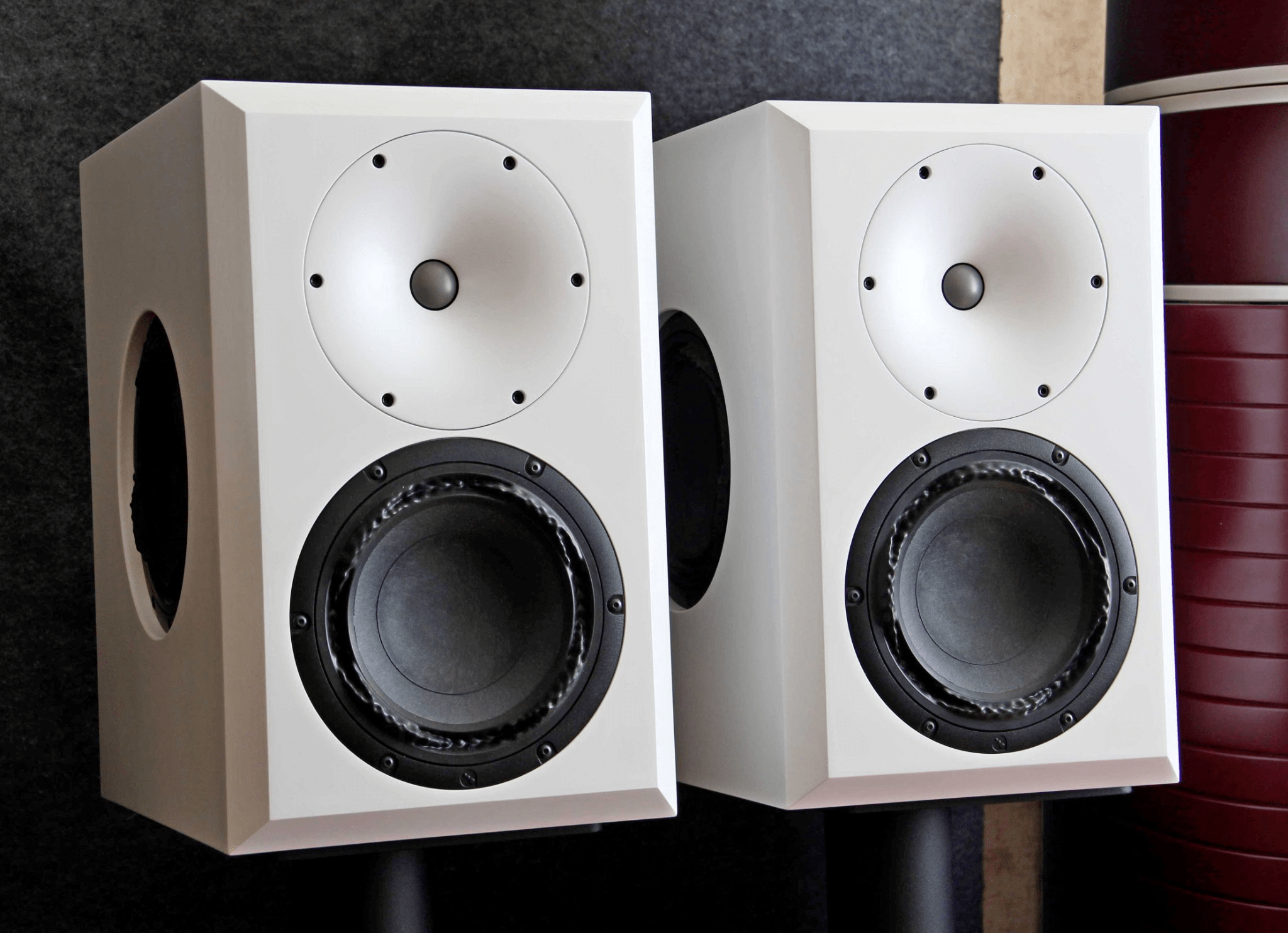

Great , I am looking a similar one for my design . Can you please PM to connect ?Anyone looking for aluminum baffles? I'm working out a process for making custom baffles and the first go was to make one for the six inch Purifi with waveguide. The main tweaks I'm planning are some minor changes to the rear panel seal geometry and some faster machining strategies. Dialing in the anodize procedure is the other main objective. Note the exaggerated mounting holes; on the rear side they have a deep well chamfer and the idea is to have custom chamfered nuts with a rubber gasket seal. So the mounting bolts don't contact the baffle, and because the driver is essentially free floating the chamfered nut geometry actually handles the centering problem. Dunno whether it's a good or bad design feature, but making tweaks on the overall design is a fairly negligible fix.
I'm thinking I can do em from about 400-1200$ per pair depending of the level of finish. Also working on the flush mount bolts specific to Purifi, as can be seen in one of the mounting holes. So I was thinking to do a baffle plus hardware package for convenience. This was just a proof of concept so if there is any need for this sort of work give me a shout.

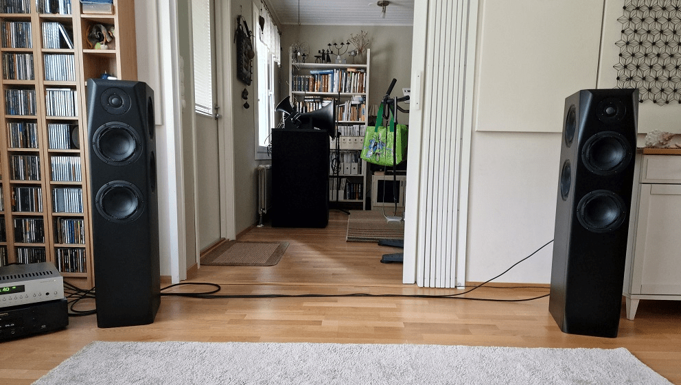

And gee, look at that!- a Purifi horn in the background?!
And paired with a rear/up firing on too!
And bass cabinet, probably full of large 12-18” Purifi woofers!!
How did you get exclusive access to them?
Yes, folks, you saw here it here first- more Purifi’ed goodies are on the way!

It's KS-1804 mkII. BMS drivers; 2x18" woofers in resistance enclosure + coaxial 4590 for horn.And gee, look at that!- a Purifi horn in the background?!

Along with the most widespread usage of trainer cycle handlebars, shopping bag hangers 😂No 4" Purifi Build
