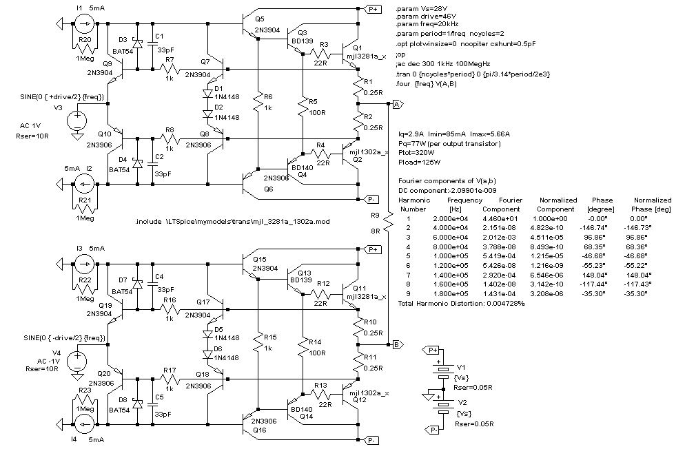

Oh well, this really looks like a very good amp. By coincidence, I'm a fan of bridged class A (for its lack of GND and PSU load signal currents) as well as that "constant voltage drop across Re"-autobias feedback loop, as I plan to design a somewhat similar amp concept currently (simming stage, so far, see my crude&silly aproach here (and in some follow-ups).
WRT to the ExtremA's schematic, isn't there one very important live saver connection missing in the output stage?
- Klaus
Joined 2005
Klaus,
As I've personally drawn these schematics and many amps have been built from them, to the exacting performance figures as published, I'm afraid I'm at a loss what that connection might be?
Sander Sassen
http://www.hardwareanalysis.com
Hi Sanders,
I meant a connection from the output to the tap in between the diodes, so the overcurrent protection senses the individual drop across the Re's, not only total drop. I simmed it, not the same trannys but comparable ones, and I found short circuit currents to skyrocket without that connection -- would blow the fuses. Couldn't see any degradation in open-loop THD with the wire, also no change in the clamping action when one of the currents goes opposite polarity. So I assume that connection would be "legal".
EDIT: could be fine tuned with a series R (~47R) instead of the wire to allow more or less of class-B mode operation during high current peaks. Was that class-B "fallback" region a consideration?
- Klaus
Joined 2005
Klaus,
The only condition where I can see this be a problem is when the amplifier is fed with DC rather than AC, otherwise the overcurrent protection is just working as intended. However if you set the bias current higher, the maximum peak current will be higher as well, which can result in the fuses being tripped prior to the overcurrent protection engaging.
No, class-B was never a consideration, it merely works in class-B when pushed beyond the class-A limits because another mechanism kicks in, which is partly due to the fact that the first stage has more output swing than the output stage itself. THD will see a (very) substantial rise when the amp is pushed into class-B operation.
Sander Sassen
Thanks for the explanations, Sander.
I now found out that it was a simming error, I didn't do the full bridge :)ashamed: lazy guy that I am) and just set RL to half its value, connected to GND.
Now, as a full bridge, everything works as described (still I have to look why it doesn't in non-bridged mode), so forget about my objection. OTOH, maybe it is still a point when an output shorts to GND (and if there is a low resistance current path from GND to the rails -- looks like that being the case in your PSU).
EDIT: looks like the servo in the frontend takes care of that...
I'm already fiddling with the stage (in the simulator) to optimize it for being used without global feedback. Cascoding looks promising, and I changed the biasing to be useful with lower emitter resistors... quite promising.
Do you mind if I present some simulation results of your output stage here (plus some tweaking ideas)?
Regards, Klaus
extremA output stage (simulations)
Ok, here the basic sim (no reactive parasitics).
Distortion values are "close to spectacular", at 20KHz full power (very close to A/B transition and reaching low Vce) only 50ppm, delivering 125W at 320W total power consumption.
Klaus

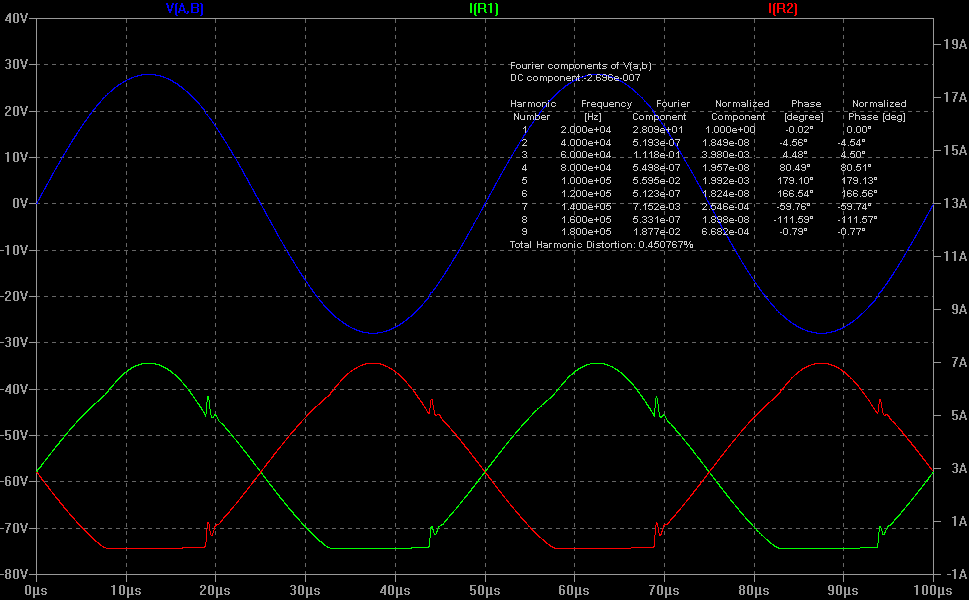

Overcurrent protection.
I found out what was wrong: I simmed with unlimited drive current, that defeated the limiter. I plotted current emitter currents of the output (R1), bias (Q9) and limiter (D1) trannys vs. source impedance (to mimick current limited drive) and then everything is OK.
- Klaus
