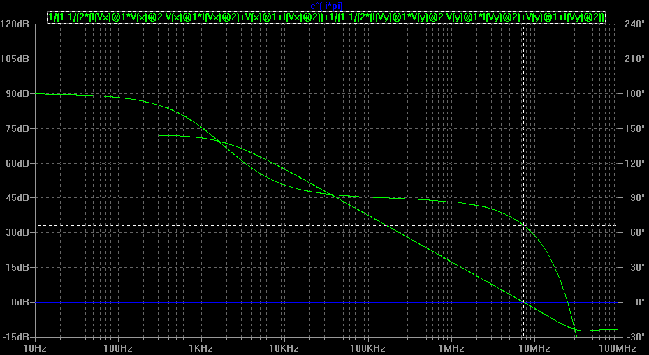

Find attached the Aol bode plot (no load), again seems to fit well. Textbook perfect 60deg+ phase margin with Cc=33pF... but it will oscillate with CL=7nF, that's the point where it starts in the .tran and then I see 0 deg margin, so I broke the loops at the right point. Was a little tricky, because of the parallel loops. I had to tweak Cc balance a little -- PNP side -20% -- to get rid of a ripple in the phase.
I'm sick today and have a day off, could't sleep the whole night... and have a bag full of tweaking ideas:
- cascode the bias transistors to beef up gain and high-Z node impedance
- use laterals for outputs because they have more linear gm and spread the diff voltage needed for the casodes
- sense output current with a wheatstone bridge and use it for a little positive feedback to lower output impedance (could even be made adjustable, also with increased Rout for speakers designed for that)
- use double pole compensation and/or a detuned T network to stabilize the excess gain
(some of that I did quicktest already)

Klaus,
BTW, are there models for the Sanken RET's around?
No, or at least I have yet to find them, I used different libs and edited them a little to get close, I think OrCad libs came the closest. The output stage was then subsequently tested on the bench and final values for the components were selected.

I'm sorry to hear that, but that of course means you can tinker with LTspice all day long 🙂
Obviously there is room for improvement still. But we set out to reach a certain performance, and when we comfortably reached that level we did not bother to optimize further. As-is the ExtremA provides THD levels that are a far cry from the vast majority of commercial amplifiers, but for Halcro, but those amplifiers come at a hefty pricetag.

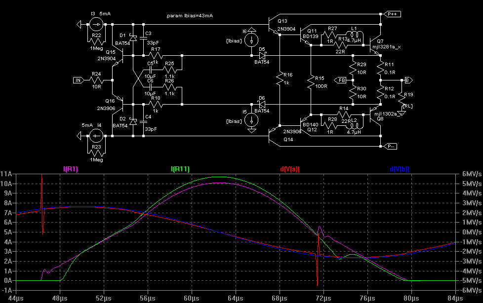

Some possible refinements to the ExtremA's output stage (simulations only, please take them as general ideas, not as well-proven practical tweaks for that particular amp! They aren't, nor do they seem to be neccesary for it anyway).
Starting with the minor things, I lowered the emitter resistors to 0.1R, so the output impedance is 2.5 times lower, 0.05 ohms vs. 0.125 ohms.This will also make the "gm halving" effects more benign when we enter class B. To compensate for the lower voltage drop accross them, I level shifted the sense voltages with a Schottky diode drop. This didn't destabilize the loop thermally, bias drops almost identically with temperature as in the original OPS, dominated by the gain transistor's Vbe drop. The current sources allow fine-trim of bias/offset but have to be of very good quality, as the diode drop is outside the loop. Alternatively one could offset the emitter potentials of the gain transistors but I found that a bit too complex and little awkward.
Second, I added AF shunts accross the base stoppers, there is no need for a base resistance at frequencies which are way below the Hfe roll-off (where impedance transform of the output trannies starts) and below the resonances of any parasitic tank circuits. This improved linearity to some amount, maybe not worth the effort/risk.
But the most effective change was the addition of an error cross-feed network which I added after looking at the indiviual error terms and finding that they partly cancel when summed together. While it also improved linearity in class A a little bit, it had a (totally unexpected) dramatical influence of the distortion when A/B transitions occur. Improvements are on the order of 30dB (factor 30)! The value of 1.1k was empirically found and is a bit critical (better to be on the high side of it than on the low side). I couldn't find any tendency of instability due to that addition (not having simmed all possible load conditions, of course), the step response is practically identical, indicating similar stability margins. At a first glance it deemed necessary to double up the dominant pole compensation cap because the driving point AC resistance is now about half its original value, but investigation with the step response didn't confirm this. From a small signal standpoint there are two different feedback signals fed into the bases which might account for that somwhat unintuitive observation... there might be other reasons that I overlooked in my crude "student-level design analysis" (and as a proof for this, I didn't manage to get the loop gain probing to work, with the cross coupling).
With values adjusted so that with 4 ohms load the amp is just on the edge to class B mode (~200mA margin) I get the following THD20 results (half-bridge):
38ppm (old), 8ppm (new)
At 1/10th power (well inside class A margins):
3.5ppm (old), 0.5ppm (new)
Thus, improvements somewhere below a factor of ten, nothing to write home about (and considering it's all virtual anyway, as of yet).
Now, driving 3 ohms (thus about 1/4 period in class B mode), THD20:
0.3% (old), 0.013% (new)
2 ohms (running 11A peak, close to absolute current limit):
0.8% (old), 0.02% (new). This is a factor of 40 improvement. Using only this mod on the original OS also gives factors in the range of 10...20.
In the attached response I plotted output voltage slope (1st derivate), one can see that the crossover distortion is almost completely absent (red--old compared to blue--new), so the resulting distortion must come from gradual changes in the waveform, sporting only low order components and the .four output confirmed this, the original is dominated by H7 (probably the most offensive harmonic), my variation shows mainly H3. Further, in the graph I also plotted the currents through the upper emitter resistor, my version (green) shows a more benign waveform with less HF content/ringing (purple--old).
One last change is to tap off the feedback for the global loop not directly at the output but from a second averaging point between the output's emitters. This will place the ohmic output resistance outside of the loop, but as I'm not a friend of those extreme damping factors (usually rendered useless with cable and contact resistances), I feel a Zout of 0.1 ohms (bridged mode) should be low enough for the majority of speakers. The benefit of this is that the output current completely "disappears" from the main FB loop, it sees only that little error term (some ppm while in class A) which it may correct. So, the global loop merely sets the output voltage while the current is handled only by the local loop in the output stage. The individual tasks of the loops don't get mixed up, the global loop handles only the voltage, sets the gain and linearizes the front-end with the help of feedback, while the OS takes care of the current portion of the cake alone.
And the Zout is purely passive, so to say. This is not the same as to add some resistance to an output whose impedance is controlled/lowered by global feedback, the current term still enters the main loop, albeit to a lesser extent.
This surely is a matter of personal taste but somehow I feel that it might be of benefit if a global loop is freed from having to handle the (quasi non-correlated) current terms, since to apply a voltage at the output and then "fire-and-forget" about the current draw is IMHO what makes an ideal amplifier in the first place, after all (like non-FB designs do, at the cost of increased distortion). To my knowledge this also is an old and known concept, probably implemented in some comercial amps. With a very good OS one could even abandon overall feedback and could close the front-end loop just behind the VAS.
Regards, Klaus
