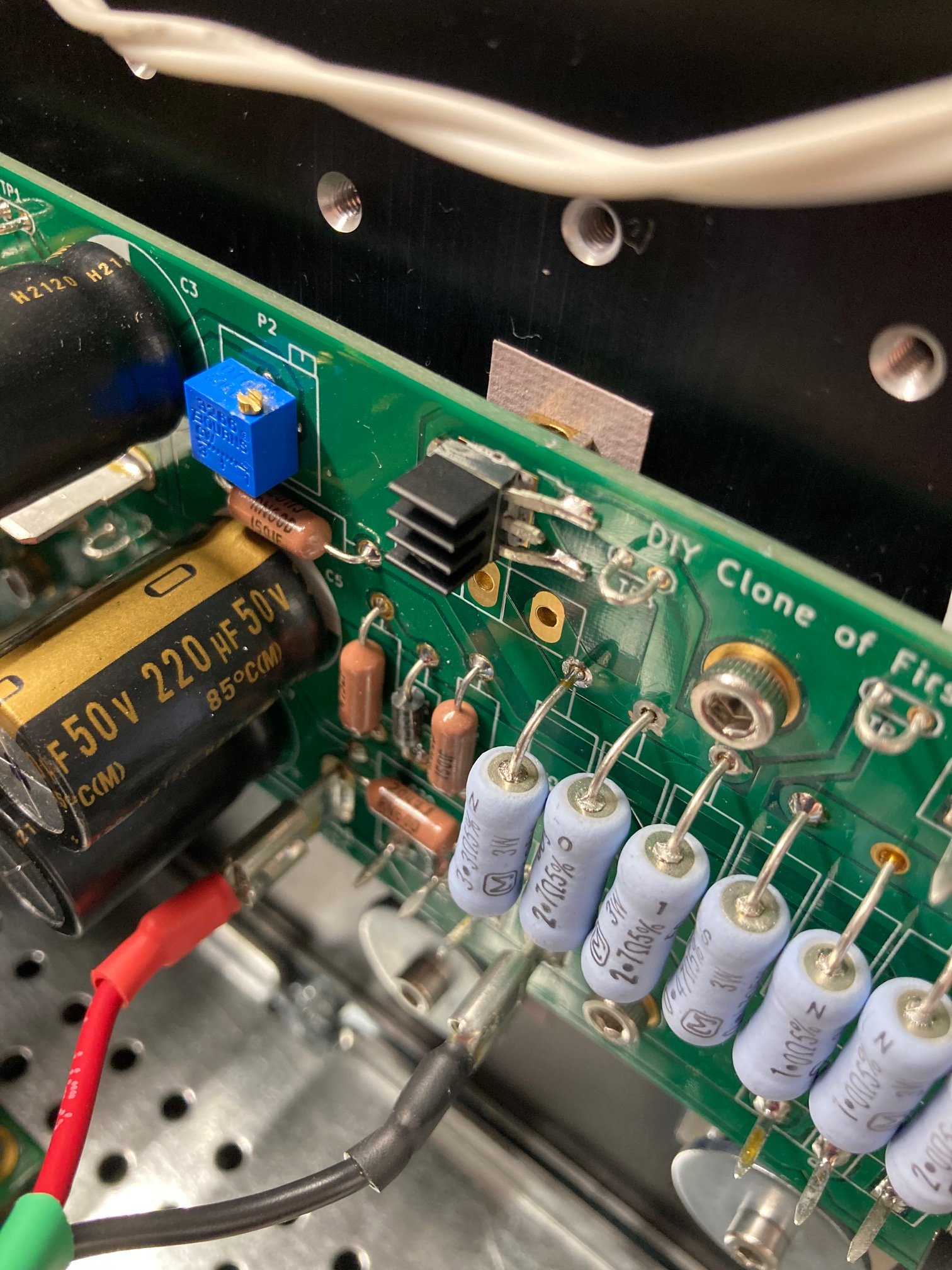

Yes. So I put some on my LUs as well with thermal adhesive tape, they're little and look like this.I used those little glue-on heatsinks for some CCS daughter boards in my Torpedo 3. They definitely help.
Before the stick-on heat sinks were there I was obsessively measuring the temperatures of the LUs during normal operation, playing music with the case open. They would routinely 'breathe' between about 47C and 61C case temps, measured with an IR temperature gun-thing, with the two channels not always at the same point in their temp cycles. Once I put on the little heat sinks, they were more consistently in the low to mid 60's. This seemed to be a paradox at first but if the increasing Rds(on) with increased temperature was self-limiting the bias, causing the 'breathing', then maybe the heat sinking decreases the magnitude of the temp swings? Anyway I think this was a good mod and I'm ready to put the lid on the case.

Ranshdow what voltage numbers did you end up getting I got 1v2,3v4,and 20v which is the closest I can get to 1v1,3v5, and 21v maybe my Lu’s got a little cooked soldering to the adapter and I need to change them out and just mount them to the heatsink with leg extensions to the board.
Before adding the little heat sinks, I got:Ranshdow what voltage numbers did you end up getting I got 1v2,3v4,and 20v which is the closest I can get to 1v1,3v5, and 21v maybe my Lu’s got a little cooked soldering to the adapter and I need to change them out and just mount them to the heatsink with leg extensions to the board.
LH board: TP1 21.23V, TP5 8V, TP4 3.51V, TP3 1.39V so Vds of 2.12V, on a device with a Vgs of -1.348 and a Vp of -1.77.
RH board: TP1 21.15V, TP5 8V, TP4 3.57V, TP3 1.37V so Vds of 2.2V, on a device with a Vgs of -1.353 and a Vp of -1.775.
Keep in mind this is after setting R3-R5 to 2R7, 2R7, and 3R3 for both channels.
I've suspected that these numbers might be related to the Vgs, which may be on the high side compared to the range mbrennwa reported for his LD1014D population in his GB. The ones for sale spanned from -1.375 down to -0.470 (!). Of course these devices were measured completely separately as part of the LU1014D group buy.
