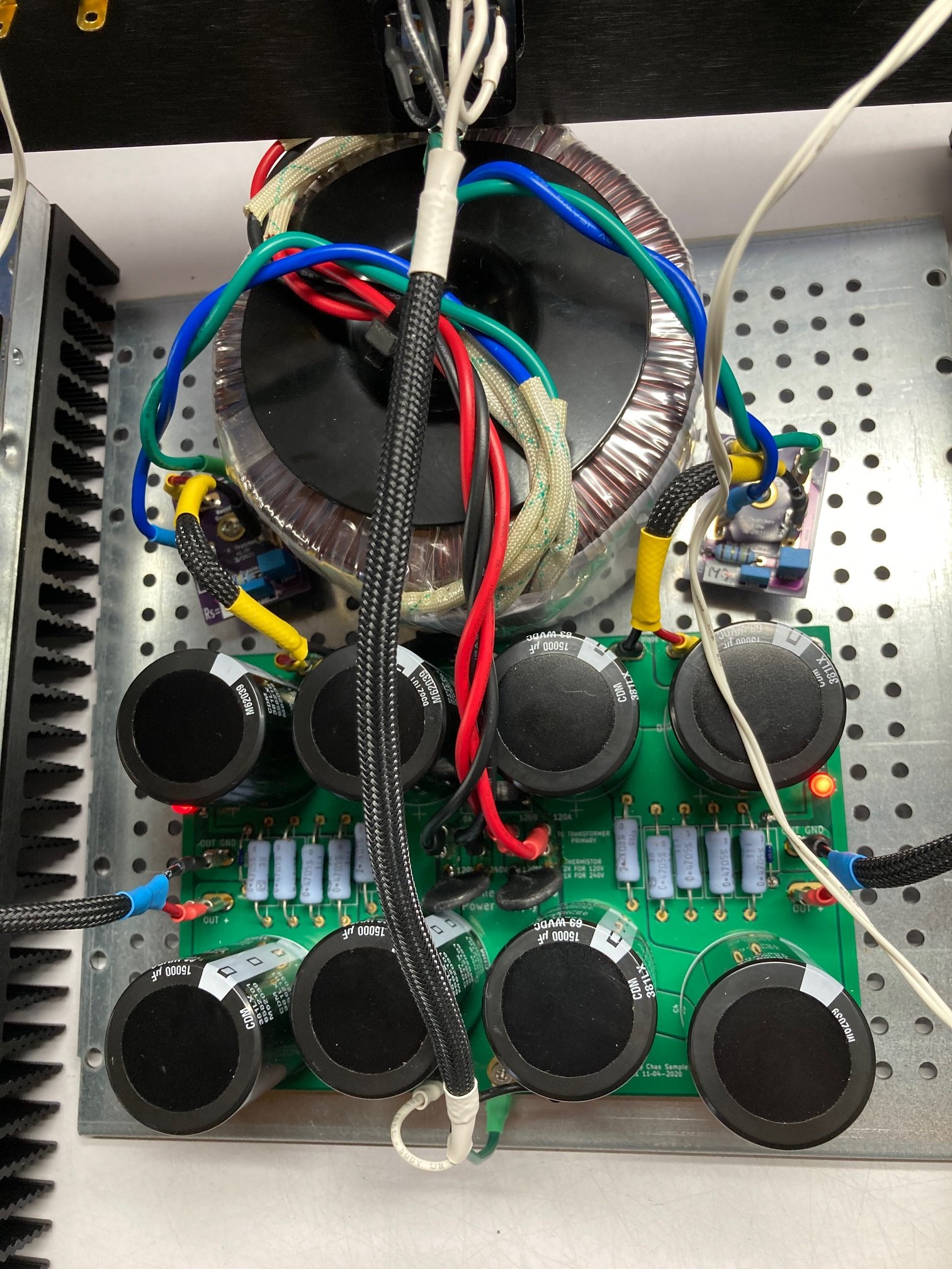

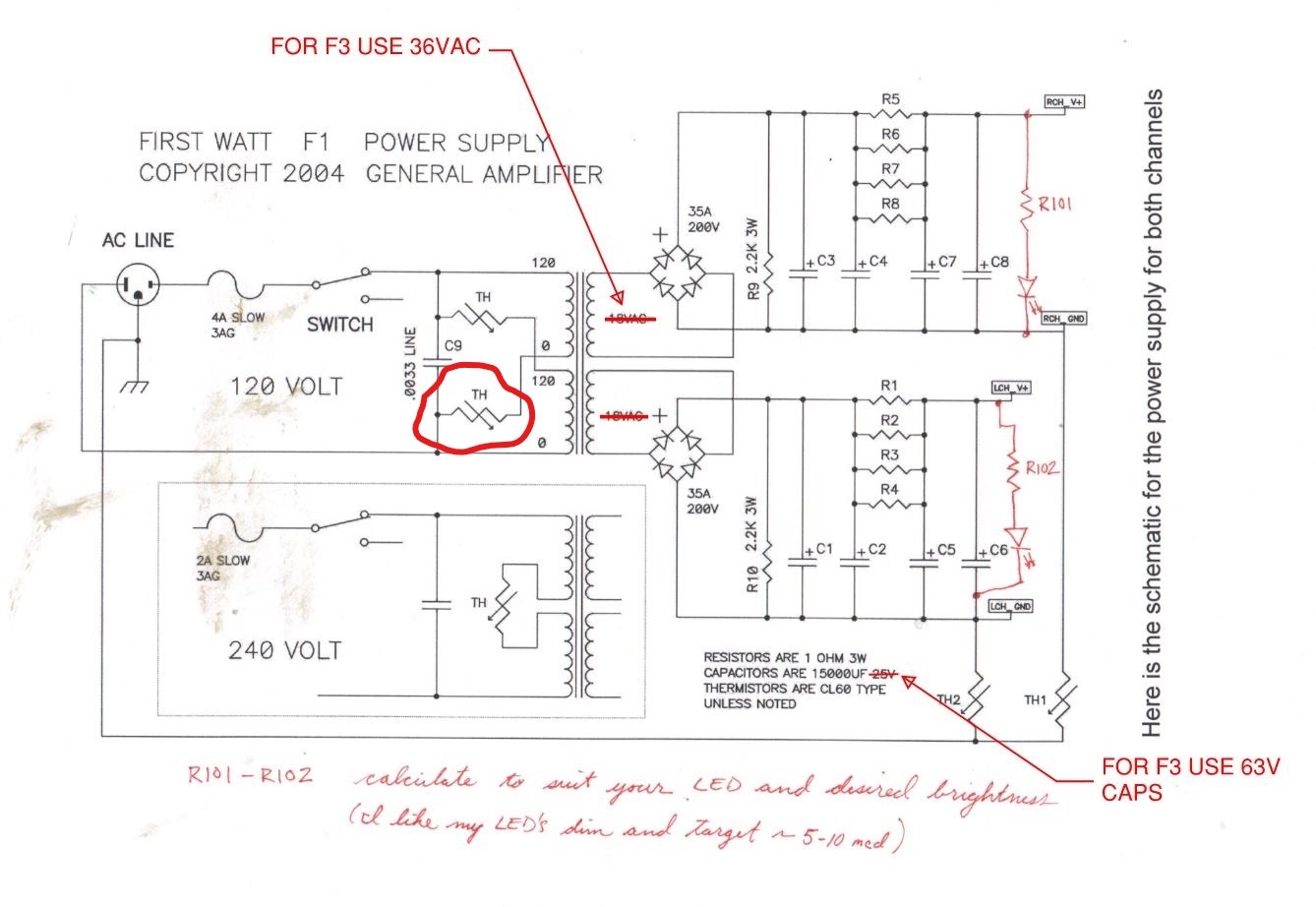

I'm in the process of swapping the toroids and rectifiers on my F3 and one of the thermistors, the one that shunts across the two neutral (black) legs of the primary, is getting very hot (60-70c) (circled red in schematic). The others, including the one that shunts the line side (red) legs, all read in the 20's to low 30c. A picture of the PSU is below.
Each primary reads 2R5 red-to-black. I can't read any resistance value (it's an open circuit) black-to-black or red-to-red. I haven't measured the secondaries.
The trafo with this behavior is a 300VA Antek AN-3236 (unshielded). This differs from the earlier setup in that each of these secondaries is 36VAC. A single secondary goes to each new bridge rectifier, which has snubber circuitry with values determined using a Quasimodo. Previously I was using two 200VA Antek AS-2218's (shielded), with the 18VAC dual secondaries on each trafo wired in series to give 36VAC. These went to un-snubbed discrete Schottky rectifiers. Each half of the PSU had it's own trafo. I don't recall checking the thermistor temps in this earlier setup.
One next step is to go back to a single one of the 200VA trafos and see if the thermistor gets hot again. Obviously I changed a lot of things simultaneously and may have to systematically swap them out one by one but I was hoping to get some ideas first. Hot thermistors are kinda scary.
Edit: is it because I'm testing at low volume and the trafo is just passing a ton of waste current?

mains located NTC is seeing mains current though, so it is normal to get hot
though, if you have 2pcs of mains NTCs ( dual primary practically in parallel for 115Vac operation), it's logical that both are of same temperature
just in case ( thing I need to keep reminding my self!) - never touch them while amp is connected to mains
I used an infrared temperature gun-thing to detect the high temps initially but did confirm by touching the CL-60 directly, which agree was dumb. The opposite side of the disk didn't read as hot by temp gun but I couldn't touch it as it's mounted nearly against one of the PSU capacitors. And yes I would expect similar temperatures on the line-side thermistor as well, even though that's not what I got.

Infrared thermometers may give inaccurate readings in some situations. If you have another thermometer such as a cooking thermometer, give that a try.
I suggest bending the CL-60 away from the capacitor. The heat added to the capacitor is not good for its health.
Another check would be to check that both sides of the power supply is drawing the same current. You can do that by measuring the resistance across one of the power supply 0.47R resistors at each side of the power supply. The voltage at each side should be the same if the current at each side is the same.

Thanks for the advice, I did bend the CL-60's a bit. I repositioned the trafo, cleaned up it's leads and tried again, letting it run in air for an hour or so. I didn't measure anything much hotter than 60c from the CL-60's which is cooler than some of the bias resistors get. I guess this is fine. : insert thumbs up in burning house meme here:Infrared thermometers may give inaccurate readings in some situations. If you have another thermometer such as a cooking thermometer, give that a try.
