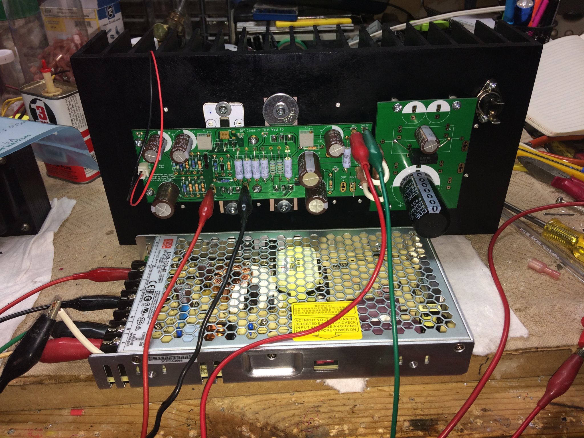

Hi
Is there a step by step procedure to set-up this F3 amplifier ? Also, test conditions please, ex no load or with load, input signal 500Hz or another frequency or simply short the input.
I’m using the CSAMPLE pcb (Thanks Chas) and matched Q1.
Power supply is a Meanwell 200W, one per channel + eventually the Mark’s SMPS filter.
Not sure what to set up first...
I haven’t touch R5 yet, so far I have the following by adjusting P1 and P2; 1V2, 3V, 8V and 21V.
Seems ok with the 8V and 21V, wondering about 1V2 and 3V. I need to get 1V1 and 3V5.
Thanks a lot.
Eric

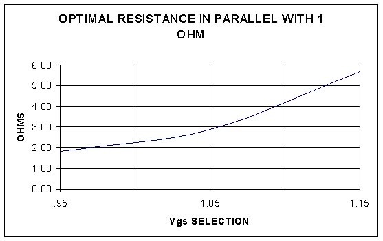

I did many iterations of P1/P2 adjustment while the thing was playing music but I don't know that this is optimal. Based on some measurements made with shorted inputs and 8R dummy loads, I have a feeling that one will measure a higher and more proper Vds for the LU if one is doing adjustments under conditions of shorted inputs and 8R dummy loads.

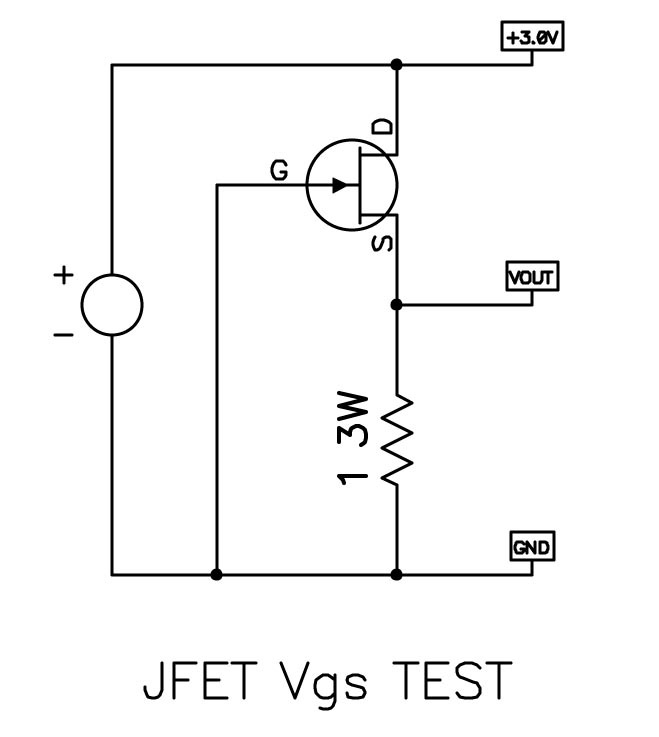

I first estimated the best value of R5 using a 5R pot in place of the fixed value and it led me to replacing the 2R, 2R, and 2R7 values for R3-R5 in the FW schematic with 2R7, 2R7, and 3R2, for a net source resistance of 1R04. As a consequence my amp has a bias of about 1.4A which is lower that the 1.65A spec of a true FW F3. Latest values for TP4 (LU drain) are 3.55V and 3.62V; TP3 (LU source) 1.35V and 1.41V; for Vds of ~2.2V, which is not optimal for lowest distortion (~2.5V is the goal based on Mighty ZM's testing).

I couldn't get TP1 above 17-18V originally, when R3 and R4 were 2R and my 5R pot was cranked to it's maximum resistance. Jeff recommended to try increasing the values in this bank, so I first went to 2R7 for R3 and R4, with the power pot still in. I was then able to hit 20-21V with the power pot and the adjustment pots at reasonably intermediate values. When I pulled out the power pots to measure them, they were 3R5 on both channels, so I put in 3R2 resistors for R5. I can get 20-22V fine now. I think Bubba had a similar issue.
I've honestly been through so many iterations of this amp that I don't want to make claims about the sound, except for the most recent mod, but that's in the context of solving the oscillation issue I was having so let's not go there unless that becomes a concern for you.

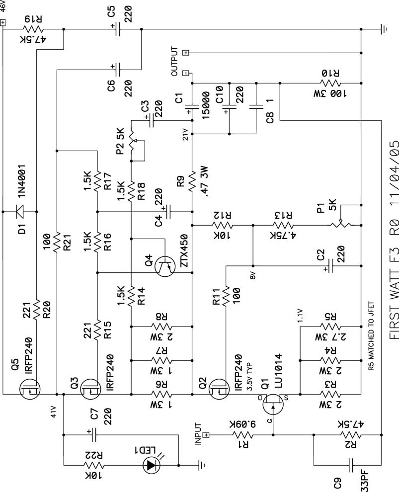

R5 is for setting 1V1 at LU source, which is first condition
then fine tune for 3V5 at LU drain, fiddling with P1, which is second condition
P2 is just for giggles, to fine tune Aleph CCS gain

I wish it was that simple...
Seems that the 1V1 is not just related to the value of R5, it also varies based on the position of P1 and P2.
I now have 1V1 but instead of 21V i used to have, now it’s 15V...
Not looking forward to repeat this with the second channel.

You´re pretty brave using those crocodile clips for wiring things up.Not sure what to set up first...
My experience is, they fall off quicker than one likes and dang!
The ones I know and have somewhere also have really tiny cables with pretty high resistance.
To use those crocodile clips also for 120VAC input of the SMPS is simply not recommended.
(use some wire end ferrules or so and fix it with the screw terminal)
Be safe Eric and good luck with your amp!

Well, I made some sort of progress.
I noticed that P2 would influence the DC setting which I found odd since P2 is wired in series with C3 which is AC coupled. Something was odd, probably some oscillation or something. I then decided to replace the SMPS (Meanwell 200W) by a linear supply, well, 10 minutes later everything was much easier to set-up and I then heard the F3 sing for the first time
. I do not intend to keep the linear supply since it's not powerful enough, instead I will use the 200 SMPS and add the SMPS filter from Mark.
When listening to the amp I had the following voltage; TP3;1V5, TP4;3V5, TP5;8V and TP1;21V which is close enough but the 1V5 which is adjustable via R5 was a little too high.
I then used a different volume pot (5 ohm,10W) in parallel to R5 and was able to bring the 1V5 down to 1V1. Cool, now I have my 1V1 but the 3V5 is gone completely and the highest I can go when fiddling with P1 is about 1V9...this amp is possessed...
Q1 had a much better Vds before at 2V (3V5-1V5), now down to a sucky 0V7(1V9-1V1)...far from the 2V5 sweet spot.
After being on for about 1h, the maximum temp is 48C on Q2 and Q3. My bias is 1.55A, a few days ago it was 1.7A...another fun fact about inconsistency.

Well tonight I can say that 1 channel is done and is singing. Went back to my previous setup as TP3;1V5, TP4;3V5, TP5;8V and TP1;21V
To prevent funny business i soldered a 1nF on Q4 b,c thanks for the tip ZM. I also relocated the gate resistor of Q2 directly on Q2. Maybe the above 2 mods aren’t necessary but they can’t hurt.
My case isn’t built yet, it’s in progress. Once the amps are in the enclosure I’ll fine tune both channel once it has cooked for about 1h.
Lots left to do but now at least I know I’ll eventually have a working F3 !
