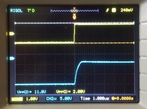

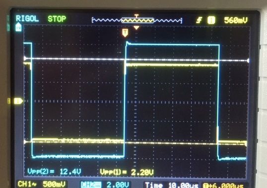

The Beta Tester's amplifier section is up and running.
Perfect square waves.

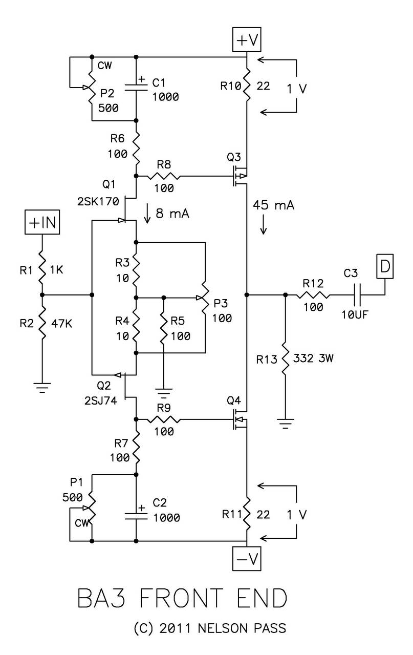

It looks like the Pass BA-3 boards from the diyaudio store would work for this F5 headamp...almost perfect.
Which brings up another question:
I have the BA-3 configured as a preamp now. I have tried it with a set of Grado SR125 (32 ohm). The sound was not so good. No drive at all.
Iam sure EVUL's F5 headlamp is great. Everything he makes is great. But why did the BA_3 front end not work well with my Grado's? Is it the output impedance set by that 332R resistor (too high) or the fact it is only biased at 100ma vs EVUL's higher bias?

You need to add a driver stage like e.g.
And then you'll be OK with a BA3.

I appreciate you attaching the schematic. I did some detective work...found out it's the new Pass Diy headphone amp in the works. I will probably use it and if I like headphones move on to the DAO which looks amazing from a use of parts and engineering perspective.
The component values of the pdf you posted above is from post #1.
The circuit has evolved since.
The gate stoppers for example should be at least 1k instead of 100R, and the Beta tester is actually using 2k.
Also the later layouts have local power supply caps.
http://www.diyaudio.com/forums/pass-labs/271926-f5-headamp.html#post4277624
http://www.diyaudio.com/forums/pass-labs/271926-f5-headamp.html#post4277681
And if you adjusted 5k trimmer to minimum (= 0 ohm), then there should be no current in the 2nd stage.
Patrick
