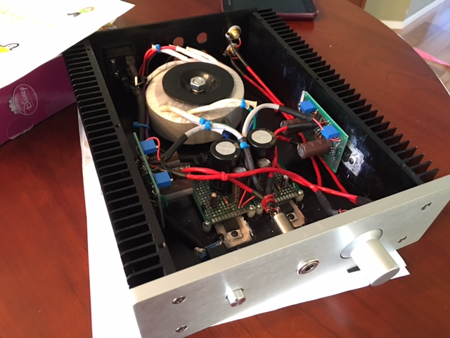

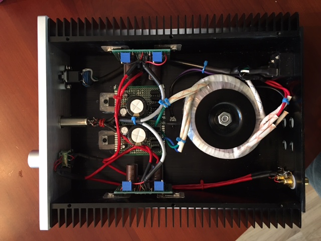

My f5 headamp (point to point) is done. Thank you to EVUL for posting this project (and Nelson of course).
Transformer is 50VA Antek, 2107 case, 317/337 regs (no cap mult), 10K stepped SMD pot. 180ma bias/16V rails. Caps are KG and PW in 317/337 and silmic on the amp boards. Gate resistors are 2K, the amp is similar to the veroboard layout in post 1. MSR860 diodes.

You are right, I should check the response of the amp and I will before I make a final conclusion.
I feel it might be a reaction to the bandwidth of this amp...it feels so wide, it may be that it is hard to focus on an area (like the midrange) because it seems so flat and wide. Everything is there, nothing sticks out. Some amps with midrange magic are just magical because there is nothing else there. It may be my brain...that's why I am asking if others feel the same way.
But regardless, I will make sure it is functioning correctly. I also don't think it's a PSU issue but I was hoping the cap mult would bring the magic out. Funny thing is the amp sounds MUCH better with vinyl...maybe limiting the bandwidth or the vinyl "EQ" is more to my liking.

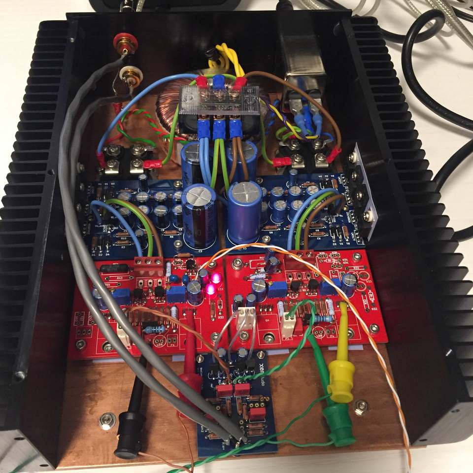

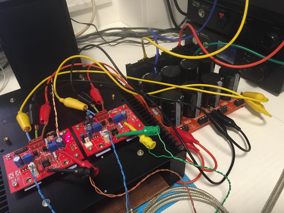

I built 2 versions of the F5-HA, first is the standard version using the official PCBs and power supplies. Sounded excellent to my ears.
Second is with my own PCB (picture attached). While building that second version and tested it with a SMPS, it didn't sound very good, then I filtered the power supply with a big RC filter, sound improved a lot. Finally I used the PS from post #137 - all the magic from the official version came back.
I think the power supply used have a strong influence to the sound of this amp.

The F5 needs a supply with sufficiently wide bandwidth to ensure stability, not necessarily one with better spec on paper.
That is why we chose an open loop cap multiplier.
The Salas shunt was e.g. a disaster. As Stixx found out.
And I would bet the Didden regulator would have the same problem in this application.
In my very first prototype, the amp on Vero board even caused my linear lab supply to trip at the mains fuse.
Patrick
The circuit from Ric is a virtual Gnd splitter.
It does not solve the problem of limited bandwidth on any regulators interacting with the F5.
The cap multiplier not only reduces HF noise.
More importantly, it provides a flat Zout from 10kHz onwards to >> 5MHz.
That is also the case for the Nazar regulator.
Patrick
