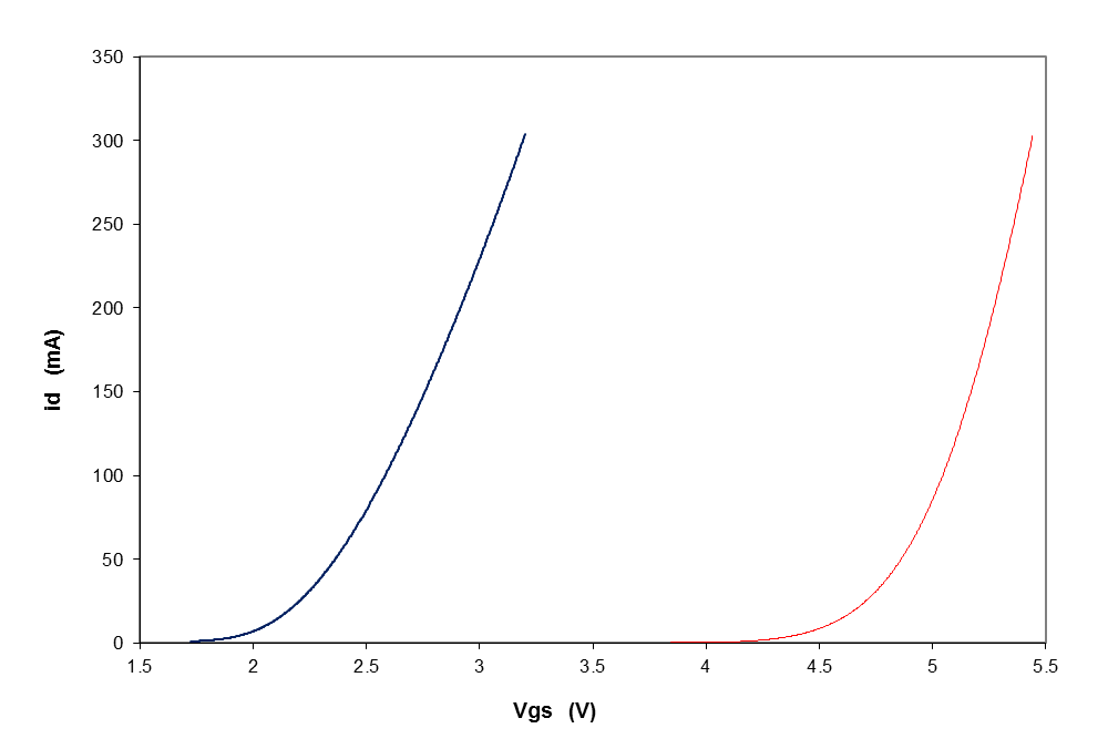

I thought it would be best to compare their Vgs vs Id directly.
The first is Vgs vs Id.
Red is Fairchild FQP3N30 and blue is Toshiba 2SK2013.
The Fairchild has a higher Vgs over the entire range of Id (to 300mA).

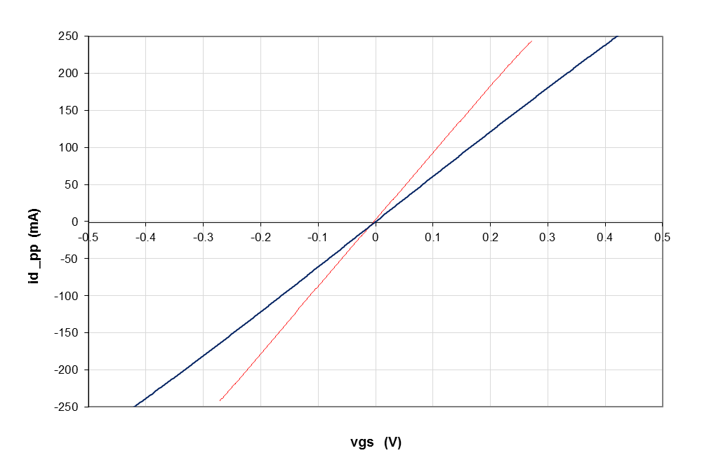

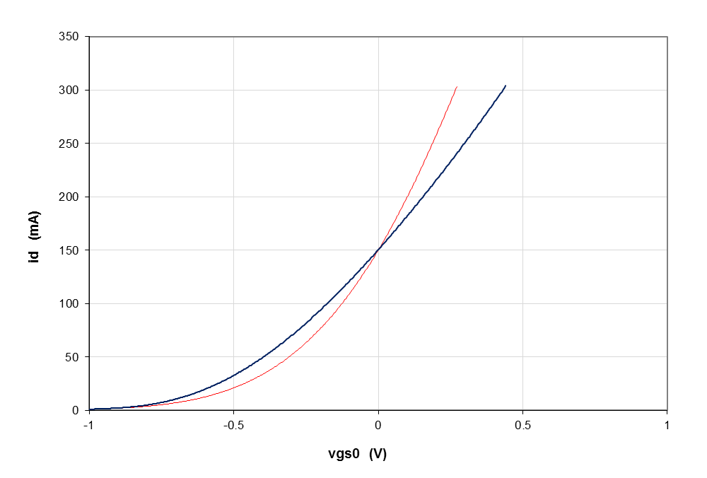

The 2nd is vgs vs Id around the bias point, so that the static bias voltage has been subtracted.
One can see that the Fairchild also has a higher transconductance.
The rest, such as capacitances, etc. are best referred to corresponding datasheets.
Patrick

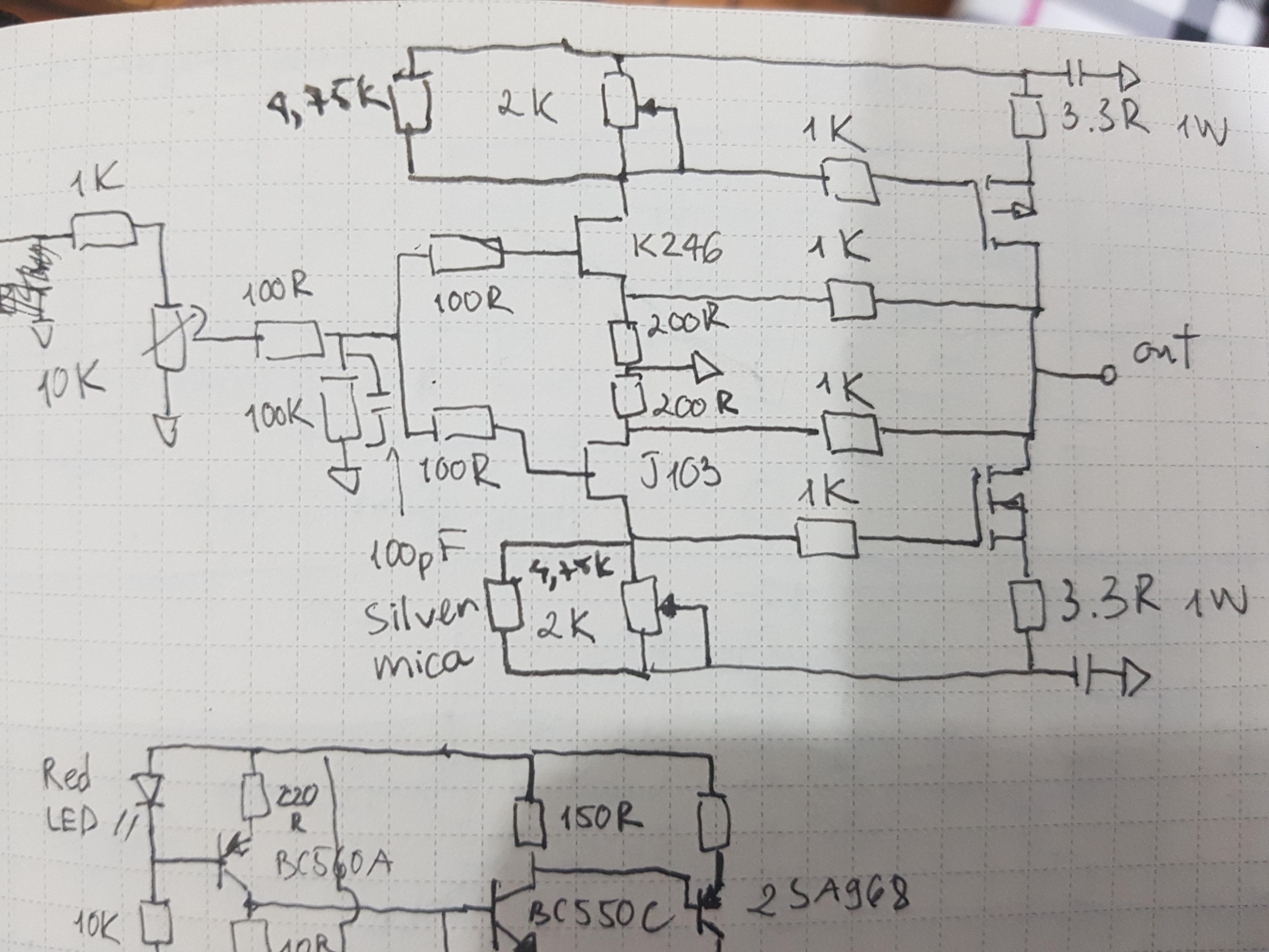

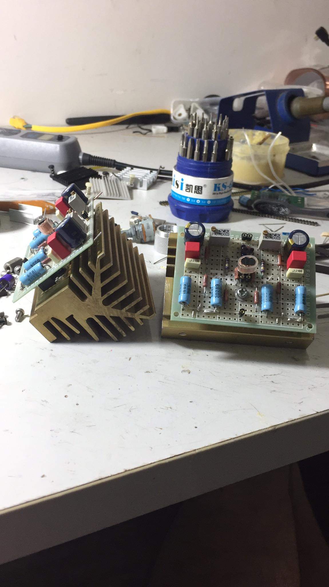

Built my F5HA on vero board. Schematic included.
Power supply is +/-16V from diy Kubota regulator. mosfet drain resistor are two 6.8R parallel because I can't get 3.3R 1W from local shop lol.
I used K246 J103 with matched Idss of 3.21 for 1 channel and 3.27 for the other.
I have a question, is R_drain of jfet set right?
