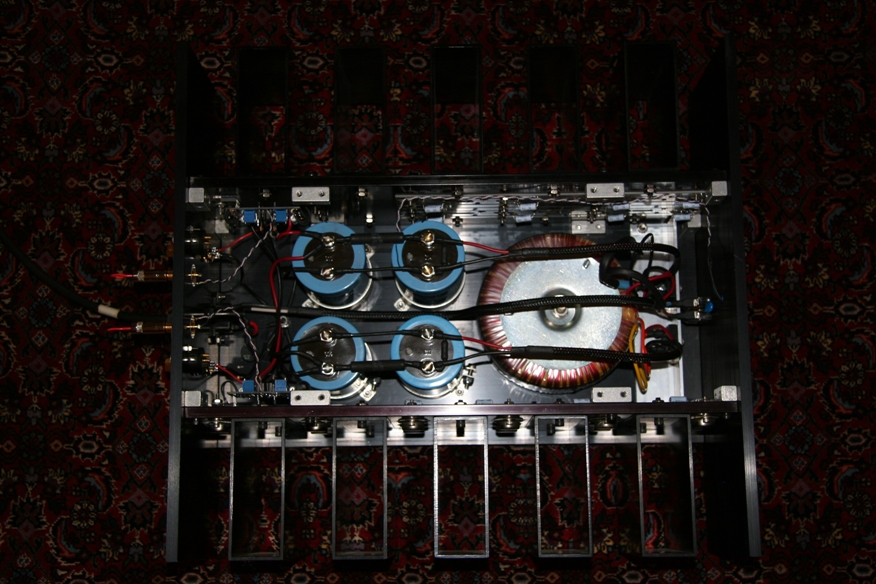

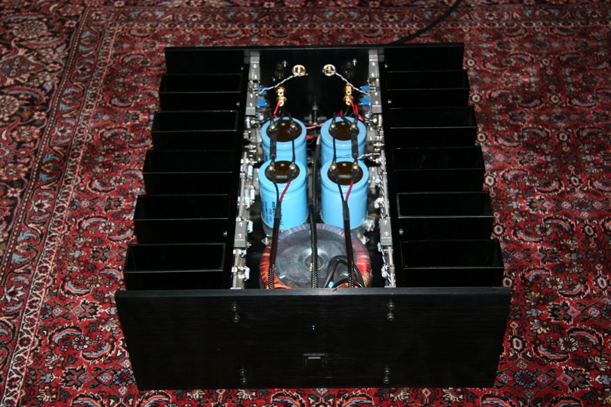

Look like the avionics in Russian fighter jets
yes, it has something like military gears...
style MIG25, rugged high tech.!!
If I looked into the cockpit of a commercial airliner and saw that, I would run the other way!
