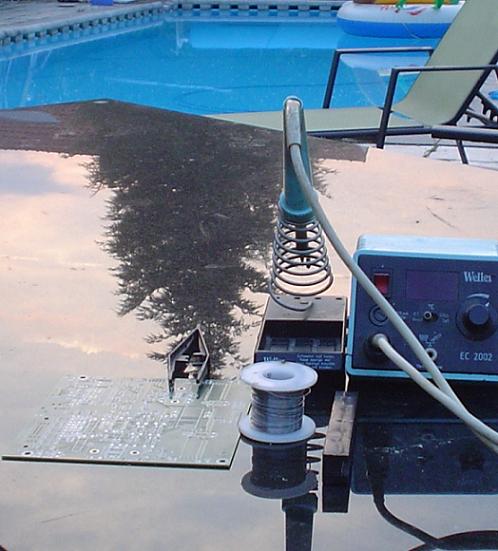

If the weather is nice this weekend, you can be darn sure that I won't lift a soldering iron.

A bit of outdoor frying is rather nice actually, even on 4-layer boards. (preferably buck naked)

jackinnj said:If the weather is nice this weekend, you can be darn sure

This is the product of my other labors:
