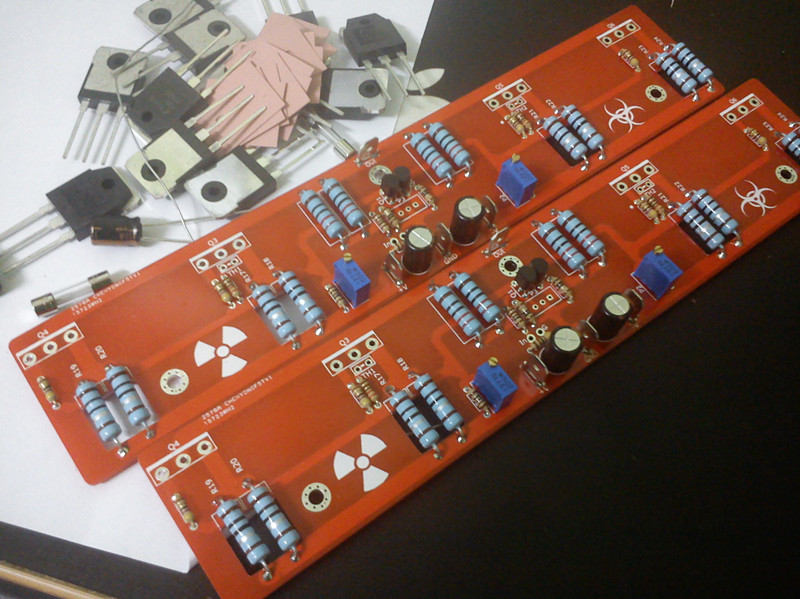

Hi chchyong89,I would have that board.Where you got from.Can you give me a detail please.Start building a V1 without P3, hope everything going smooth
PS, life without a decent camera is a crime![]()
I sent my layout for fabrication. Try paying attention this thread, maybe someone will run a group buy
