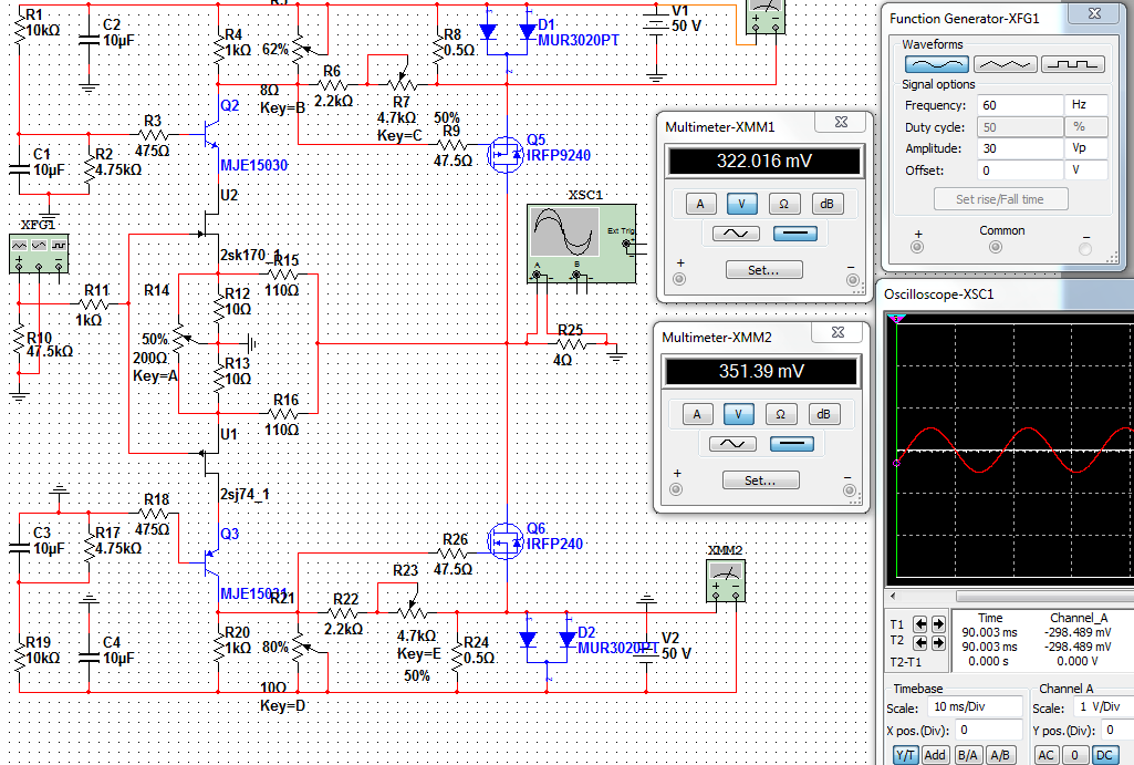

May someone help me finding out what is going wrong with the following simulation?
The models I used are:
2sk170:
+Beta=59.86m Rs=4.151 Rd=4.151 Lambda=1.923m
+Vto=-.5024 Cgd=20p Pb=.4746 Fc=.5
+Cgs=25.48p Is=8.477p
+Kf=111.3E-18 Af=1
2sj74:
+Beta=92.12m Rs=7.748 Rd=7.748 Lambda=4.464m
+Vto=-.5428 Cgd=85.67p Pb=.3905 Fc=.5
+Cgs=78.27p Is=12.98p
+Kf=26.64E-18 Af=1
Thanks in advance 🙂

Daniel,
Check the orientation of Q5 it may be installed inverted.(I have the same problem)
Best Regards
Jim
Jim, you got it right! 😀
Ihquam, thanks for the answer also!
I lost the whole day checking it but couldn't find the problem... 😀
That's why NP Citation 12 wasn't working also. 😀
Besides IRFP240, 2SJ74 and MJE15031 were also inverted.

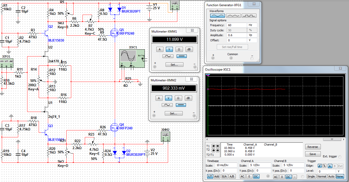

Now I can bias it, but I need 30V at input to produce 500mV at output. Perhaps the JFET models are problematic? Jim, what models are you using?

Your wiring to the base of cascode transistor Q3 is wrong. R18 is connected to ground, not the voltage from the resistor divider.
Thanks for finding it out, Ihquam!
Besides that I also had to change 2SK170 by Multisim original model and 2SJ74 by 2SJ108 original model too, because the models I was using didn't work at all. I had to have very large input levels.
What about R19? I was using 10k because I thought it should be symmetrical with upper side, but I've just noticed it is really 47,5k on schematics, while R1 is 10k. What's the right value?
