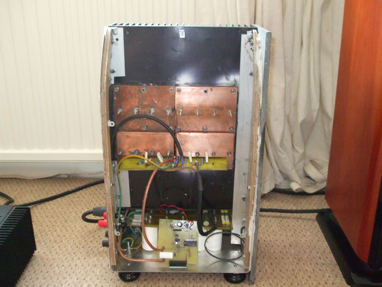

Has anyone had a successful F5(T)v3 build yet ?
I'm intrigued to see how much heat they are ditching.
I've got a DIY Aleph 4 which gets quite - but not excessivley - hot.
I'm wondering wether I can't use it as a donor for a dual mono build. ie keep the chassis, heatsinks and power supplies. +/- 48V may be too high even for the V3 ???
there is no problem running the v3 on +/-48V
your aleph4 dissipates around 200W pr channal?
thats around 2A bias on +/-48V supply.
