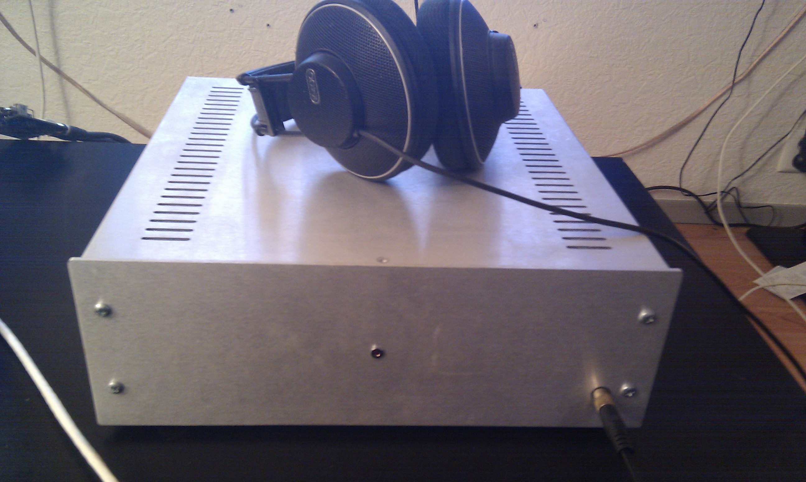

Hi everyone, just finished my headamp(preamp), the one from post 42. Very happy with the sound, and a BIG improvement over my Asus soundcard. Bias at 400mA and heatsink around 45 degree celsius. Powered with two transformers, CRCRC and 7815/7915 regulators. I guess i need new headphones though.
Thank you Juma!
Thank you Juma!

regulators
Congratulations holminator.Very nice job.I think using a better regulator instead of 7815/7915 would be better.For example lm317/337 types.Thanks

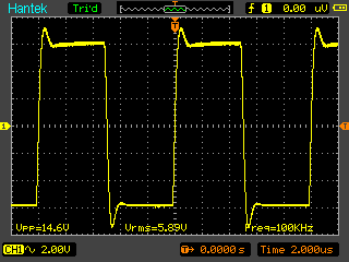

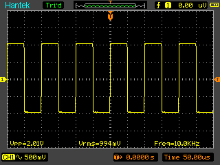

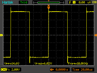

Hi crt,
it's a fast amp and your pics show slight but well controlled overshoot - nothing to worry about. If you want to eliminate that overshoot some answers are needed so we can get the whole picture:
1. The scope picture of the input signal at 10kHz and 100kHz recorded under same conditions as output signal pics which you attached
2. what's the value of gate resistors at output MOSFETs' gates ?
3. what's the value of resistors in the feedback loop ?
4. do you have bypass caps on amp PCBs ?
5. details about amp's power supply ?
6. pictures of your amp's insides - wiring etc.

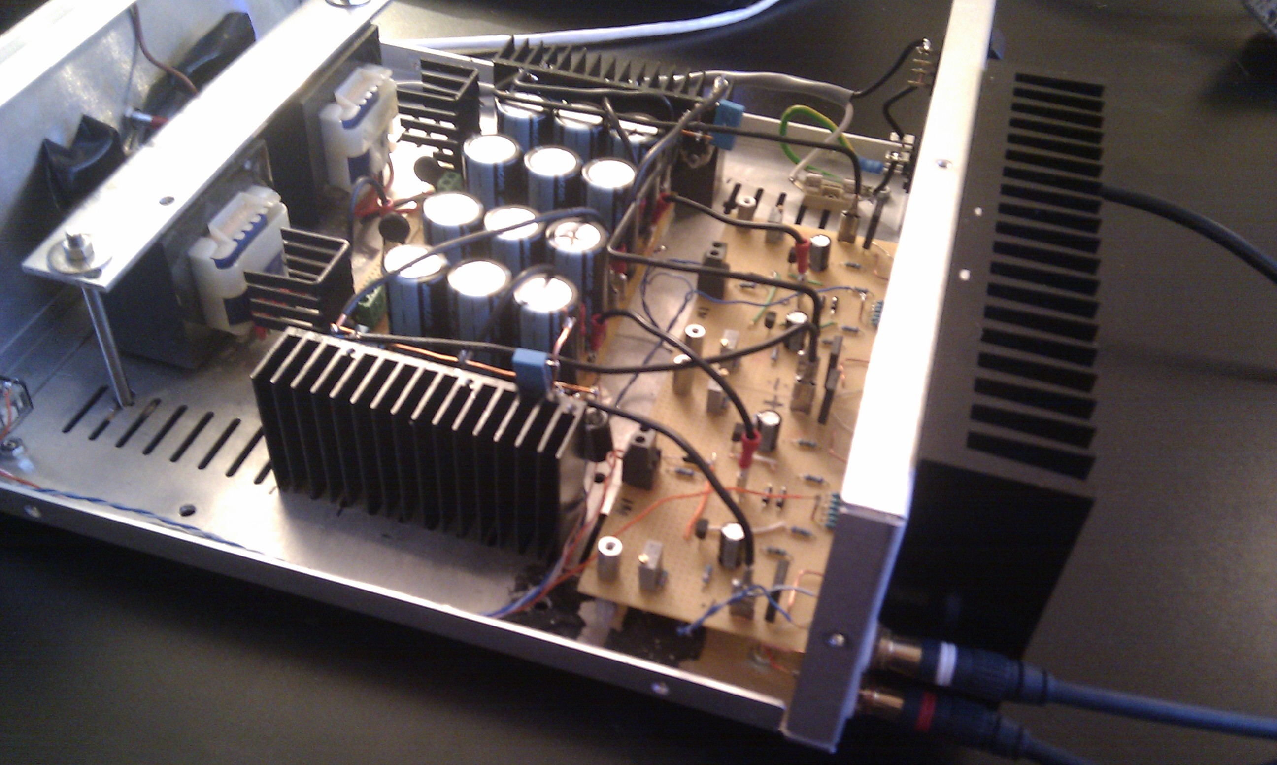

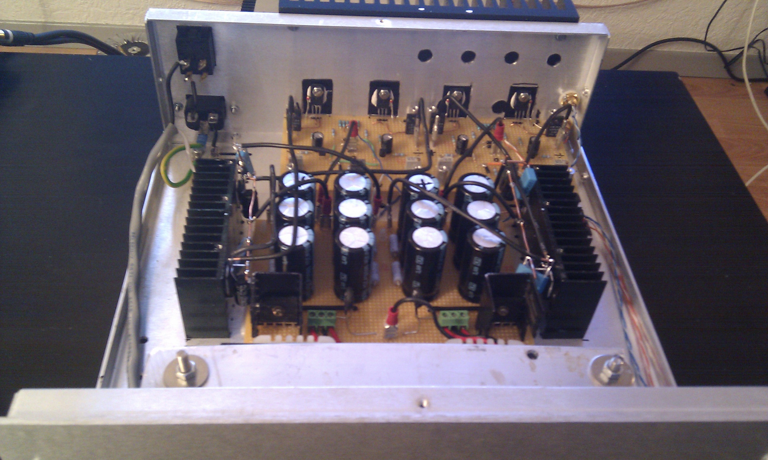

I found pics in posts #192 & 193. It looks OK. You used a lot of small caps in PSU - it gets you rid of one sort of problem but it puts you in another sort of predicament. Never mind, it would not be practical to deal with it now.
I asked you for a picture of input signal. I don't know if your input signal has some overshoot. Check it, and if it does, it's OK. If it doesn't, there are three easy things to do (pick what's easier for you):
1. Disconnect one of three 150R power resistors in every feedback loop so that in your stereo amp instead of 4 x (3 x 150R) you get 4 x (2 x 150R). That will raise the gain and slightly change the frequency and phase response of the amp. If you choose to do this you'll have to check the bias/DC offset again.
2. Connect one 220pF cap in parallel to every 150R triplet (you'll need four 220pF caps). Those caps can be bigger (330 or even 470 pf) since the feedback loop has very small impedance. They can also be smaller - you'll have to experiment to find the lowest value that will eliminate the overshoot. This change affects the frequency and phase response of the amp, too.
3. Increase the value of gate resistors on the output MOSFETs but that's the less effective method.
Now you have something to play with, you can try all three methods and decide what you like the best - all of them will influence the sound, some for the better, some for the worse - it depends on your build's characteristics.

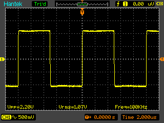

It's helpful to remember that a pulse generator likes to have the correct termination -- the input impedance of an F5 is not 50 ohms.
Of course, but we don't even know what's crt's square wave source - that's why I asked for input waveform pics...

here output from signal generator connect directly to scope
