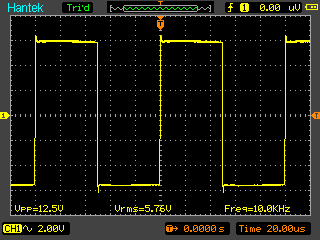

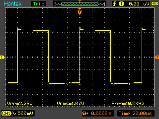

Input looks fairly OK if the picture is taken under same conditions - func. gen. loaded by amp's input.
Ups, sorry.
That signal generator to scope direct without loaded by amp input
this one loaded with amp input

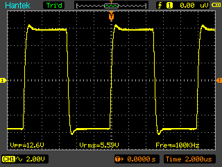

Your amp did just what it's supposed to do - overshot in, overshot out...
Yes, that slight overshoot but not much compare than output

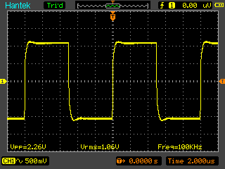

Here's the report :
1. Remove one of 150R (75R sum) at feedback ==> no luck here
2. Change 243R gate stopper to 681R ==> same, no luck
3. Put capacitance as Nelson Pass says at 150R (50R sum) ==> compress the overshoot a bit (try to lower it to 200pF and then 100pF, nothing change)
4. Add a bypass caps at PCB Amp (10uF with 100nF) ==> compress overshoot a bit
Here the result (combination no 3 & 4)
Thank's (Juma and Nelson Pass) for all support

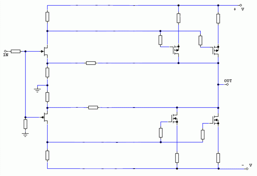

Hi Juma
I like your amp design !
Just got to the end of the thread...
...with the world's s l o w e s t internet...
...Phew !
1 question...
...The thermistor.
I see where it is in the schematic...
...I see people mount it 'hovering near' an OP device ( not a metal-tab one, on sink ).
I dunno if I'm being thick here ( probably )...
...but, What does it do ?
You obviously wouldn't have it in your schematic if you thought it wasn't needed...
...one builder didn't fit it...
...I guess they just fitted a 'suitable' resistor, or re-calced the parallel 2.2k etc.
Any explanation of this function would be most helpfull.

Not thick - just plain lazy...
Read the F5 manual/article at the firstwatt.com
NTCs are there to thermally compensate for the vertical MOSFETs' tendency to increase channel current with temperature.
With biiiiig heatsinks and enough time at hand to wait for thermal equilibrium to be established (an hour or so), you might decide that you can live without NTCs in this amp...

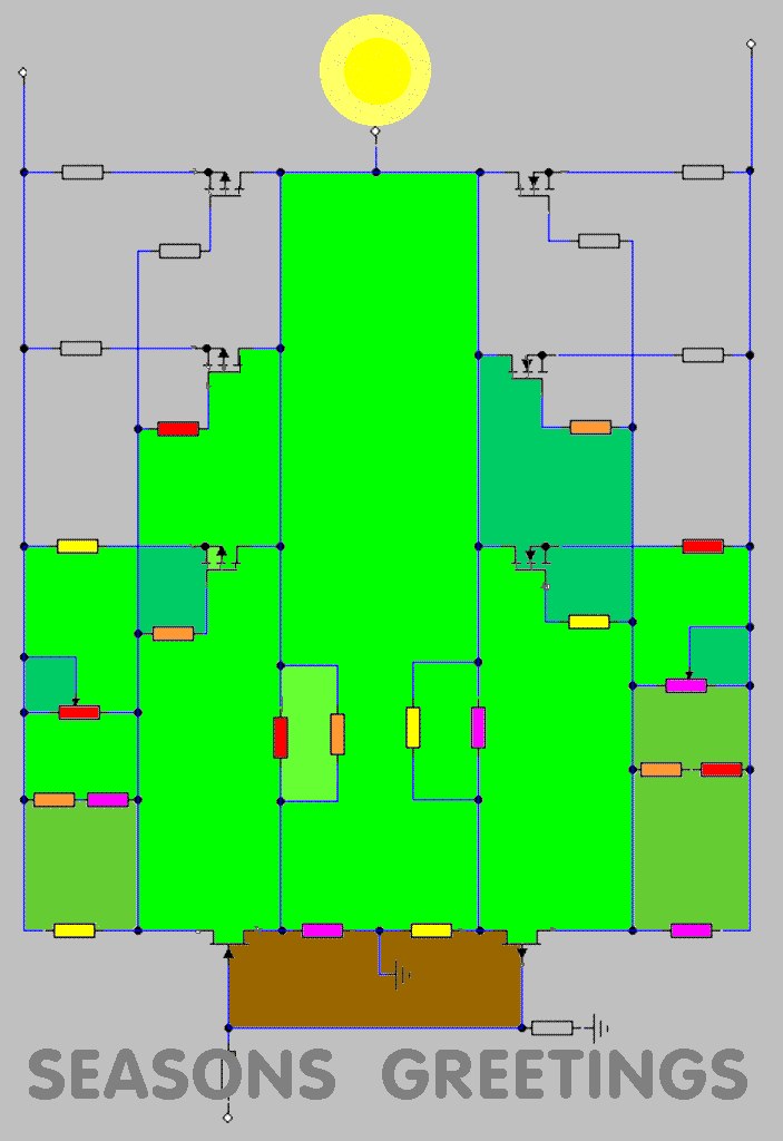

Here it is after the erasing work.

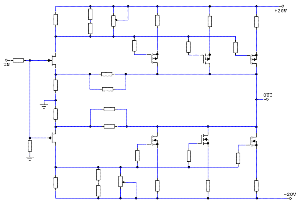

Actually, we can shave this version of F5 a bit more and still make it work nicely.
If we accept lower power (10W RMS @ 8 Ohms) and use the lower voltage in power supply (+/-15V) we can bias the MOSFETs near the zero tempco point (about 0.6A) which will get us rid of NTCs and with carefully chosen JFETs' drain resistors we can avoid trimming pots.
For lower power 2 pairs of output MOSFETs will be OK.

Hi Juma
I like your schematic by the way !
If I had 22-bit digits ( instead of 20 ), I could count ALL the parts in 1 Byte ( including the extra thumbs ! ), and NOT loose count...
...N I C E !
Could be possible to loose 1 of those feedback resistors, I guess; and replace with 1 BIGGIE !
I know people get all 'steamed up' about 'mythical inductance' here...
...any objections to 1 B I G chunky 25R wire-wound ?
Mmmm...
I like the parts minimalism Juma...
...but I rec. you 'had it nailed' the 1st time, with the 6 little Toshey's you used.
( I wanted 8, when I first looked; but hey, dunno why really )
Your original schematic looks 'good to go' to me...
...especially since The Space Egg Corp. parts-stash, already has most of the bits & bobs for the amp !!!
The transformer we have BTW is a 225 Watt 18-0-18 donut...
...could get a second one of these as well; I know they like 'em BIG round these parts.
( seems like enough Watt-not's to me though; bout 100 needed )
Loads of other parts here as well.
Main missing items being the IRF's & a couple of 2SJ74's ( got some 2SK170's ).

what is different from the Pass BA-3 frontend ?
looking at schematics I see only minor difernces
I really can't figure out why this is a poweramp, and the BA-3 only a gain/driver stage![scratch :scratch: :scratch:](https://files.diyaudio.com/forums/images/smilies/scratch1.gif)
