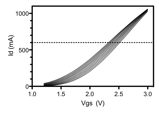

Experimenting and measuring is my day-time profession so this is indeed also where I planned to start with this version of the "F5J".
I have been tracing a few thousand FETs over the last year or so and having a good (experimental) look at the zero tempco point can only increase my understanding of these devices.
Thanks for the help and encouragement:)
Nic
Joined 2009
I'm sure you'll be presenting us new insights :up:
Not much insight - just some data:)
I slow-fried a 2SK2013 and recorded traces every 6 degrees of temperature rise.
0.6A does not look particularly special to me - in fact 1.1A seems more like the right drain current for zero tempco, but unfortunately beyond the device rating:eek:
The measurements are not really the same as data sheet......
The zero tempco occurs at the correct Vgs (about 3V), but I measure higher current:confused:
Could the difference in Vds (15V vs. 10V in data sheet) explain this?

NicMac, that's what I was talking about - not all 2sk2013s are born equal. The one batch I got was in compliance with datasheet, the other one was not (zero tempco was in 800-900mA area).
That's why it's good to leave the NTCs and pots in the circuit.
OTOH, that picture of yours shows a rise of Id of about 170mA at Vgs=2.5v for a temperature change of 50 degrees Cels. and that's not a big deal anyway...
Bias it at about 450mA (cold) and the bias will rise to about 600mA when hot, and everything's OK.

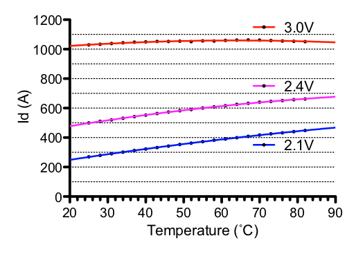

I have attached the data plotted in a different way to better illustrate how current change with temperature for selected values of Vgs. Black dots are the measured values and curves are quadratic fits.
I will have 3 different batches of 2013/313 to look at so maybe I will find some with lower zero tempco. I'm not really counting on this as the increase in current is indeed fairly limited and unlikely to cause thermal runaway. It will work just fine (even without NTC).
