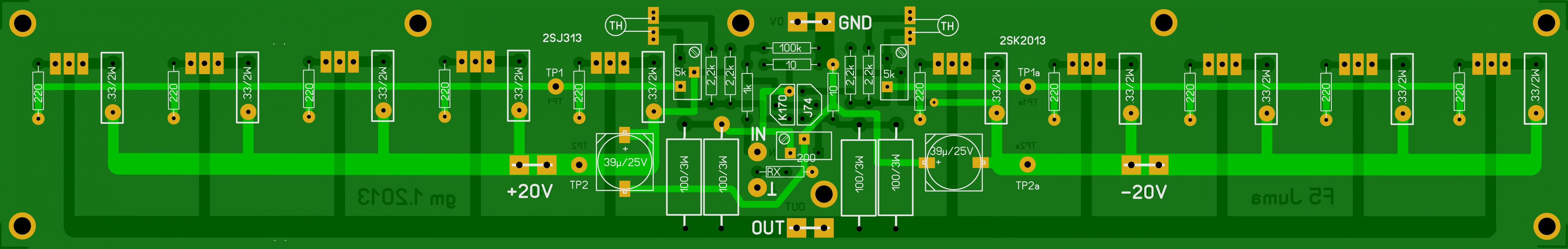

OK, now that I looked at the 2SK2013 datasheet I understand the choice of the source resistors better.
The gate−source has a voltage rating of 20V, so with a 20V PS you can keep the source resistors low, but with a 22V PS you can lower the voltage a little that the mosfets see if you use source resistors of 0.68 ohm
Georg,
As an Alternative to using the 0 volt point on the pcb as the central Gnd point, the provision for operating this pcb with the central 0 volt point located at the power supply Regulator 0 volt point - an Option, if you will.
Also, if we were to continue this analogy, could you add a further provision to add a resistor between the signal input -ve wire and the pcb's gnd point. - it's a neater way of diong this if it's required - another Option
Sorry to add what might be seen as 'nit picking' things but options are so good to see on pcbs, especially if these don't produce problems.

Georg,

James,
It is my pleasure. Even though I don't believe that it is necessary, I have isolated signal ground from 0V by RX.
Changes at the regulator boards are not longer possible without extra cost, as my boards producer's preparation work has been done already.

Hi Rush,
First, the preparation work is already done by my boards supplier. Modifications now would cost additional EUR 45 at least.
Second, it would be necessary to considerably enlarge the boards’ sizes to guarantee a certain space between the MOSFETs to avoid thermal issues. More area = more money.
So, if you really want more current, I suggest to point-to-point wire the additional transistor(s). Be careful to solder the gate stopper resistors very close the transistors’ legs. There is no need to double the small capacitors and Zeners at the drains and sources yet.
Another solution might be the use of IRFP140/IRFP9140 (31A/21A)for example for more current.
Georg
Hi Rush,

Georg,
You have done a great job and more current is not what I am after when I asked if you had doubled up the number of regulators.
What I meant was, that with only a plus and minus on one board at $20 each (or whatever) we could get a lower cost per regulator if we made a larger board with 2 plus and 2 minus regulators on it so we could cut the board in half if we wanted to have two mono amps. The cost of one larger board with 4 regulators is less expensive than buying 2 boards with only 2 regulators on them.
Sorry for the confusion,
Rush

Rush,
Sorry for my misconception.
The costs for one dual mono set consisting of two +- regulator boards will be EUR 16 approximately. The quotation for the whole set on one board differs by less than EUR .30 (and I am not quite sure, whether my Czech suppliers really understood my question...
Expect a price in the range of EUR 22 for one stereo amp boards set (2 amp boards).
