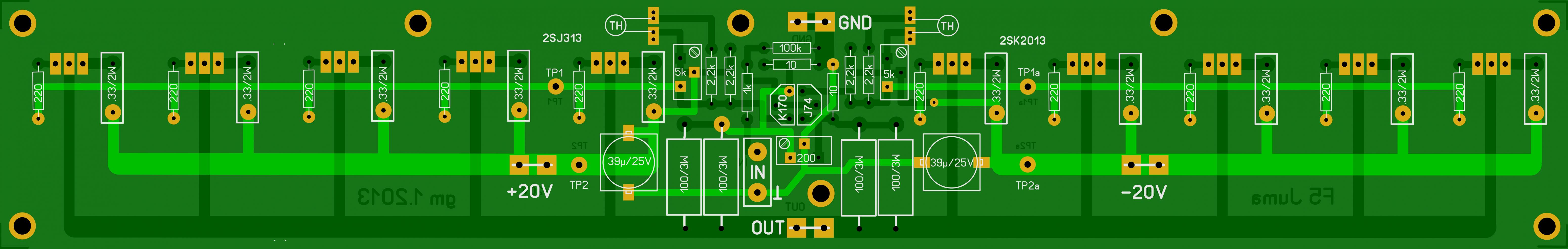

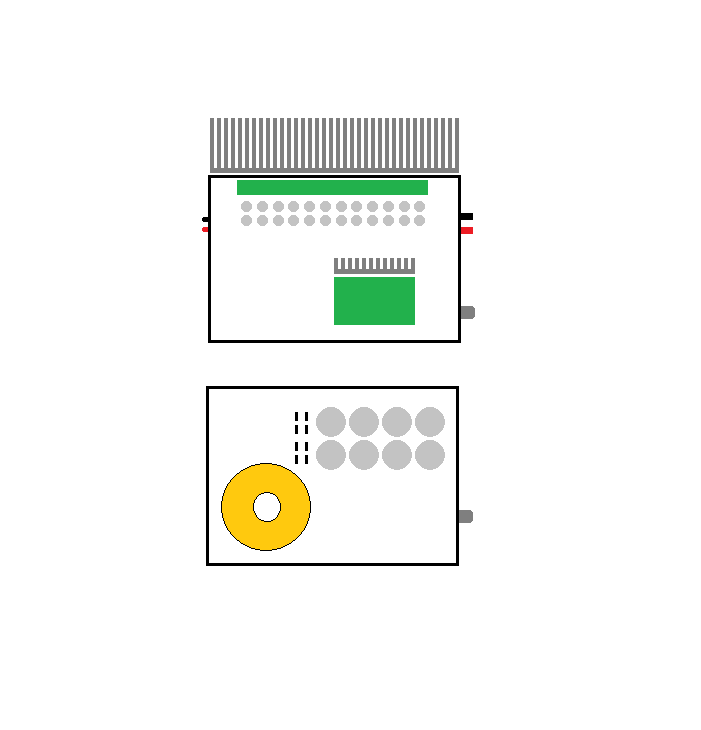

might build mono amps like this
each with seperate box for power supply
reg boards placed with power amp
power supply box with high current caps
multiple small lytics close to output board
or at least thats the plan right now :p
my trafos are 400VA 2x 22V toroids
so the power supply box could also drive a turbo charged F5 :D

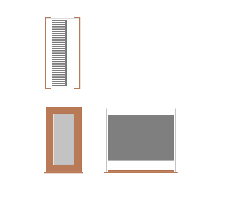

wow, thats like a small power amp
well, there would be plenty of space for the reg on bottom of my power amp main heat sink
measures like 300x250x70mm, each channel
sure hope they can take the heat then :D
thanks
+/- 22V on amp rails ought to work ok, and give a bit less heat dissipation ?
with +/- 30 fed into the regs, what would be highest possible regulated output voltage ?
or what would be optimal operation voltage ?

+-22V outputs should be possible.
That won't change your thermic balance however. Higher supply voltages will cause increased heating of the amp transistors.
Nevertheless, your heatsinks seem to be proper to manage that. :redhot:

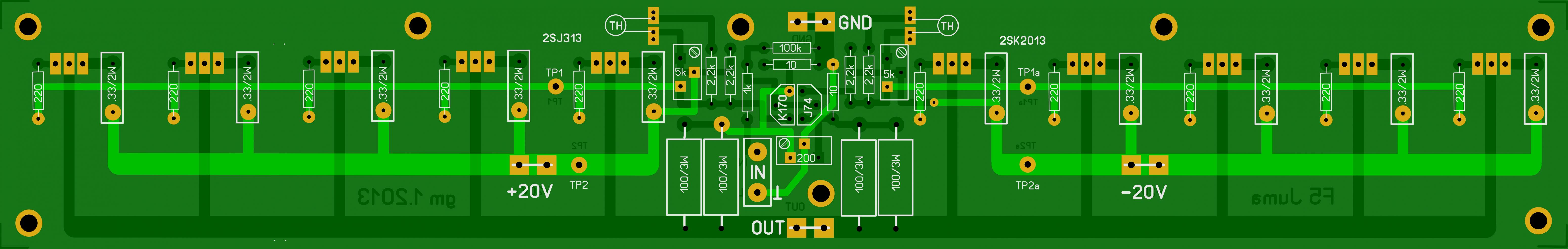

In my 'cap stash' I have a whole-load of 40uF motor-runs...
Would you consider it's worth using any of these
one connected at each output mosfet ;)
which is why I would have liked to have a power supply connection placed at each
basicly its just a few exstra holes for optional connectors :rolleyes:
well, and maybe a few exstra ground points as well

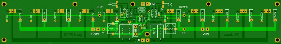

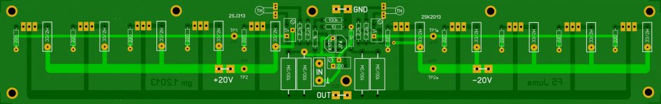

OK, I added buffer caps to the boards (for example Nippon Chemicon super low ESR PXA series).
Central groundig point (0 V) is the load/buffer caps. So there are no extra terminals necessary at the amp boards.
