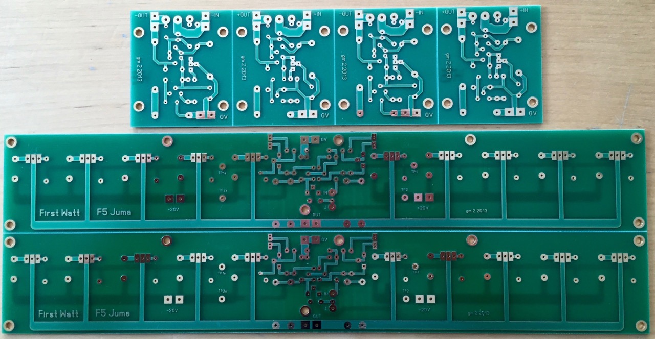

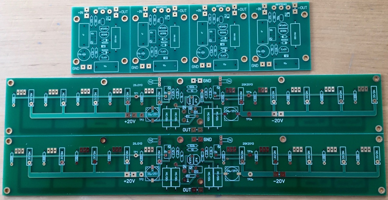

I also have a set of PCBs for this build if anybody is interested (30 euro postage included). They were made by late permaneder and are of excellent quality. I'm not sure what the smaller boards are. Maybe cap multipliers. All info should be somewhere in this thread.

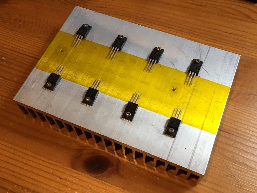

I am going to make this amp with 4 pairs, maybe run them 300mA ea. Thinking about an all 3d P2P sculpture type amp, no PCB, no veroboard. Will run from +/-25v rails that I used for my M2 project.
Starting with drill & tap 8 holes on a heatsink. The nice thing about J313/K2013's is they don't have any exposed metal so no insulators to worry about.
Using heatsinkUSA 7.38in wide extrusion, 5in tall. Same heatsink that I used for M2 so I know it can handle 1.3amps at 25v rails.

Really? My estimates show this size heatsink to be woefully inadequate for a constant 65W draw. Are you using a fan?
Yes. A small one with speed reduced to silent seems to work. Although without the fan it runs at a temperature that lets me touch heatsink for 5 seconds or so.
Here is the M2 - 60mm fan with 100R resistor.
I actually have some much larger fans now 100mm size I think.
