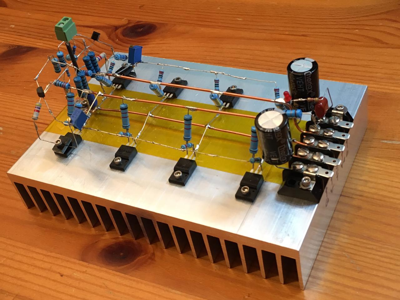

I just finished building and now need to test. Debating whether or not to test now or wait until fresh eyes tomorrow...
I don't have any 4.7k NTC thermistors on hand yet (on order). I put a carbon 4.7k resistor in place and added a 1N4007 diode in series. Si has a negative tempco and I clamped the diode onto the MOSFET body. I did not have any 0.33R 2W resistors so am using 0.22R 2W metal thin films.
I also added 2200uF smoothing caps on the rails, and a 10R-100nF to ground Zoebel on the output as customary with most of my amps.
It was fun and not too hard. I hope it works.

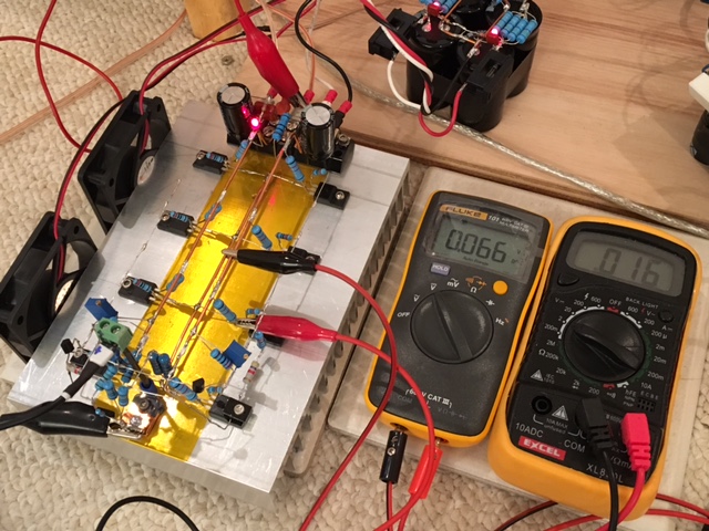

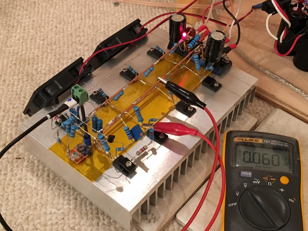

It works! Adjusting bias/offset was tricky. The bias changes a lot for a small movement of the pot so I am not sure why it is so sensitive. I think the diode temp compensations is even working. Running at about 1.6amps total current. Sounds real nice - clear and delicate sounding.
Here it is showing 60mV across 0.22ohms Source resistor or 273mA on one MOSFET. About 54W dissipation overall.

One of the 2SK2013's is running hot passing, 1.1amps through the 0.22R Source resistor, while the others are 300mA. Is it defective or is this just the whole reason why we need to match them? Seems to be quite the outlier and the others are sort of in same ballpark.

How closely did you match the source resistors?One of the 2SK2013's is running hot passing, 1.1amps through the 0.22R Source resistor, while the others are 300mA. Is it defective or is this just the whole reason why we need to match them? Seems to be quite the outlier and the others are sort of in same ballpark.

a.) matched resistors allows comparison of current flow.
b.) matched resistors gives a matched voltage drop when the current is equal.

I did not make any effort to match anything. The resistors are 1% tolerance metal thin film units. I am going to pull out that MOSFET and swap with another one and see if things improve. I will pull the resistor as well and measure.
Works well now.
I swapped out two MOSFETs that had high current flow and that fixed the problem. It seems they have a higher inherent current to voltage response. Amp is running at 1.4amps overall now. Individual currents range between 300mA and 370mA ea. Offset is about 15mV to 25mV. Probably because my two JFETs are not thermally couple and floating out in open air where their cooling varies. I could tie them together and put the whole thing closer down next to the input terminal block. That would probably reduce fluctuations.

That explains why they haven't blown up, it was running almost 2amps but did not run away. That's Kapton tape - yes for insulation so I don't do anything stupid like short the pins to the bare aluminum which is ground. Kapton is actually a good substitute for transistor silicone pads. It can withstand high temps - you can solder on it even.
