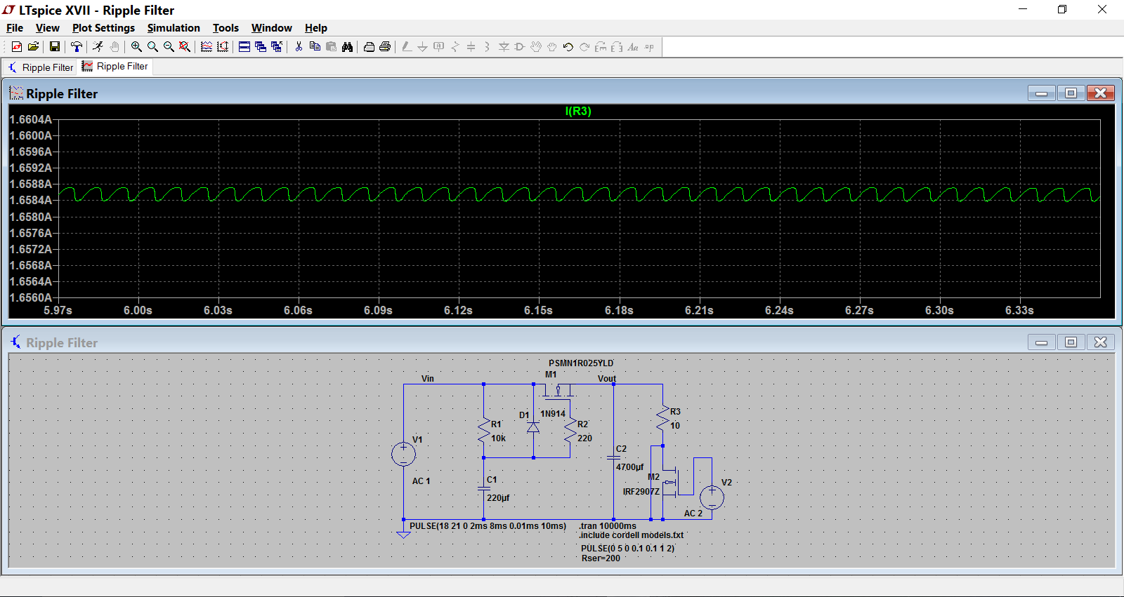

That's a good point. If we just go by Vgs and transconductance,
then perhaps something like IRFB8743
http://www.infineon.com/dgdl/irlb8743pbf.pdf?fileId=5546d462533600a4015356605d6b2593
is worth trying (lower Vgs and even higher transconductance)
Dennis
For lower voltage circuits, the PSMN1R025YLD with 1mOhm Rdson may even be better?
http://datasheet.octopart.com/PSMN1R0-25YLD-NXP-Semiconductors-datasheet-62336464.pdf
http://www.diyaudio.com/forums/soli...asy-capacitance-multiplier-3.html#post4855716
Here is Mooly's sim for 1.7 amps steady state:

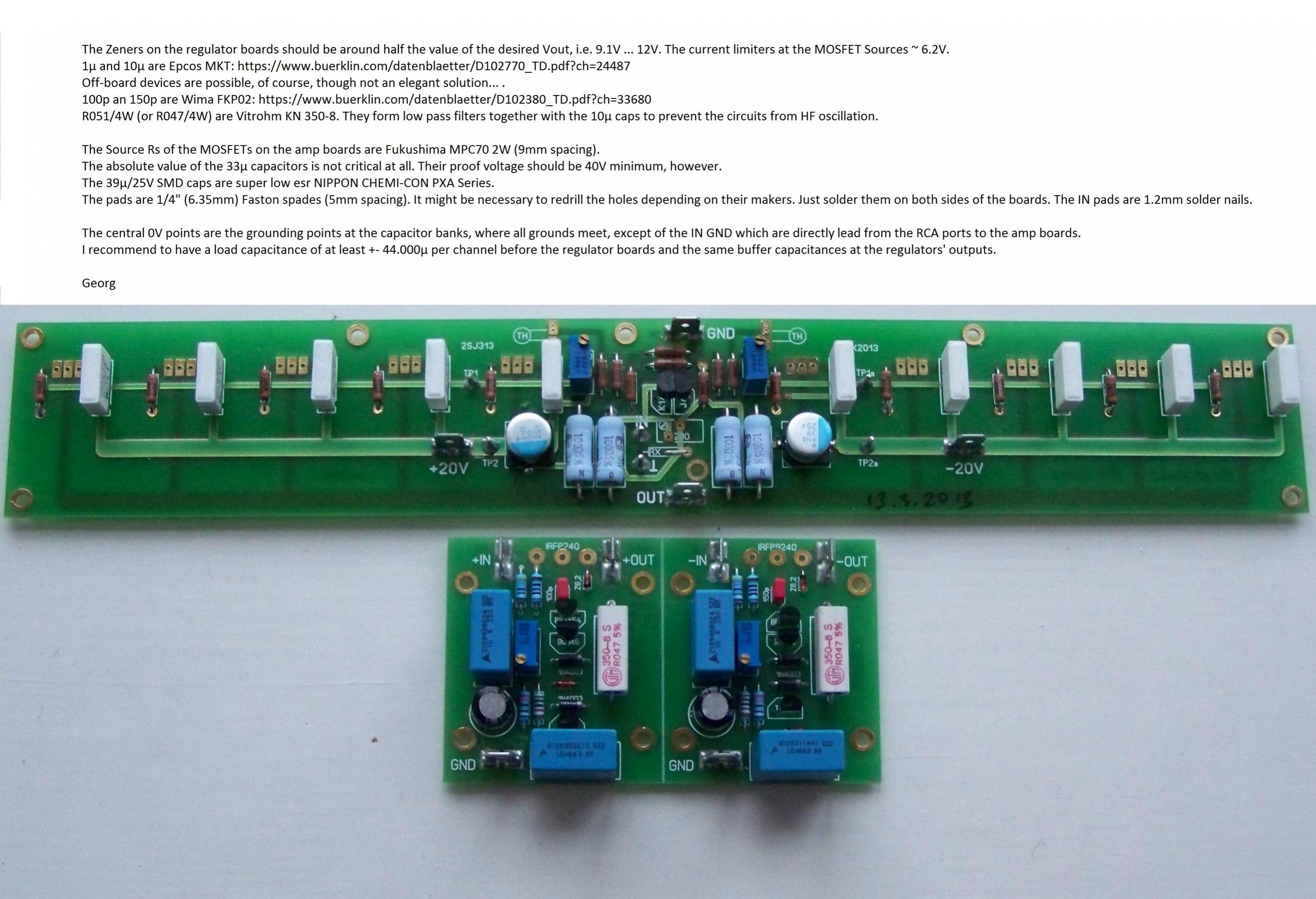

Could someone look through my attached BOM? I pieced it together from the main F5 thread, and some other sources, but I'm not sure of some of my part selection. Especially the source .33R resistors. Someone recommended the Fukishima MPC70, but I can't find them. I'm looking for something readily available on Digikey or Mouser. Also, if anyone has any other recommendations for resistors, I'd love to hear.
My other question is that I was going to use a Shunt style stepped attenuator, so I was thinking of using R1 as the series resistor of the attenuator, and R2 as the shunt. R1 would be about 10K and R2 would range from 50R to probably 15K. Any issues with that impedance-wise?

As koja said above, the increased degeneration resistors from 0.47 -> 0.68 is all to do with the 'sound signature' - with 3 output pairs running at between 0.4 <-> 0.5A per device, the resistor can be a 1 watt components, but 2w one for comfort - suggest KOA for a 'softer' sound but many options
You might find benefit adding one of those C-multipliers after the Vicor supply too - best bang for the buck around
Attenuator - suggest you build the amp first, get it up and running, then play with attenuators - and this will be before the input gain stage (the 'prakit' project?) and will have it's own optimal settings - I've had great success with Uriah's 'Clone Note' for volume control and suggest a look ...

the current limit for a 2W 0r47 resistor is sqrt(2W/0.47r)=2.06Arms.with 3 output pairs running at between 0.4 <-> 0.5A per device, the resistor can be a 1 watt components, but 2w one for comfort
Three pair output stage allows 6.2A if the source resistors were working at 100% duty cycle.
But a push pull amplifier runs the source resistors between 50% and 70%. so your maximum output current will be ~9A to 12A
This is OK for a 50W into 8ohms amplifier.
I think for a 4ohms amplifier you need bigger resistors or lower value resistors to reduce the dissipations.
You should not size the source resistors based on quiescent currents alone.
MPC74 should be a little better (low distortion type)Especially the source .33R resistors. Someone recommended the Fukishima MPC70, but I can't find them.
If you really want them, drop an email to this company in Taiwan https://thlaudio.com/indexE.htm
They do have them in stock
Using Nelson as an authority, with 0.47R as source resistors, peak current is about 3.5A for ambient 1.5A - for 0.68R's, this reduces to about 2.5A peak but assuming the higher value, the power thru each source resistor will be about 1.2A X 1.2A X 0.68R = approx. 1W, and this is peak value so a 2W source resistor is perfectly adequate.
My 0.68R 2W ones have been doing good service for the last few years with the amp (original F5juma Mk II version) biased at a bit under 1.5A and the resistors only get hot in mid summer - if you use the Caddock mp915, they did get hot but are only rated about 1W but their bigger brothers, the MP930 that are rated about 2W (@ 40*C derated) just got quite warm (not my favourite in this cct but readily available) - so you can relax a bit on the power ratings recommended by some people - if it's a problem accessing the values, try 1R0, 2W in // with 2R0, 1W for the 0.68, etc, etc
From memory, Passlabs still use Panasonics power resistors - maybe this is good enough for you?
Mouser keep a variety of Koa (Speer) and have carbon's, metal film, met oxide, planar, smd, etc - you can use the bigger 2W smds by attaching copper wire legs - be creative!
I use Issabellenhutte when values finalised but hard to get, or make my own with Manganin wire but a bit of a PIA.

Thanks for everyone's feedback and for this: https://thlaudio.com/indexE.htm
I think I'll pick up the MPC70's from there, and go with the 0r68 value as well.
I'm shooting for the most "relaxed" sounding version I can get from the F5 topology, and reading the main F5 thread, it seems lowering the feedback can help.
If I go with one 100r resistor in each feedback location instead of two parallel, do I need to change R3 and R4 to 0r22, as is mentioned in the main F5 thread?
Also, if I go with just one 100r resistor, would I have to increase the wattage of that resistor to more than a 2W resistor?
