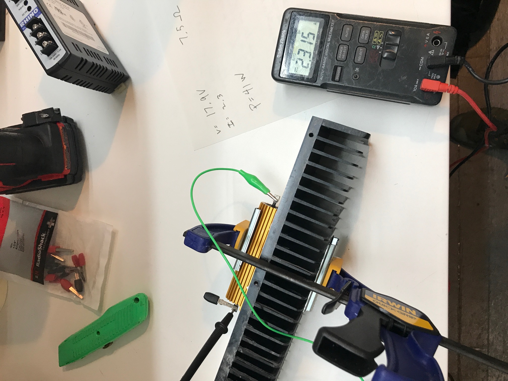

Also, did some disippation tests with my heatsinks. I was aiming for 3 pairs @ 350ma at 19V = ~40 W. But I seem to be a bit light on the sinks.

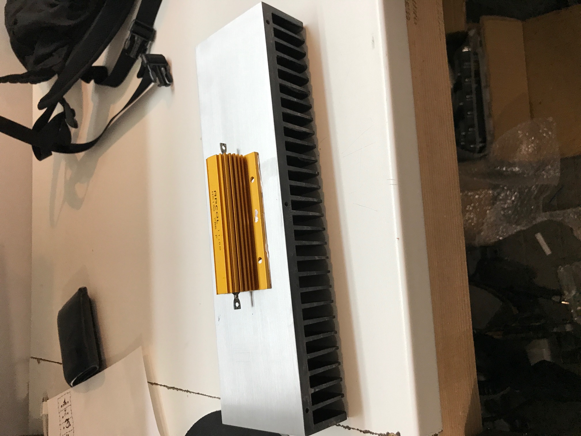

I mounted a power resistor to the sink and ran 41w through it. Bloody hot! After 1 hour, I can only hold my hand on it for 3-5 seconds. I think it's too hot.
I did some other tests, and it seems like if I can get to around 30-32 W I should be fine.
Sooo, what would be the best sounding compromise?

1) will work all right, be patient in adjustment process, wait for it to get hot and check once more when you put the lead on the case.... what would be the best sounding compromise?
1) Run 3 pairs @ 300ma @ 18V
2) Run 2 pairs @ 400ma @16V
3) other suggestions? ...
2) not a great idea
3) get bigger heatsink

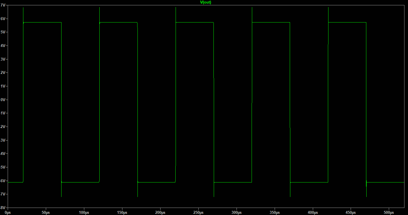

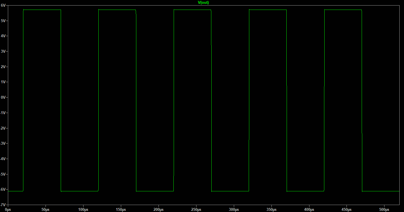

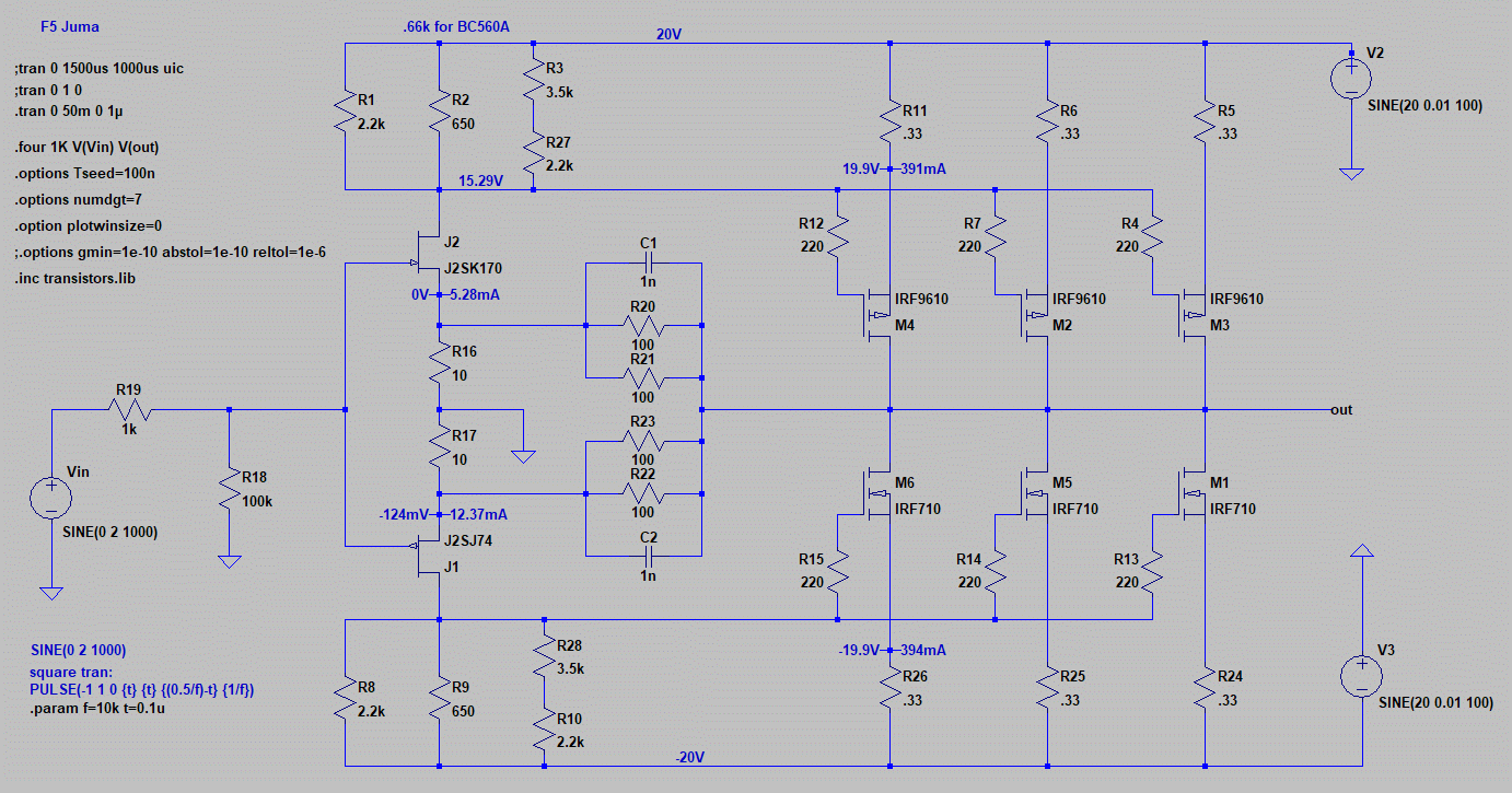

I've simulated the circuit in Ltspice, FFT looks very good but square wave had some ringing.
So I added some compensation caps over the feedback resistors (C1,C2), result: perfect squares
But this is only simulation, what's your advice about adding such compensation caps ?
In the sim I used the 9610/710 because I didn't find any models of the 2SK2013/2SJ313
Danny
