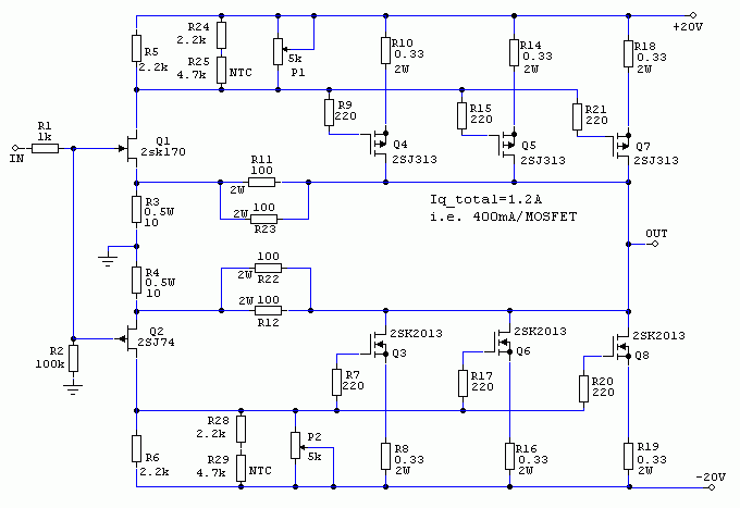

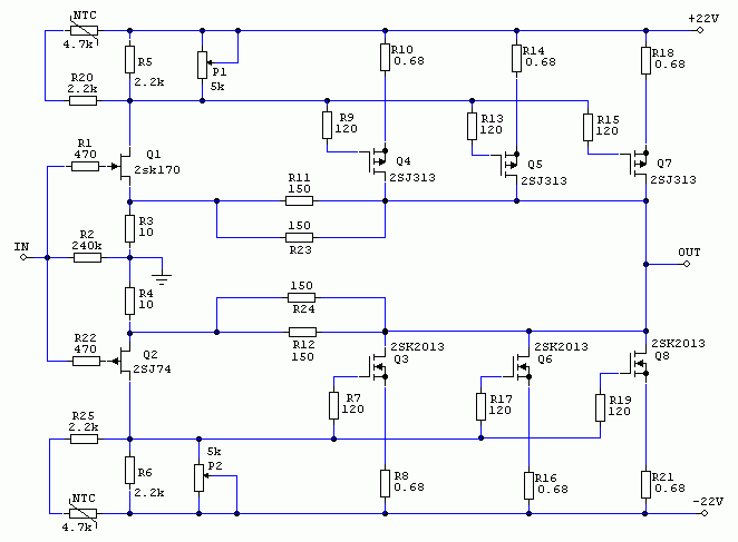

Hi All,
So I have finally decided to build my first power amplifier. This seems to be not only the most enjoyable and rewarding but also the easiest way to enjoy high quality music. I do hope that this will be a significant upgrade from the Denon RCD-M38, which honestly is decent enough considering its constraints.
Anyway, I have chosen to build Nelson's F5 upgraded with Toshiba MOSFETs.
Juma has actually published two versions of this upgrade in Novi amp sa 2SK2013/2SJ313 - Solid State - diyAudio.rs and Novi amp sa 2SK2013/2SJ313 - Page 3 - Solid State - diyAudio.rs respectively.
I have attached schematic for convenience.
Reason I'm posting is that I have not come across an analysis of the MkII version other that with respect to feedback resistors and 0.68Ohm Drain/Source ones. There are more changes between Mk I and II : higher supply voltage, different Gate resistors, and different voltage divider on the input.
I have decided for the MkII version, but to be honest I cannot not explain why. Probably just because this is considered to be an "upgrade".
Just in case, I have added receptacle pins to my PCB which are connected to feedback and 0.68 resistors. This way I will be able to experiment without soldering back and forth, also measurements will be simpler.
I was thinking if someone would be willing to address and discuss differences between MkI and II, this could be also a convenient one-stop-shop for other DIYers to follow up.
Piotr.

Differences are so small that you can hardly call them "different versions". Small changes, at most. First one sounds a bit more lively and the second is a bit more tame.
From practical point of view, the second one is slightly more thermally inert (less difference between cold and hot state).
I like the first one more, some prefer second. Anyway, it's about nuances...
Good PSU is a must (no cheap/chinese capacitors and transformers allowed).
If you can choose, input JFETs with a bit lower Idss (4-5mA) are preferable but it's not a very big deal.
20V or 22V rails - not important except that higher rails will provide more voltage swing i.e. output power.

Thanks for replaying. From previous posts I recon that those differences are related to feedback and Source/Drain resistors anyway, so it's good that I'll have an easy way to experiment.
To be honest, I am done with doing things in mediocre ways, so I'm going to have 0.1% and 1% resistors with good literature drift and Cornell/Nichicon electrolytes for the PSU. Was even thinking about dual mono setup, but this then becomes expensive.
