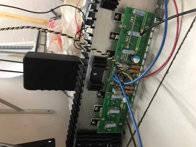

Working
So I got both channels fired up, and working just fine!
Biased up and ran first with no load for a few hours on each channel, then connected to a test speaker. So far so good!!
Next I need to order a few more parts for the enclosure, and will do some more tests shortly.
The only thing of note is that I had to change R5 and 6 to 4k7 from 2k2 for it to bias up correctly. I read that from the main thread, so I think that is not a big deal. Once I made that change, biasing to within 2mv was not a problem.

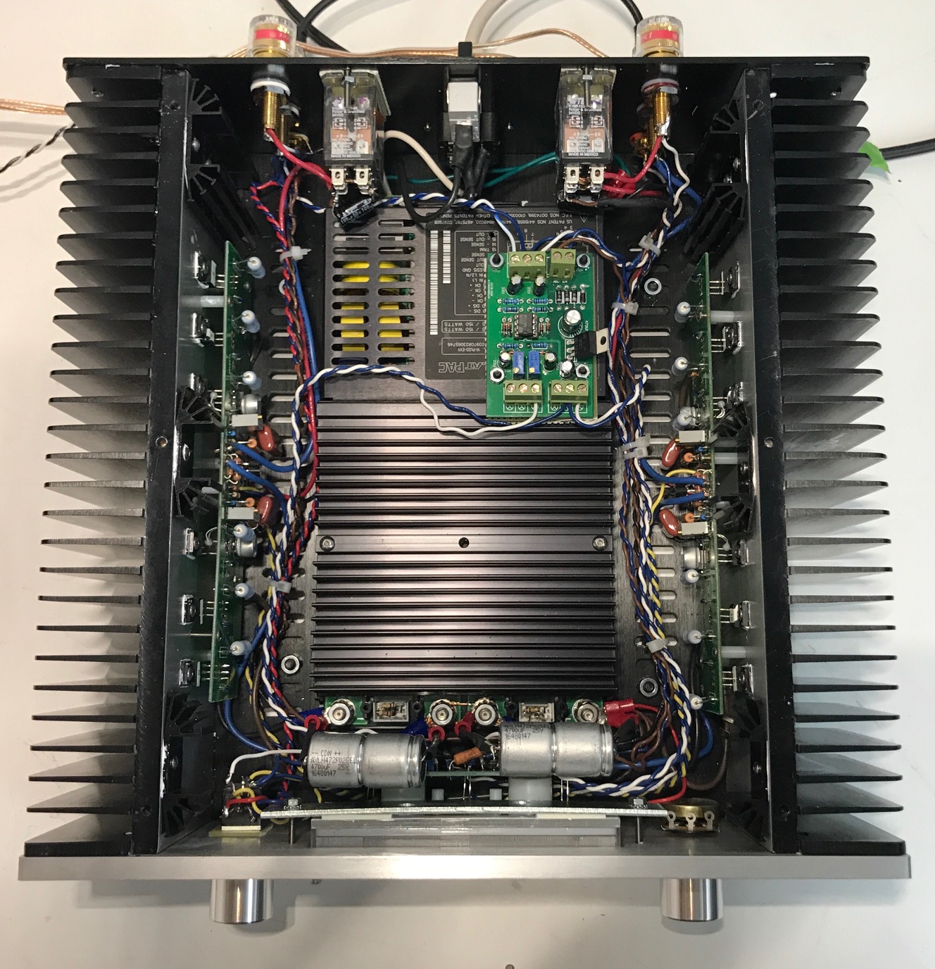

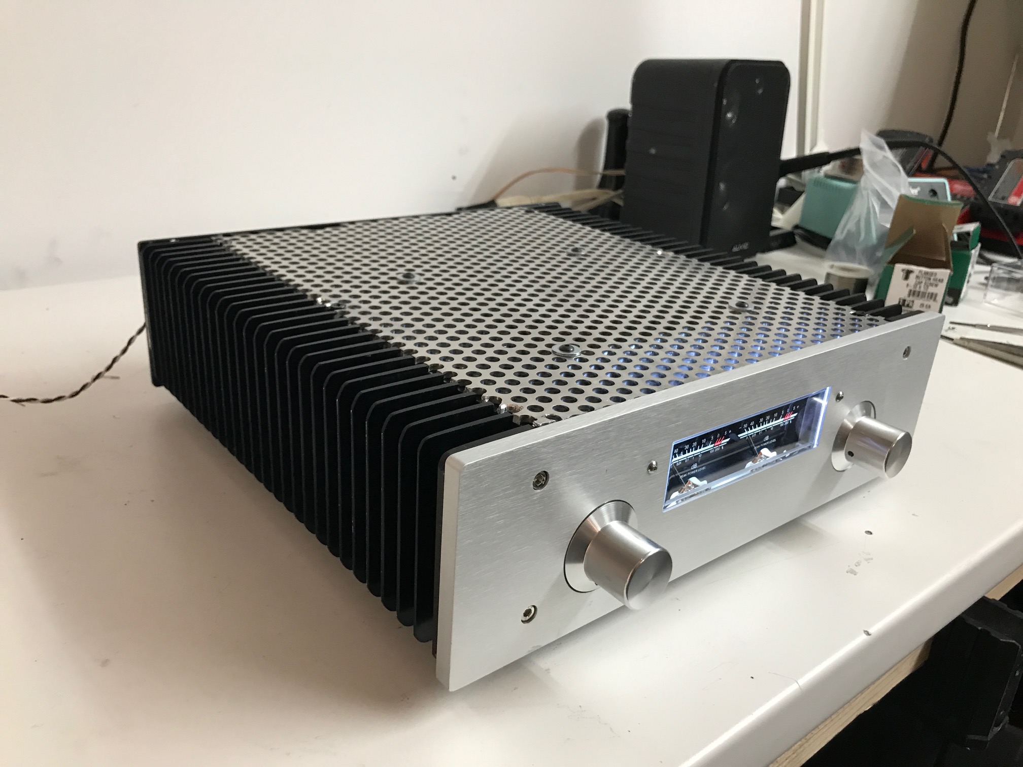

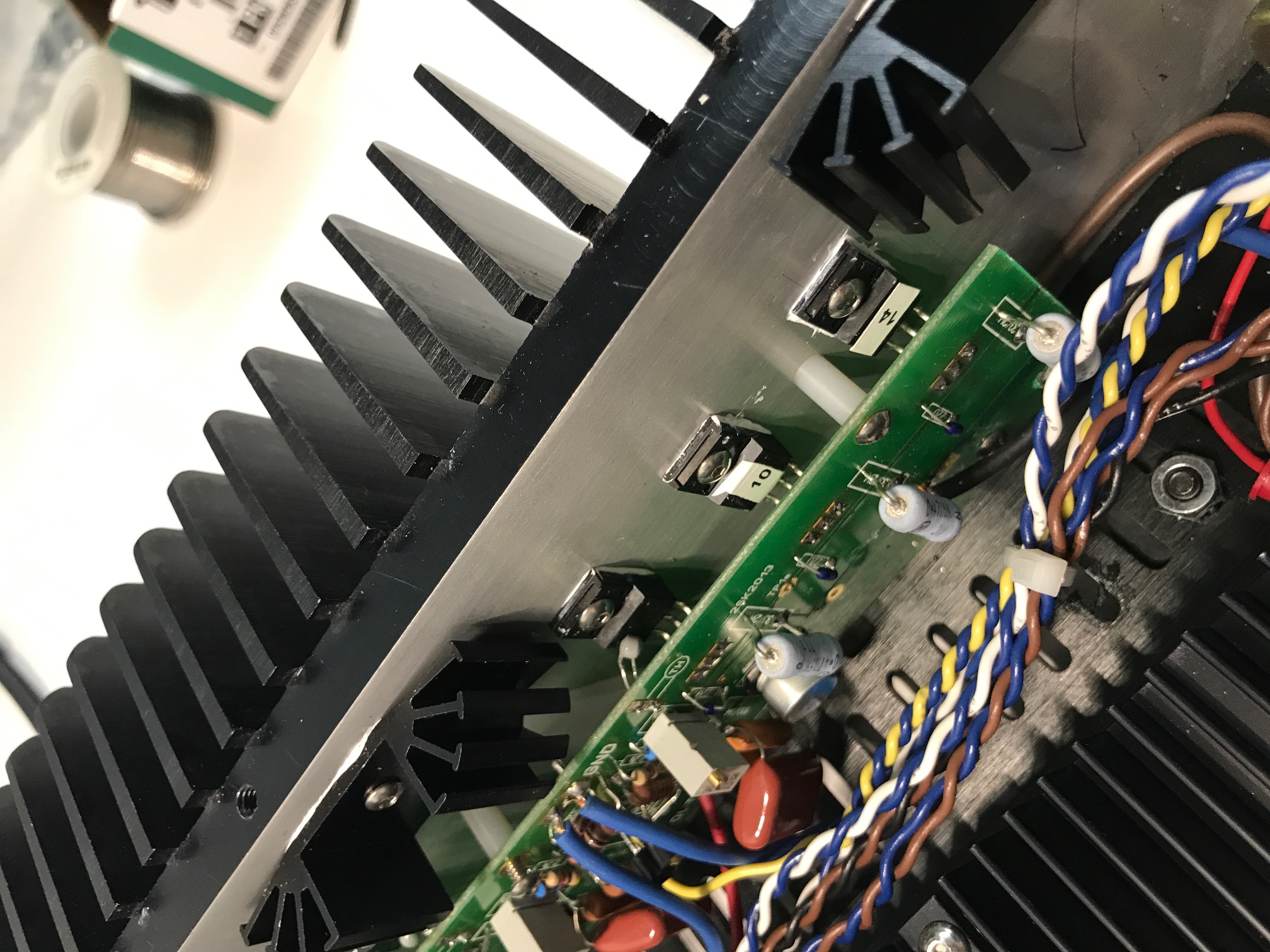

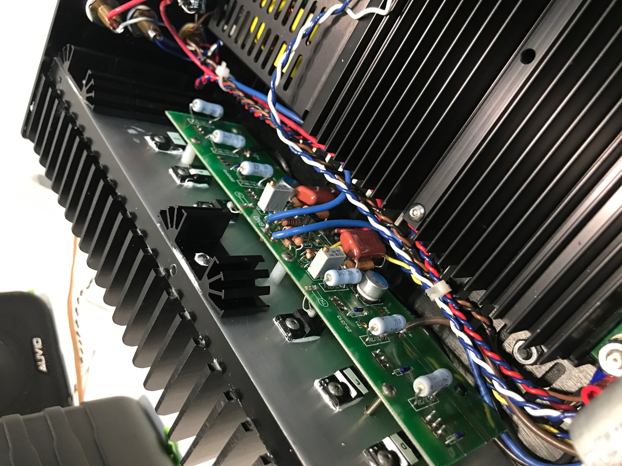

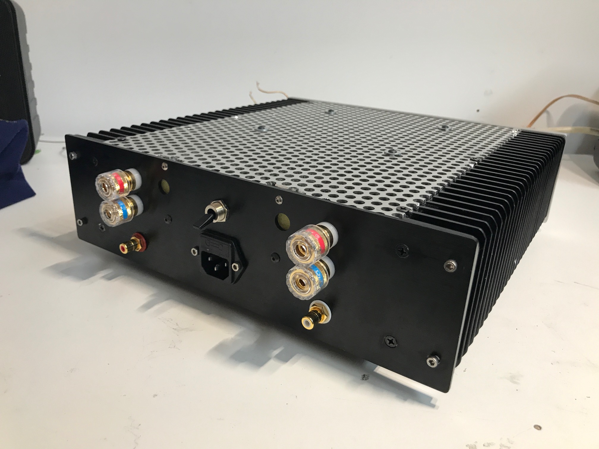

Finished!!!

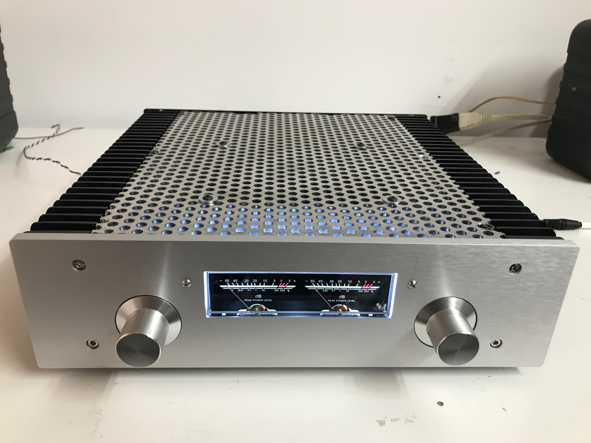

Finished, and sounds great! I've only been listening to it on real speakers for a few hours, but it sounds pretty great so far. Here are some pics.
A few tech details:
I'll keep it running for the next few days, and post some impressions later. Thanks Juma for posting this really interesting variation and for yours and everyone's help!
A few tech details:
- 15V, 3 pairs @ 400ma. Exactly half the heat dissipation of the real F5
- Using a SMPS, absolutely silent. Ears up to speakers and can't hear a thing.

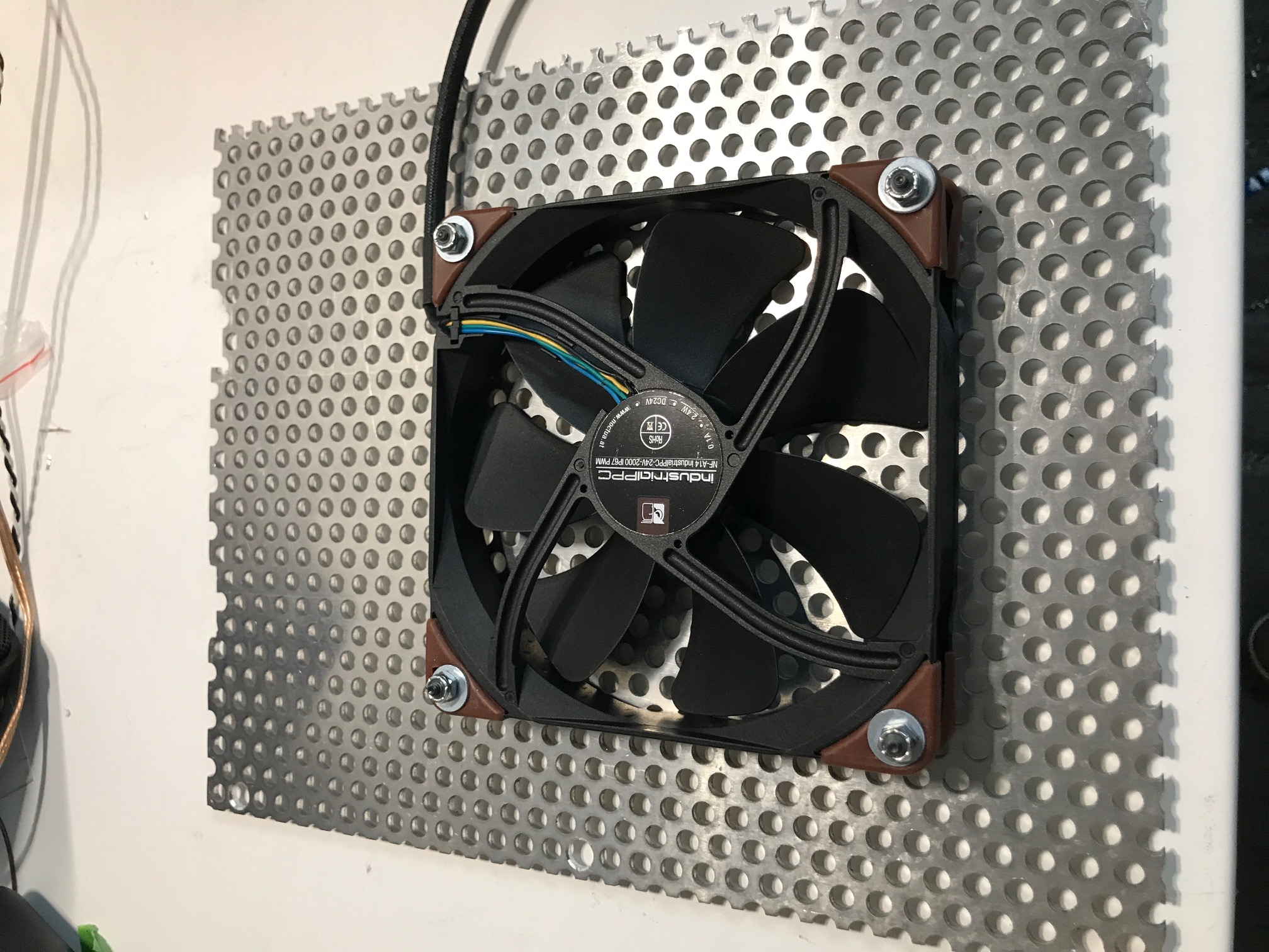

- Amp running a bit hot. Nothing to totally worry about, but I added a 140mm fan running @ 8v. I know the perf metal is blocking half the air, but it's amazing how much the fan cooled things down- even though not blowing on the heatsink fins.

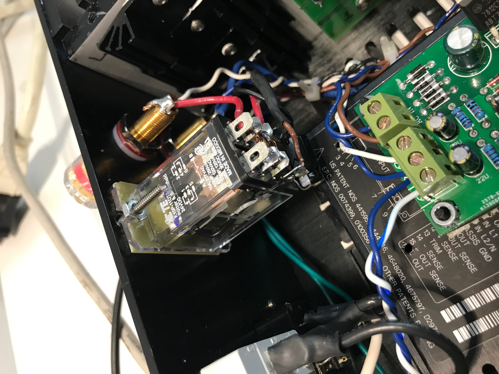

- Since I'm using a dual SMPS, my only fear is what happens if one rail goes for some reason. So I used a relay on each speaker, where I ran +15 to one end of the coil, and -15 to the other, with a resistor to knock the voltage down to 24V across the coil. This way, speakers are only connected if both rails come up. Pretty remedial speaker protection, but seems to work pretty well.
Great job Anchan, glad you like it ! Looks nice and compact.
As for checking what happens if one rail goes down - connect the 4R-8R power resistor instead of speaker at the output and make sure that you have a fuse in SMPS's primary side. Then disconnect one rail and observe what happens at the output. IME, you'll get strong distortion (because only half of the output stage is working) and the DC voltage at the output will be less then 1V so no real danger for the speaker.
The same happens if the power rail gets shorted to ground plus you'll lose the fuse...
Thanks! It's about as compact as possible. Another cm to two shorter, and I think I would have run out of room, and heat! But it was just enough.
Didn't realize that about the rails. Good to know. Maybe I didn't need those relays after all. Gives a nice delay-on though for effect.

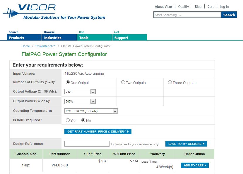

- Question: I have a 10K volume pot at the input of the amp as well as the usual 1K / 100K input resistors. If I put the filter before the volume pot, that should be fine right? I'm not certain if the volume pot or other resistors interfere with the RC calculation.
- One other question: Why don't more people use (good) SMPS's. Not the noisy crappy kind. But there are others. The unit I used measured 25mv ripple @ 250kHz, absolutely nothing below 100k. No huge transformers, cap banks etc. Also, even under intense load, the voltage doesn't budge even 100mv. What could be better?
http://www.vicorpower.com/flatpac
You can pick them up on EBay all day, cheap.
Dear Anchan:
Interesting info on the SMPS there.
What make and model are you using ?
Best regards,
Claas
We surely don't have same criteria about "cheap"
Your link shows flatpack SMPS 24V/200W with a 1 unit price set at $307 and 2 x 24V/2 x 200W dual output unit costs $567. That amount of money buys a couple of great linear PSUs ...
