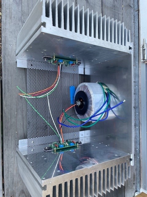

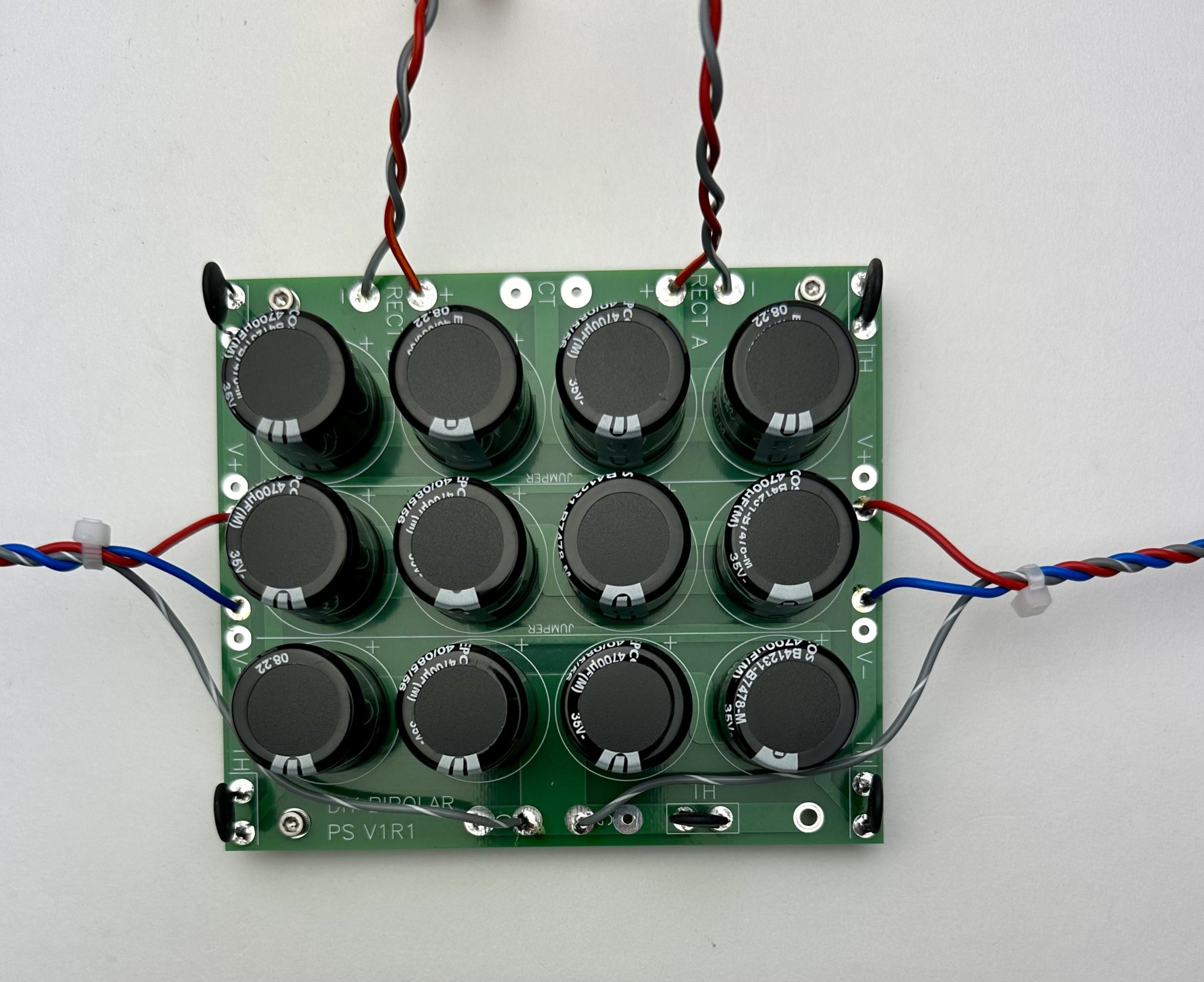

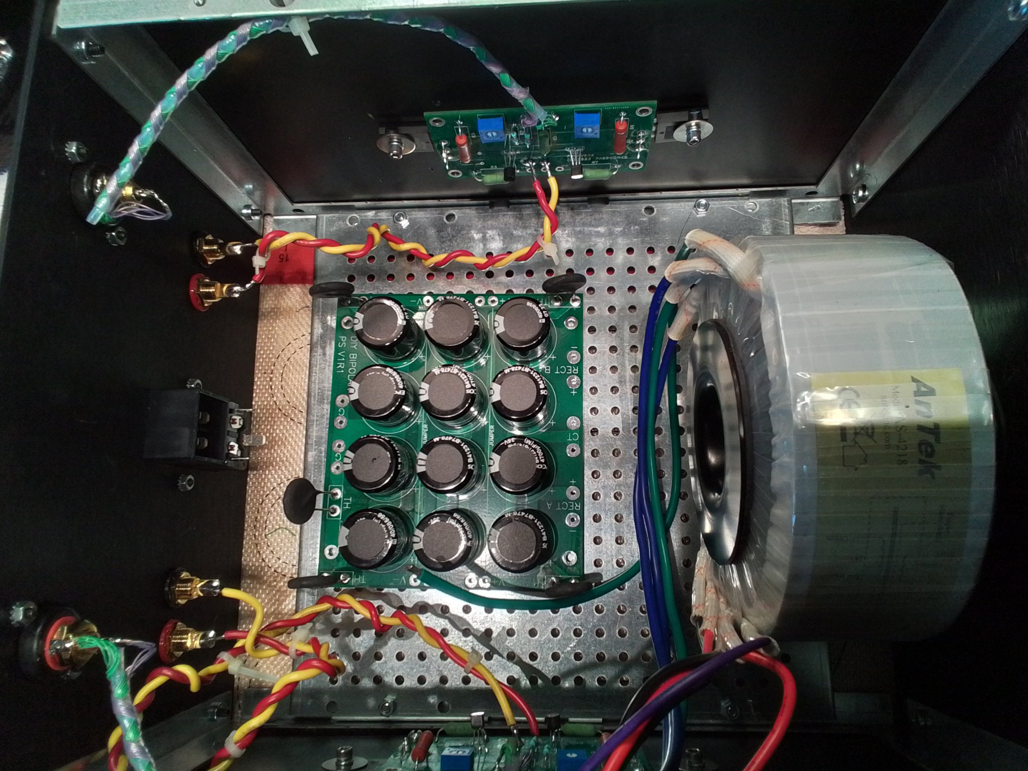

Slowly building the f5m and am confused with the the revised ps board (V1R1) connections. I've been referring to 6L6's excellent photos throughout but those use the original ps board. Could someone share a photo of their wired completed V1R1 ps board please. I reviewed NP's revised schematic but it isn't clicking with my brain box.
I don't have pics to offer you, but where are your rectifiers?
Connect primaries properly to mains. See various methods in other build guides or forum member pics. Edited to add - note that the thermistors for inrush current limiting are on the PSU PCB if you're referencing other common First Watt PSU wiring examples to connect mains to your primaries.
Connect secondaries properly to rectifiers.
Don't connect amp boards to PSU PCB yet.
Don't connect rectifiers to PSU PCB yet.
Check DC output of the rectifiers to ensure all is good using any one of many proper check methods / safeguards (DBT and/or Variac being common).
Once you have that all ready to go, post back.
All the wiring above - could/should be identical to the previous board revision (I think).
Others will surely have more / better ideas and may have some photos.

Haven't attached the rectifier or PS board yet, just laying it out for now while I wait on the terminal strip and safety cap to arrive. I'll check the rectifier output first as advised, I have a small variac for that purpose. Glad you told me to check that first as I was going to connect the PSU to the amp boards today but will delay that. I spend a lot of time reviewing other's builds, relevant postings, etc. to build my knowledge and understanding, not just paint by numbers. It's a steep learning curve for me being new to DIY, just very appreciative of this forum. Will post back in a few days, many thanks!

You don't have to do it that way, but to give credit where credit is due, I think it was Ben that continues to stress to check one step at a time, particularly on the first run. When there's even the slightest of chances that a reverse voltage results in big caps going kaploowee, or a very large mains surge, or breakers tripping b/c I got primaries wired incorrectly, I try to take every precaution.I'll check the rectifier output first as advised, I have a small variac for that purpose. Glad you told me to check that first as I was going to connect the PSU to the amp boards today but will delay that.
So, after sorting and identifying each of your primaries and secondaries you may...
Wire primaries to mains => Check AC at secondaries / pause or move on as needed. I'd use 6L6's gorgeous pic from earlier in the thread as a reference. I would remove the thermistor and leave the safety cap.
Wire secondaries to rectifiers => Check DC at rectifiers / pause or move on as needed.
If any of that doesn't make perfect sense, I can try to explain further with a diagram or two (which should be validated by an actual expert)...
Mainly... have fun!
Edited for clarity and a link - here... https://www.diyaudio.com/community/threads/f5m-kit.408290/page-41#post-7628684
For all - edited yet again - I read enough to where I THINK the new PSU boards don't necessitate using another inrush current limiting thermistor "off board", in addition to the ones on the board that serve dual purpose, but please correct me if I misinterpreted.

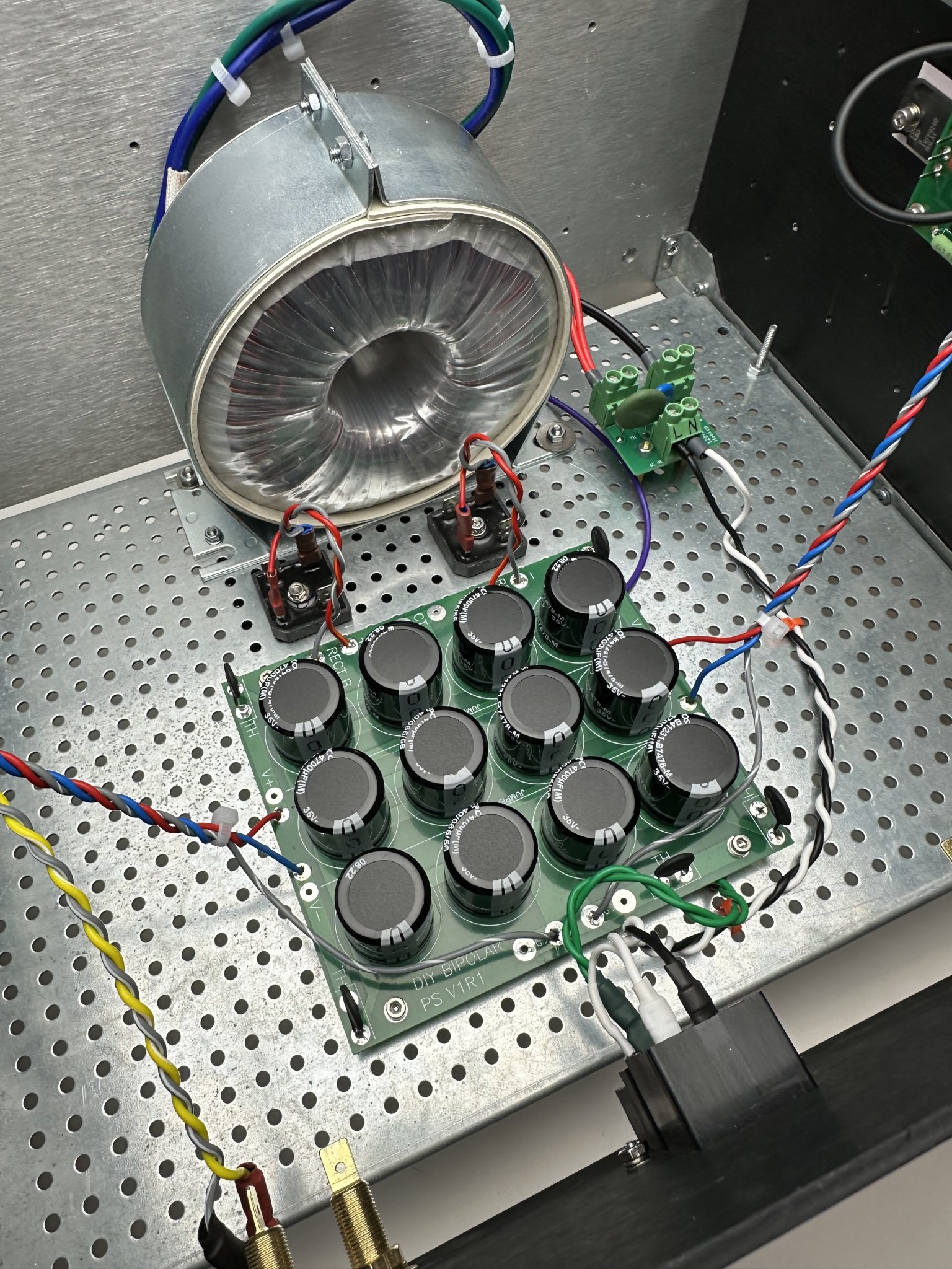

6L6's post #809 was what made me order the terminal strip, it seems easier than trying to work the thermistor and 3300 pf safety cap into the tight confines of the IEC module. Since I'm using the Antek 4218 I'm assuming the thermistor would be a good addition as 6L6 used?
Noting to do with me, Nelson put it on the schematic. So building it as designed is always a great place to start.
