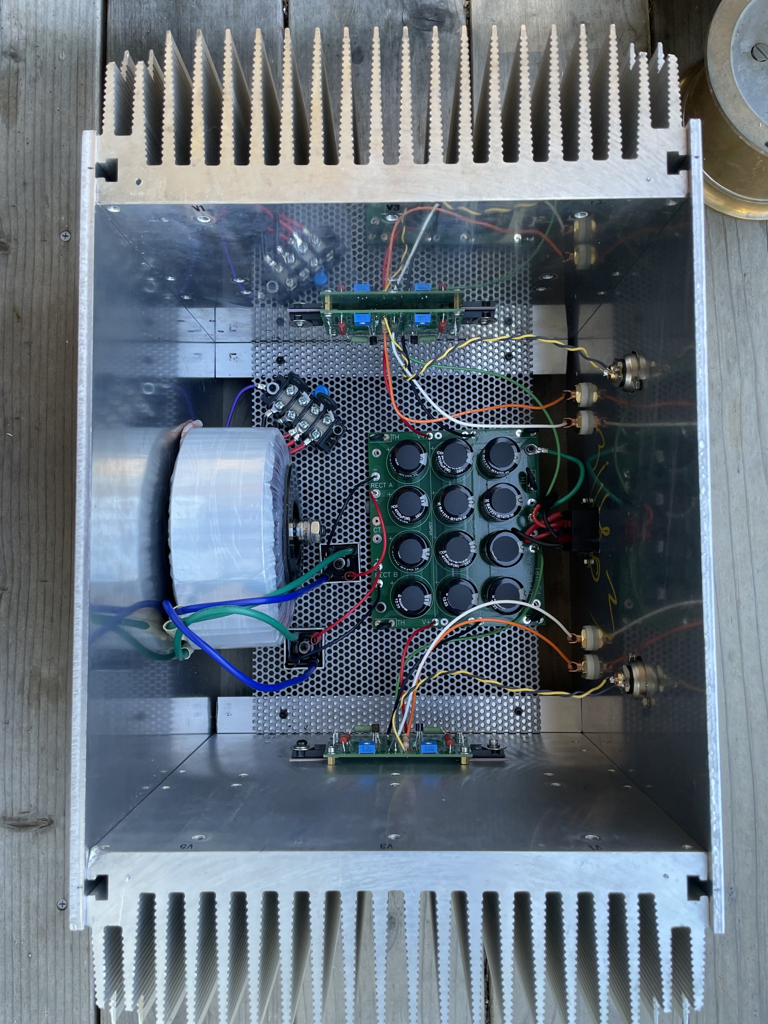

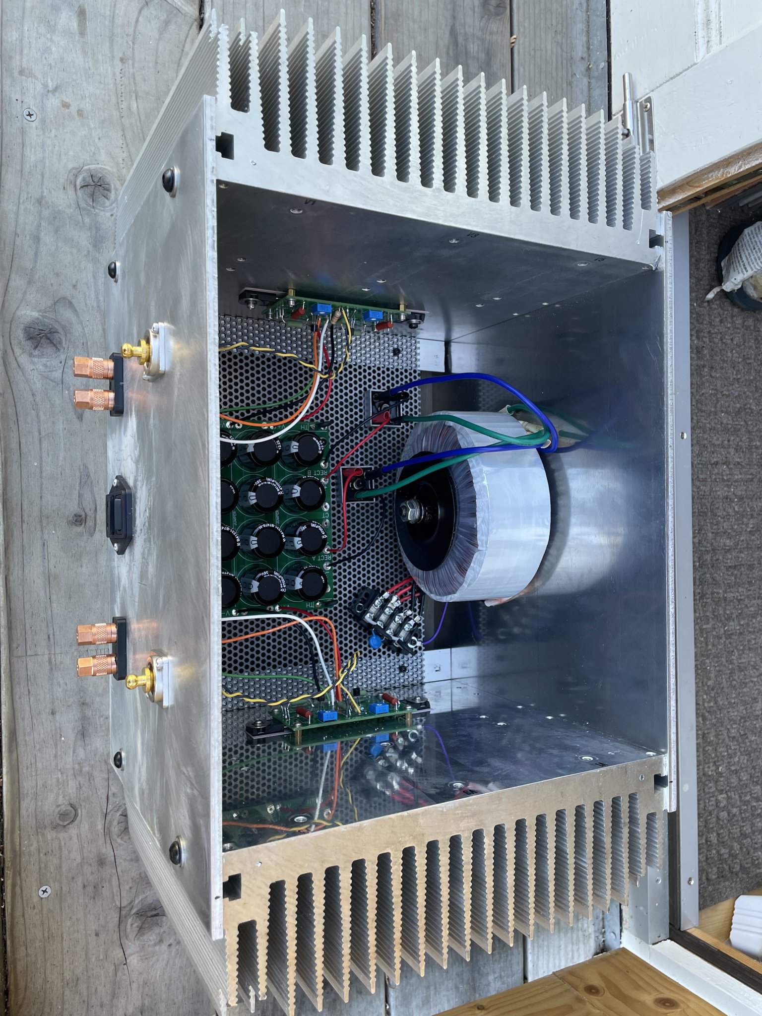

I wish Modushop offered heatsinks like those. The heatsinks for that case were cut from two 11"x11" R-Theta model 65340. Back in February of 2003 there was a group buy for those heatsinks. I bought 8 and built an Aleph 2 clone. As time went on some of the participants in that group buy offered their units for sale and I purchased four more. Two of them went into the case shown above, the other two into another case posted here:

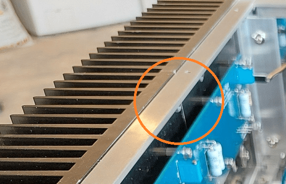

You cut each 11" x 11" heatsink into 4 pieces or 2 pieces? I am asking, because eyeballing it the case looks around 5.5" - 6" tall, and I see a small mark/gap in the middle indicating that two sinks are being held/joined together - zoomed image below.
What did you use to cut this hefty heatsink with long fins?

@zman01,
I cut each 11" x 11" heatsink into 2 pieces after removing a 3" x 11" section, cut along the length of the fin, from each. I wanted the depth of the case to be around 15.75" or 400mm, the same as the Modushop cases I own.
To cut the heatsinks I used a Freud 10" saw blade for aluminum and non-ferrous metals.
