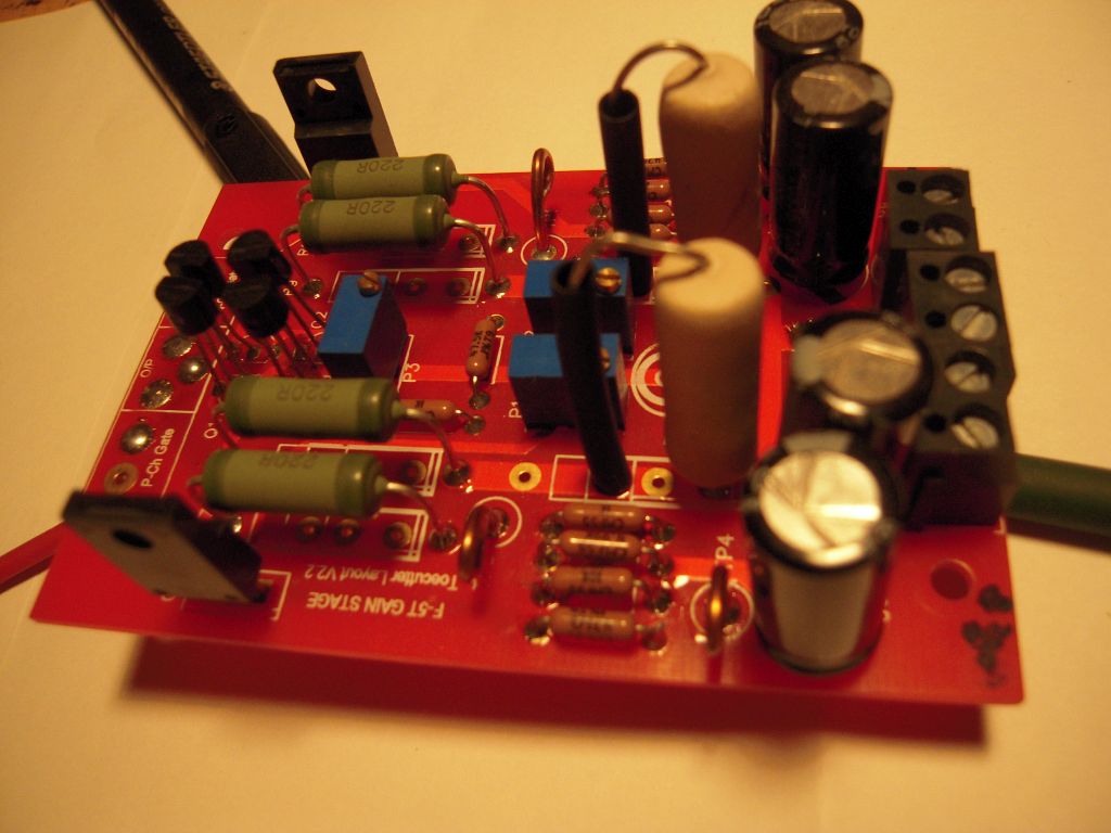

Ordered a matched octet of Jfets for cascoding in the FE boards and all the other transistors and diodes as well as the boards. Two of the four FE boards will remain unused.

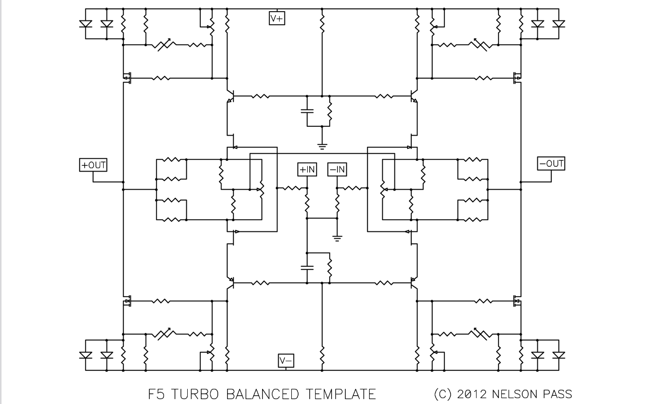

Hello starcat,
if you want to build a balanced version of the F5TV3, then you will need
2 frontend - boards per monoblock and minimum 2 N-channel- and 2 P-channel-
outputboards per monoblock.

I am not sure I understand your question. A monoblock is not balanced by nature. It's just whether you choose to have each amp channel in its own chassis. Many people build monoblocks for standard First Watt clone amps as an example. Most are not balanced.
If you're trying to say that one balanced monoblock takes roughly the same number of parts as a stereo amp, and that you could easily convert a stereo amp to a balanced monoblock, then you're correct. However, you do wire them just a teeny bit differently.
See page 13 in the article for the schematic for a single channel of single ended V3. See Dirk's post and the article for the balanced config.
What do you want to build? You can certainly build the F5T v3 in a balanced configuration.
Either way, if you build the balanced version using common XLRs for your inputs, the hookup is. Pin 1: GND (or chassis) Pin 2: +In Pin 3 -In.
Is that what you're asking?

I have ordered two sets of the F5T PCBs which gives me 4 FE boards and 8 output boards. Should be set for the balanced mono blocks, right?
Optional, I could order one set more if I want to daisy chain the output boards (for 4 more output boards, 2 per mono block).
I have ordered as well an octet of the 8-11mA Toshiba JFETs, which gives me 2 devices per FE board. Optional, I would need another octet in order to cascade them in a balanced configuration (4 devices per FE board, total of 4 FE boards = 16 JFETs for cascaded balanced), right.

Yes, for a standard F5 turbo V3. (schematics on p.13 https://firstwatt.com/pdf/art_f5_turbo.pdf ). But that's not balanced.
Once you build it as balanced as in the form of template on p15, your voltage swing doubles.
Dennis, I see your point and you are right on doubled power output for balanced. With 45VDC rails it gets to 200Wpc, maybe more.

The calc is actually simple. A single-ended stereo F5T v3 using 2 FE and 4 output boards gets 100Wpc with an 800VA transformer and 45VDC rails. If that single-ended stereo amp is converted to balanced, it still uses the same 800VA transformer and rails and the same number or FE and output boards (but for a single channel, i.e. using both available channels for amplification of the + and - of the signal as balanced doesn't reference GND). Effectively doubling voltage swing, output power and slew rate.
