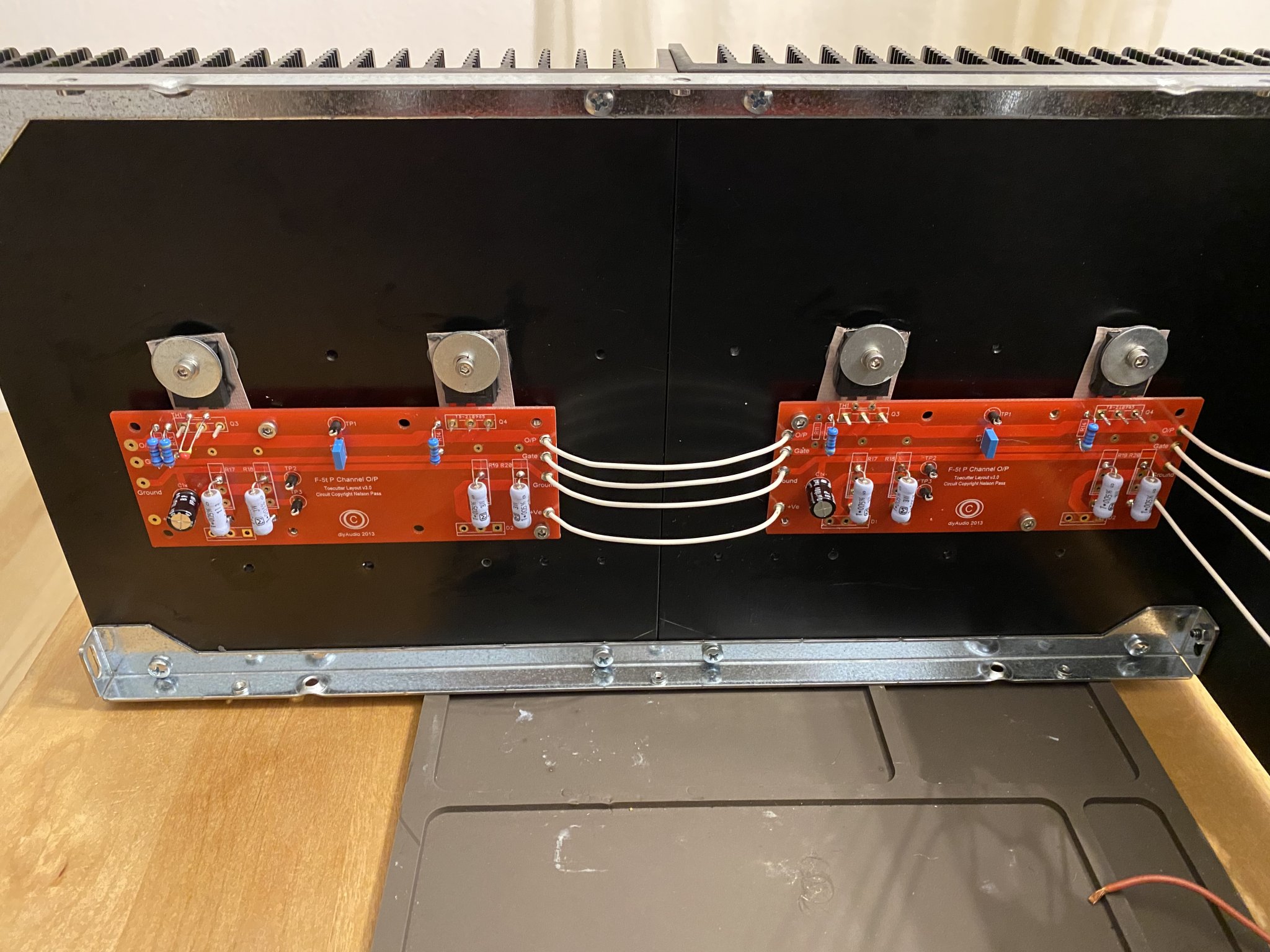

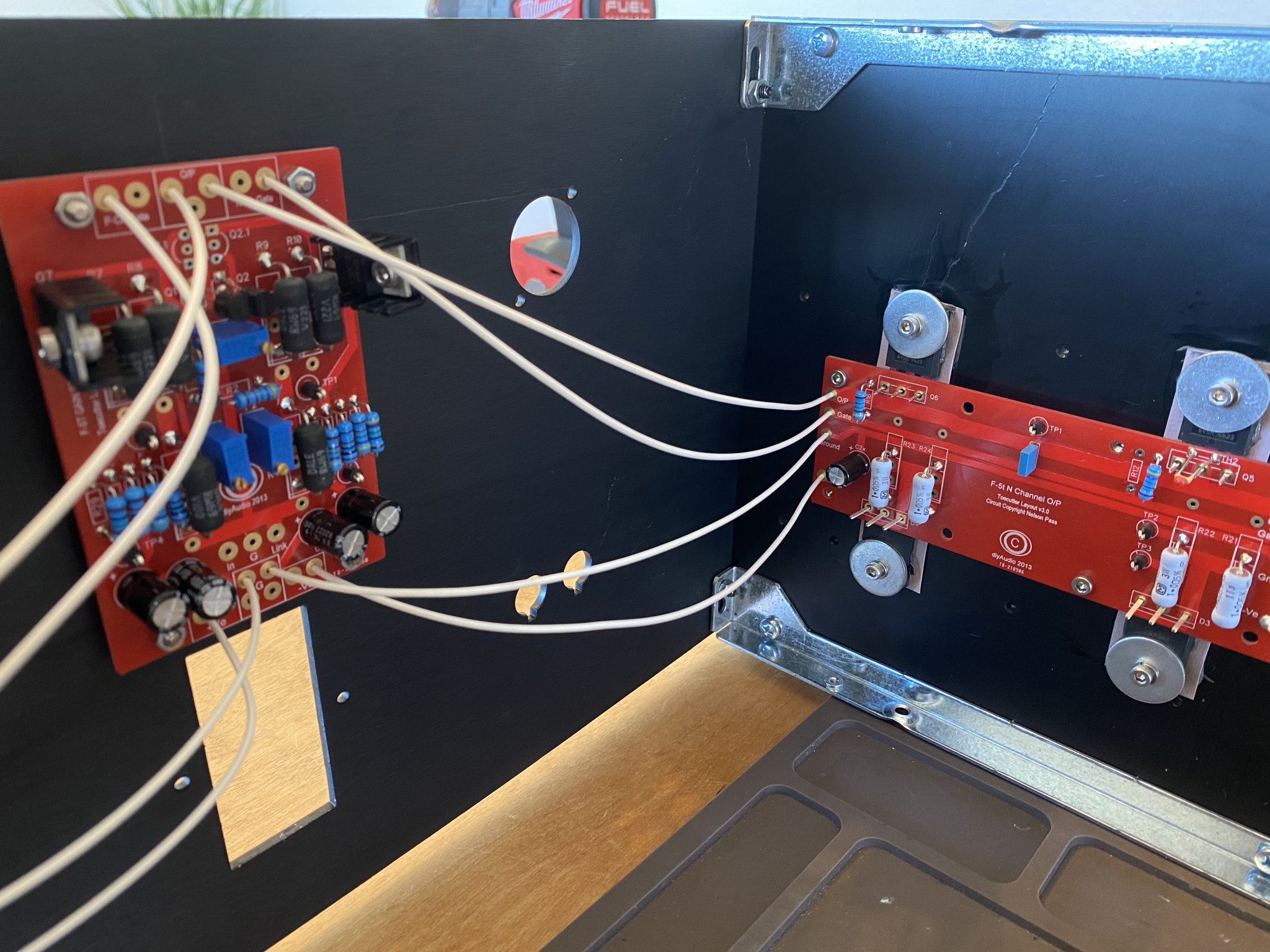

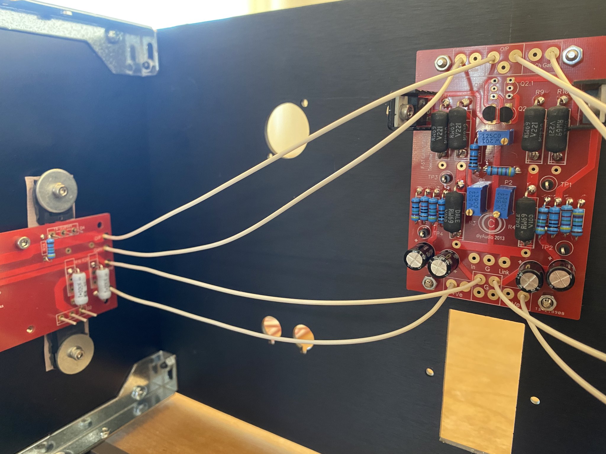

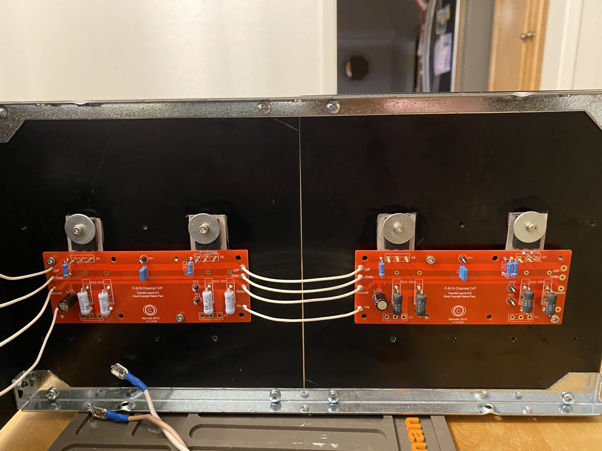

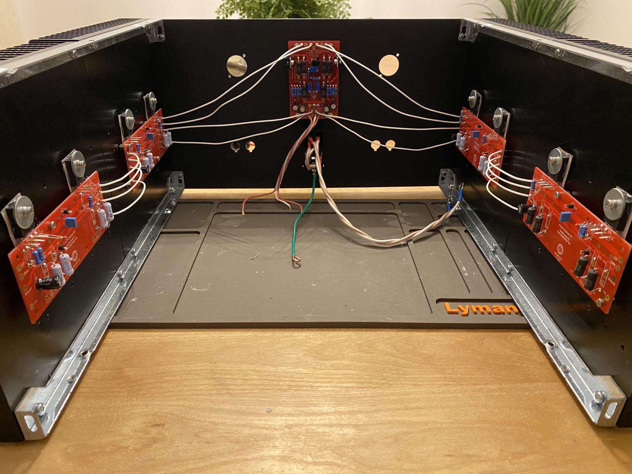

Hi all,
I’m making progress on my monoblocks and took a few pics to share and see if anyone saw any mistakes with the wiring between the front end and P/N channels before soldering.
Thanks!
Thanks!

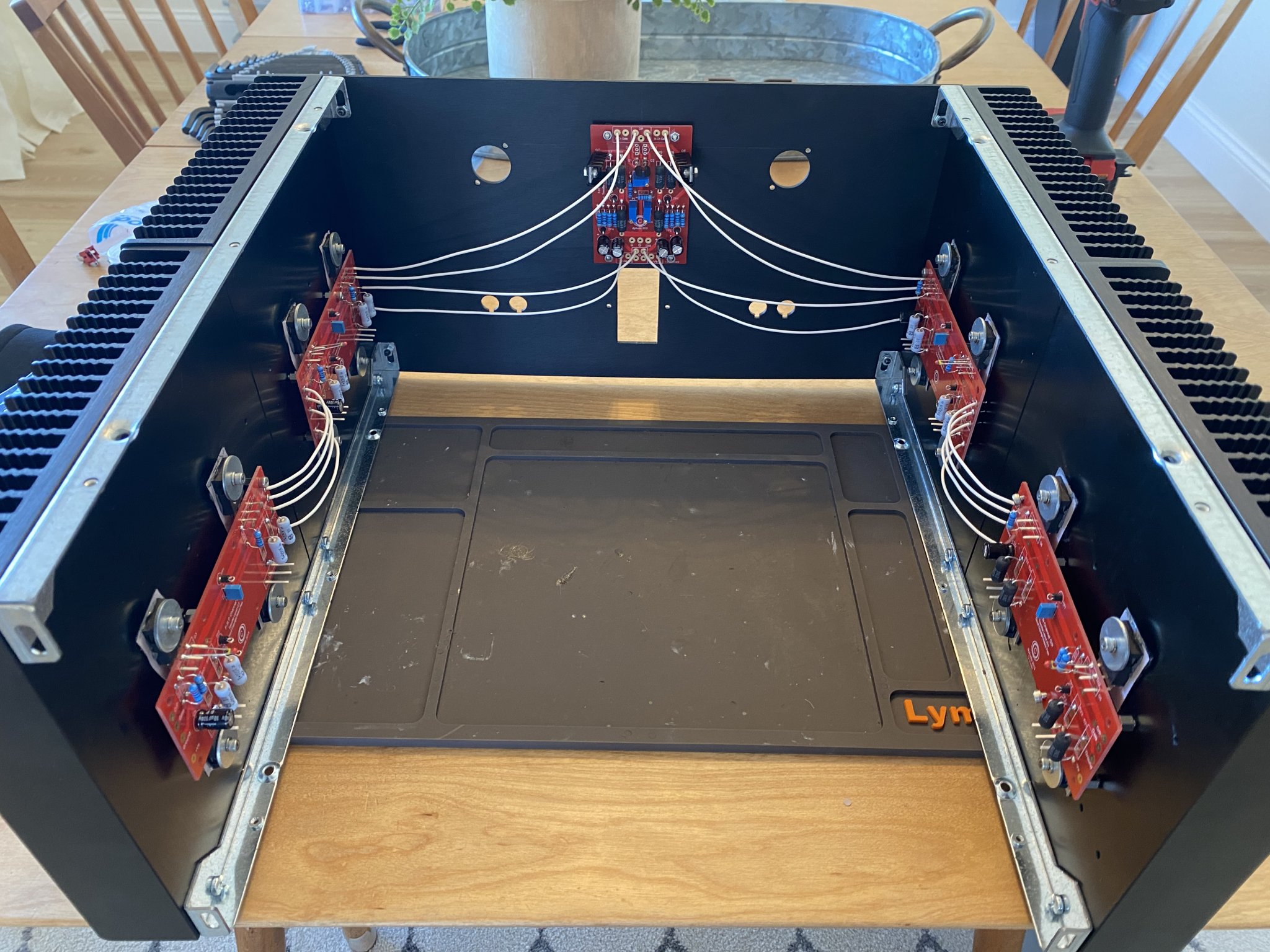

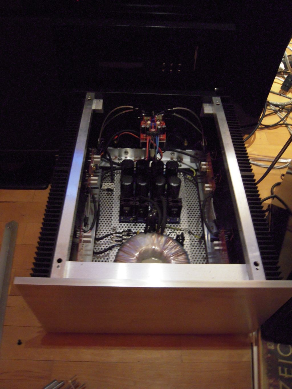

May I ask, are you not concerned about EM pick-up fly the front end board from the AC IEC input module? The front end board in your build is located very, very close to the body of the IEC module.Hi all,
Thanks!
I've been contemplating using the 5RU chassis as you used, but mounting the front end board on a platform above the PS board with a steel shield of some sort. After seeing your configuration, I am interested in your thought process that led to the location you selected.
Reference my pics in post 1435. My fe board is above the iec inlet and both my amps are deathly quiet. As long as you are about an inch above, should not be a problem. Also, most logical place since you want To be as far away from tranny as possible. Wire routing will be more important. One thing I did differently, which may give you another option, is that the +/-V and ground wires on my build connect to output boards directly from ps. This also allows those wires to be draped low in the chassis and away from binding posts and ac.
Since you have empirically determined it works, that is great and I will follow your approach! It does save me lots of headache in figuring out internal placement. I am going to use a speaker protection board as well so real estate is precious. I was planning to mount my transformer vertically at the front end of the chassis using a home-made bracket of 1/4" aluminum angle with one leg at 4". I think that orients the EM field vertically (as I understand it), and minimizes its intrusion into the rest of the interior volume.Reference my pics in post 1435. My fe board is above the iec inlet and both my amps are deathly quiet. As long as you are about an inch above, should not be a problem. Also, most logical place since you want To be as far away from tranny as possible. Wire routing will be more important. One thing I did differently, which may give you another option, is that the +/-V and ground wires on my build connect to output boards directly from ps. This also allows those wires to be draped low in the chassis and away from binding posts and ac.
Halauhula, I don’t want to discourage you from trying to mount fe board on tall standoffs above psb. It’s actually a neat idea and could result in shorter, more direct wiring. I was merely pointing out that back panel did not create any noise issues for me, so it definitely “works”. I recall seeing other builds with same back panel mounting while reading through both f5t threads during my build. Best of luck
Understand. Creating a platform, however, has its own set of issue so it is nice to know that an easier alternative exists! Thank you so much for your information.Halauhula, I don’t want to discourage you from trying to mount fe board on tall standoffs above psb. It’s actually a neat idea and could result in shorter, more direct wiring. I was merely pointing out that back panel did not create any noise issues for me, so it definitely “works”. I recall seeing other builds with same back panel mounting while reading through both f5t threads during my build. Best of luck
Hello Halauhula,
hello algg,
I never had a problem with my F5T-Monoblocks and the frontendboards above the AC-power-inlet.
O.K., my frontendboard is 'flying' horizontally above...
And I also have pretty long wiring from the FE-board to the N- and P-channel - boards.
My experience.
Cheers
Dirk

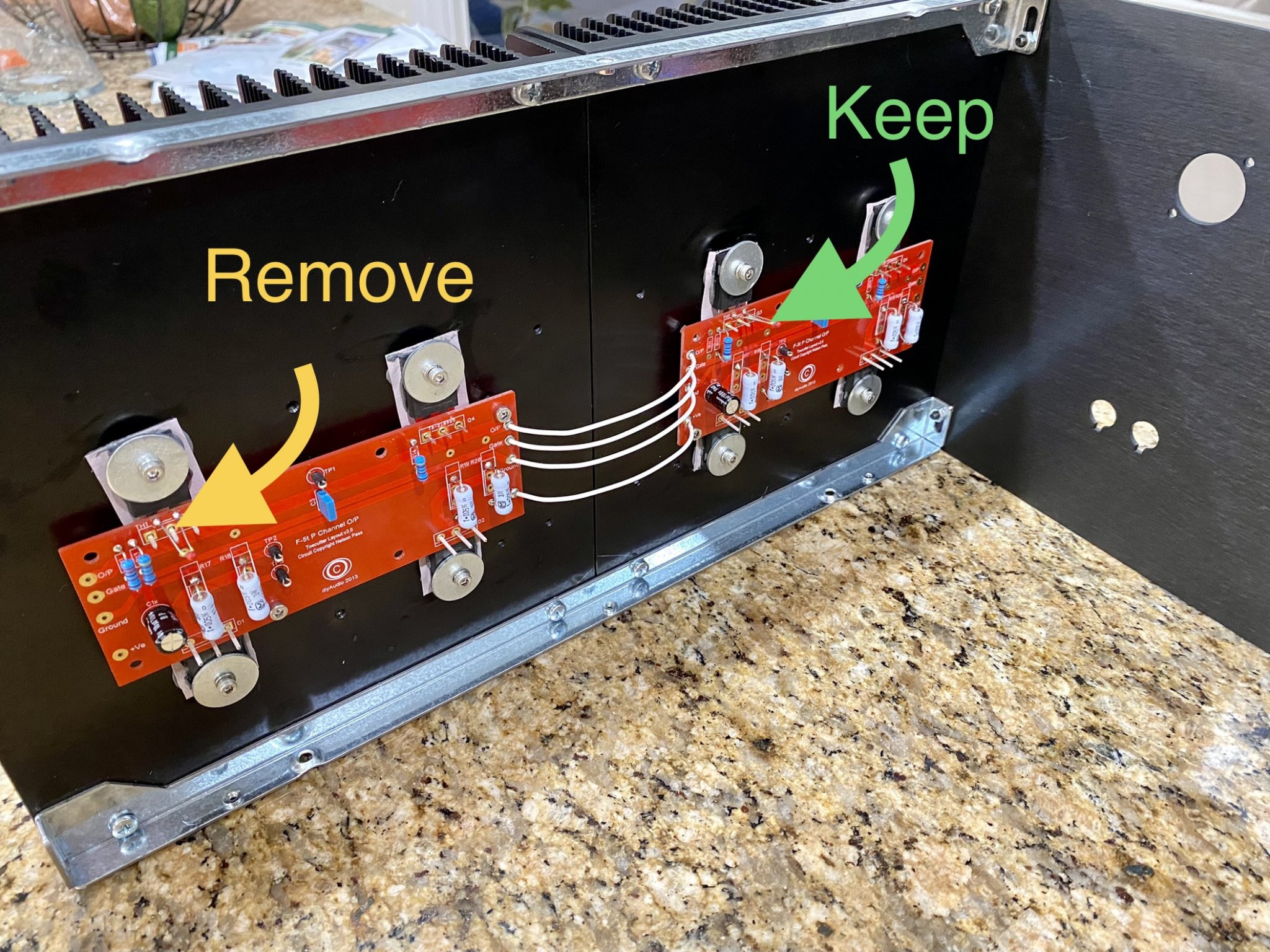

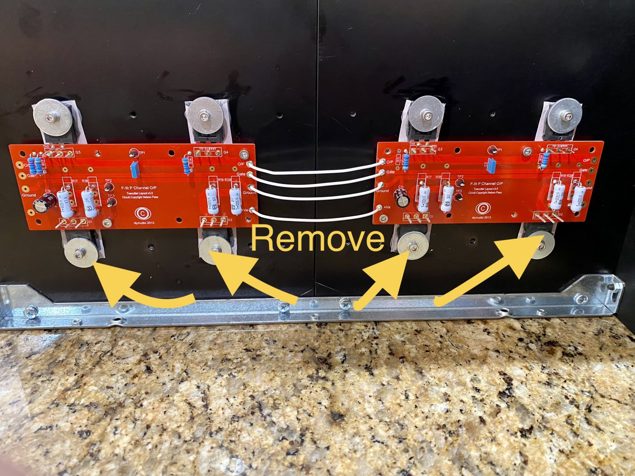

Would also recommend ditching the diodes. I was really hung up on this until better minds convinced me the amps are more stable without. i left them out and can confirm these things are dynamic as hell without them. Unless you have some really unique load, I don’t think you will miss them and increases your chances of successful build dramatically.
Thanks algg. Not sure if it matters if one removes the thermistor closest to FE on both the P&N channels. Does my illustration look correct?Edwinjones4, it looks like you have thermistor and it’s associated resistor on each output board. There should be only one thermistor per side (one for nchannel and one for pchannel), even with multiple output boards daisy chained.
Like this?Would also recommend ditching the diodes. I was really hung up on this until better minds convinced me the amps are more stable without. i left them out and can confirm these things are dynamic as hell without them. Unless you have some really unique load, I don’t think you will miss them and increases your chances of successful build dramatically.
I removed the diodes and 1 thermistor per side; however, I unintentionally removed the thermistor from the boards closest to the FE board…instead of the boards furthest away. Does it matter? Same thing for R11 on the P channel and R12 on the N channel (see pics below).
Ideally each of the 4 devices will see the same current and will be the same temp on the sinks. You're using one as "the representative" of the bunch.
tl;dr - I don't think it will matter, but I'd also like to have one more person chime in to be sure that I'm correct.
You currently have a gap between your sinks. It may close up at final assembly. You can (optionally) squish a little thermal compound between them for better thermal transfer if you want to go 'overboard'.
