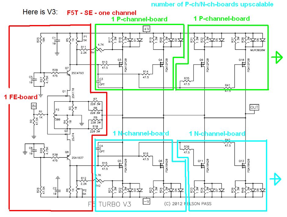

This is pretty confusing right in the beginning and needs some clarification I guess.A v3 monoblock will need one front-end board and 2 sets ( two N-channel and 2 P-channel) of output boards.
Order 2 full sets of F5T boards for mono v3. You will have 2 FE boards left over. F-5T (6 PCBs, Makes 2 channels; Rev3.0) - Circuit Boards
2 FE board will be left over if the amp is single ended. If symmetrical/balanced then all 4 FE boards get used; 2 FE boards are needed per channel handling both + and - halves of the signal (as minus would not touch GND).
Hello starcat,This is pretty confusing right in the beginning and needs some clarification I guess.
your above statements are correct. It is all described in the F5T-article of Mr. Pass.
The picture below shows the SingleEnded-version of a F5T - V3-Monoblock (=one channel) with
one FE-board and 2 N-ch-boards and 2 P-ch-boards. (the amount of N- and P-channel-boards is
upscalable).
Cheers
Dirk

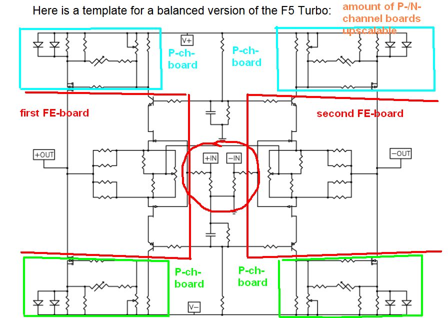

The F5T in the balanced version as a Monoblock (=one channel) has
2 FE-boards connected (check schematic)
and minimum
2 P-ch-outputboards
and
2 N-ch-outputboards.
The number of outputboards is also upscalable ( as more FE-boards will be as leftovers / reserve/
headphoneamp/...)
Cheers
Dirk
and minimum
2 P-ch-outputboards
and
headphoneamp/...)
Cheers
Dirk
Thanks, Dirk.for the balanced version:
