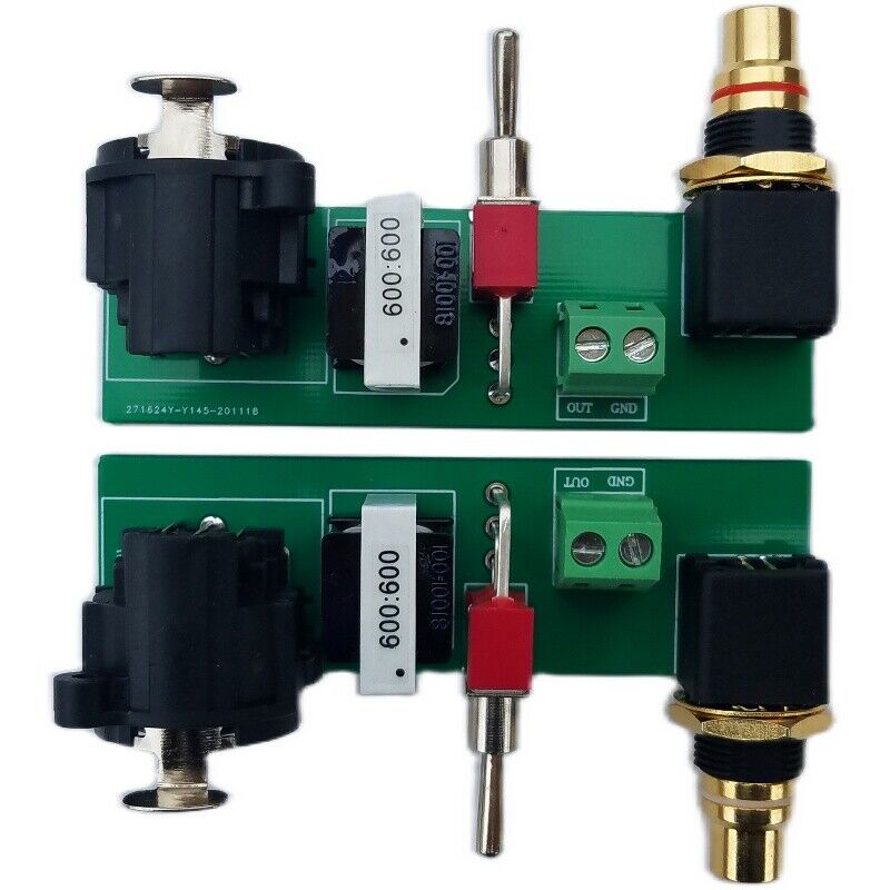

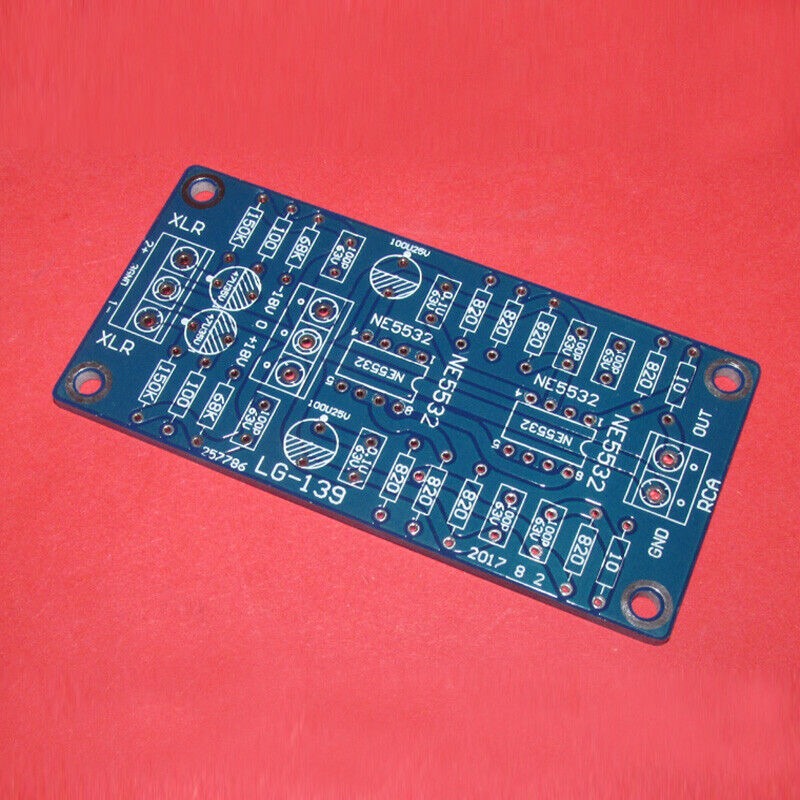

I am asse,blating a F5T in stereo 50Watt version, I think that to be able to use both RCA and XLR inputs, I have to use passive or active adapters, I still don't understand which one is less invasive and degrades the input signal as little as possible.
I'm thinking of using one of these two kits.
In your experience, which one should I choose?
on the left the passive one

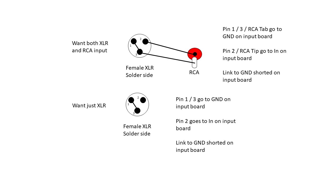

I'm now on a computer with a keyboard and a monitor I can see, and I can do some simple sketches
Sorry for the brevity, clearly bad typing, lag, and maybe some confusion earlier.
I think it is now clear that you want to build a standard stereo F5TV2. Previously, I thought you were building balanced amplifier(s), using a differential signal as an input though the XLR cable.
Could you explain why you want to use both RCA and XLR inputs, please? Are you thinking that the XLR cable will do something special re: noise? You may have a very good reason for this, but I cannot think why. If you can help to tell us why, we can help choose a good solution.
For SOME of my projects when I get a bit lazy, I wire it like this... there is really no need except for my laziness of not wanting to reach behind the pre-amp... but maybe you have a similar reason... Others feel free to discuss pros and cons, or if I completely ooked.
Please note that connecting Pin 3 to any sort of ground may severely degrade most kinds of actively balanced outputs (where the hot and cold are actively driven, for example by a differential design or by a dual opamp).
While doing so will not damage said chips and only degrade distortion performance, there are very few (to my knowledge) drive chips that will remain unaffected by this connection.
This does not apply to transformer balanced outputs or the quite common 'pseudo-balanced' outputs.
One advantage of using a balancer is the cancellation of all H2 up to the amplifier entry, if such an effect is desired. Another is the ability to use a transformer like the Jensen JT-14 to allow the full 4Vrms of a balanced source and eliminate any need of a signal preamplifier, again, if deemed desirable.
Someone more articulate, concise, and knowledgeable might be able to help more.
Sangram points out some exceptional reasons why it's not the best practice to do it the way I outlined. They also point out some precautions. There have been some great suggestions re: balanced / differential to SE "converters", but if your pre-amp already has RCA outputs, I am not sure why you would use one.
So, you still have not said WHY you must use the XLR outputs from your pre-amp. Why won't you just use RCA outputs from your pre-amp and install RCA inputs on the amplifier?
Others may understand completely, but I have not seen a good reason to do this yet. I may be missing the entire point. If so, I apologize.
No. dB is reduced by taking the inverted signal and "throwing it away".Yes, indeed the solution you proposed is the easiest and quickest to implement.

Actually, there is no real need to use the balanced outputs of the preamp, I can also use the RCA outputs.
I simply wanted to make the power amp much more versatile and then from a listening comparison with SE cables and XLR cables, using other power amps (aleph-J, PASS X150.5) it seemed to me that by using the XLR outputs and inputs, the music had more naturalness and transparency.
AH! I see.
But both of those amplifiers (in differing ways, I think) have the intention for differential signaling as part of their topology. Aleph J at the input and X150 throughout. The F5T does neither. This is where I am the most fuzzy, but I believe I have the overall situation correct. That is why even stock, factory units (Aleph J and X150) come with XLR inputs.
Even if you use one of the "converters", you are are only amplifying a SE signal within the F5T. You must either "throw away" the negative/inverted signal or use a converter to combine the negative and positive signals before the amplifier. Personally, I'd stick with the SE output from your pre-amp.
However...
The "converter" may have two advantages... or it could be a detriment. It will simply do what it does. Sangram said it very well, and I will attempt to paraphrase.
OR you can get rid of the pre-amp, and use some kind of passive (or digital) attenuation...
I understand your WHY now... but I'm not sure I agree that it would provide the benefits that you think it will. Again... others more knowledgeable and/or that have differing opinions will surely chime in.
However...
Some people REALLY like the H2. Some don't. Depending on your pre-amp, it could be a complete non-issue / irrelevant. If you have a factory pre-amp, it's likely that the distortion is so low as no not matter much... but... maybe you can hear the difference. Maybe your pre-amp does sound better when run fully differential (if it does).One advantage of using a balancer is the cancellation of all H2 up to the amplifier entry, if such an effect is desired.
Edited a bit - It will be louder at a given volume setting.... if you keep your pre-amplifier...Another is the ability to use a transformer like the Jensen JT-14 to allow the full 4Vrms of a balanced source and eliminate any need of a signal preamplifier, again, if deemed desirable.
