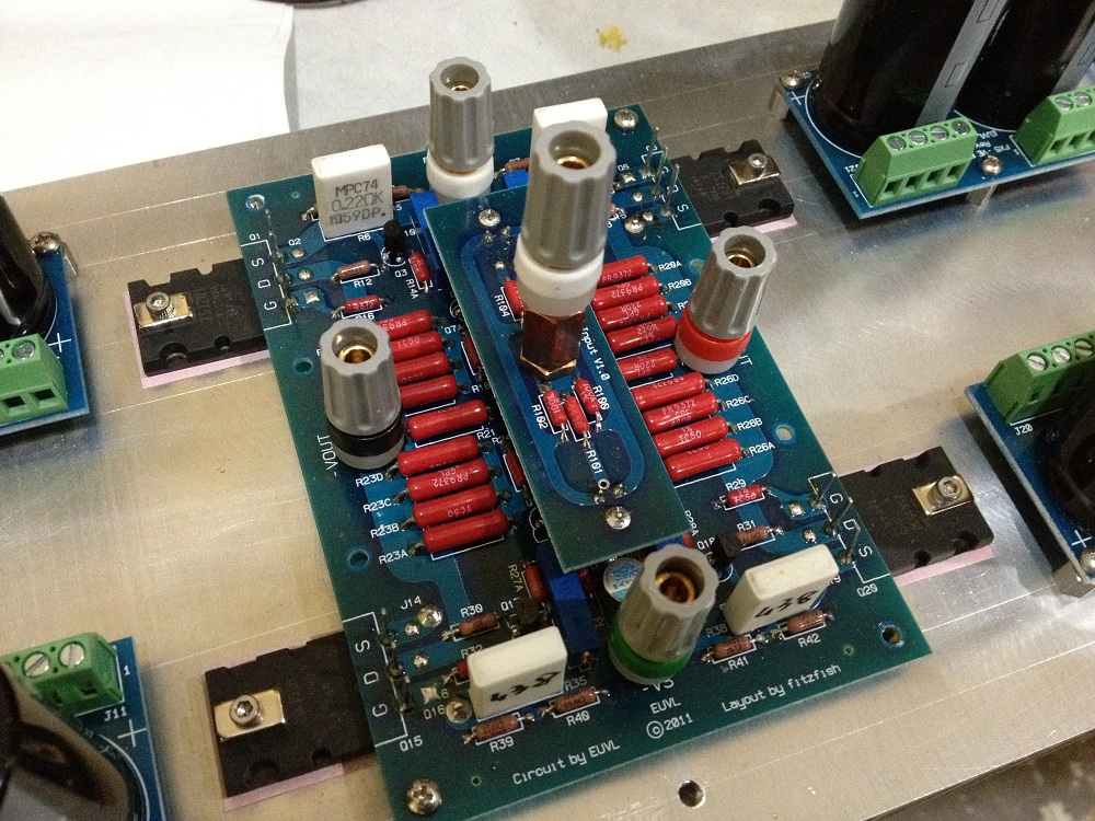

Hi Rick,One final question. Should R14A, R15A, R27A, R28A be 1K ohm as R14B,R15B, R27B, R28B will be determined and replaced after the bias is set?
The drain resistor values are determined by the operational current of the input JFETs and the Vgs of the output FETs at the chosen output bias current point. If you look here you will find a chart that gives an estimated value of the “final” drain resistors’ value. For any front end operating bias >= 5mA both the 1.5K and 1K resistors need to be installed along with the pot. They are all paralleled. If running less front end current you can install one or the other along with the pot to get it where you need. With the Idss parts suggested and the output device’s typical Vgs the pot is near its highest resistance setting.
The pot actually covers the PCB pads and component area for the “B” resistors so they are mutually exclusive. I’m leaving the pots in for now. Once biased up and balanced I suggest you leave the pots in for at least a while to burn everything in and allow it to stabilize. Check it several times to make sure you are happy with it before even considering swapping them out. If you want to change them do so one at a time to avoid confusion. Remove them carefully so that you don’t thermally damage the element (permanently change the resistance) or move the trimmer. You need to let them cool off (from soldering heat) after removal and measure them. Find close to exactly the same value fixed resistor to install in its place. Check it carefully after changing them and let it warm back up completely to check again once the bias settles.
Hope it helps answer the question. More details forthcoming in the bias build notes.
Dave

Fitzfish: I have been conparing the main board layout in post #8 #http://www.diyaudio.com/forums/pass-labs/208880-f5x-euvl-approach-build-thread.html#post2947446 with the schematic in post #4.
I cannot find resistors R14B, R15B, R27B, and R28B. The appear as 1K ohms in the BOM and the schematic.
Hi Ihquam,
Yes, they are obscured by the pots in the picture. They are actually located beneath the pot in each location, also described here. The BOM had one additional error instructing to stuff the 1K ohm incorrectly in the “B” position instead of in the "A" position for each of these you question. Also see the EUVL's post just previous for more info.
I was waiting to see if any additional errors were discovered. My apologies if the delay caused confusion. I will post the updated BOM later on this evening.
Thank you and to everyone so far for the feedback. We want to make it correct and easy to understand!
Dave
Dave

How is one supposed to unsolder the pots and install alternate drain resistors without removing the board (and mosfets) from the heatsink?
My pleasure Patrick.
Hi Rick,
Dave

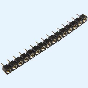

For my own proto boards, I removed the PCB from the heatsink to swap the trimmers for fixed resistors.
Easy enough to do without any problems.
But if I were to do this now, I would solder DIL sockets like these at the 3 holes for the trimmers.
You can then just plug in the trimmers and set current as before.
After you are satisfied with the setting, just unplug the trimmers, measure their trimmed resistances, and then solder in fixed resistors.
Of course you can also use these for the fixed resistor holes as well for easy changeover.
Patrick

That looks like a good approach.
What is your reason for replacing the pots with fixed resistors? Is there a reliability/stability issue with the pots?
Patrick

Please forgive my ignorance, these DIL sockets have holes big enough for the resistor lead to go in without any solder? Can you give a part number so I know what to look for (for the part knowledge handicapped)? All the ones I've come across have holes that are too small for the resistor leads to go in. Thanks.But if I were to do this now, I would solder DIL sockets like these at the 3 holes for the trimmers.
You can then just plug in the trimmers...
...Of course you can also use these for the fixed resistor holes as well for easy changeover.
