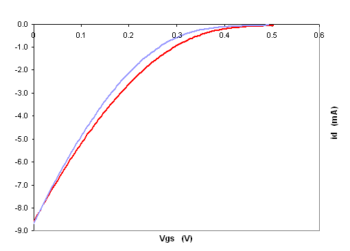

I have been asked why there is a need to match for transconductance, when we already matched tightly for Idss.
The attached graph are two 2SJ74BLs with identical Idss, actually measured with a curve tracer.
As you can see, real devices do not obey theoretical equations.

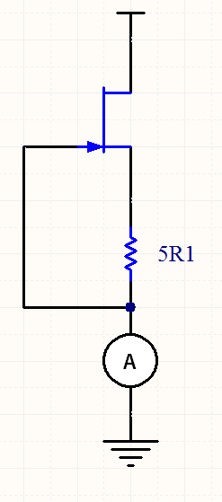

To match for transcoductance for F5 without a curve tracer, the following procedures are sufficient :
2SK170BL -- measure Id with 0R, 11R, 22R degeneration
2SJ74BL -- measure Id with 5.1R, 16R, 27R degeneration
Devices (NNPP) with identical values for all 3 columns are best matched for the F5X.
