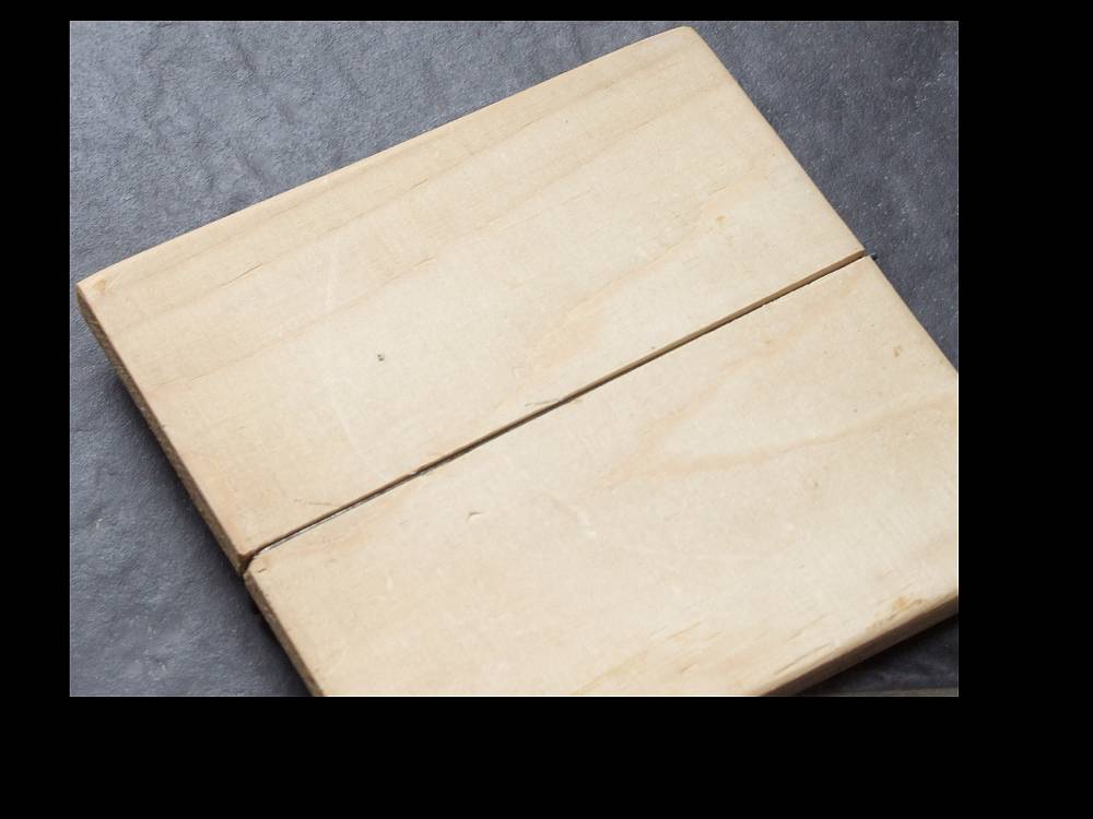

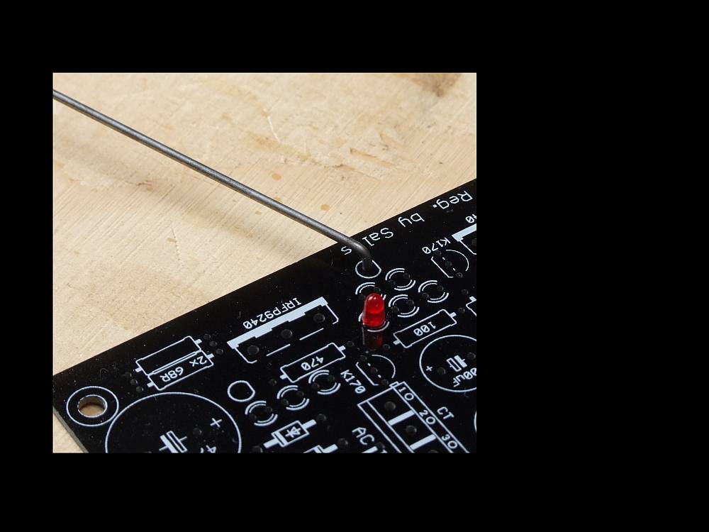

I copied this tool from a Member's post. Simple, cheap and effective.
Use a length of (15mm diam or 16g) spring steel bent into a long G.
The smd sits under the anvil and is held by gentle spring clamping action while the iron heats the solder pads/pins.

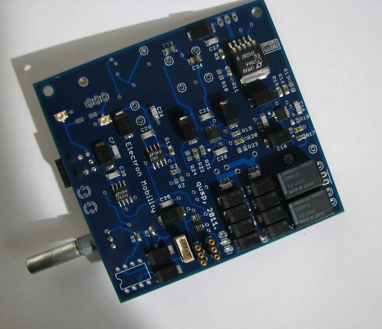

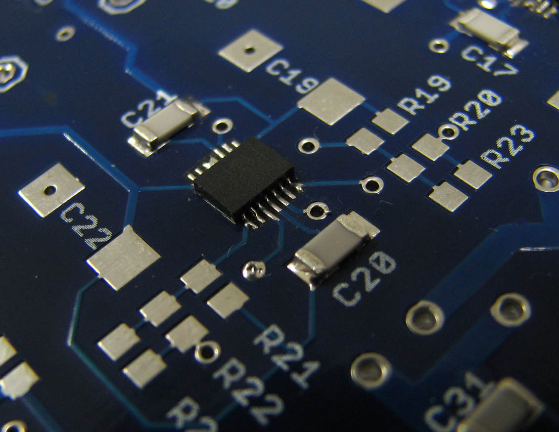

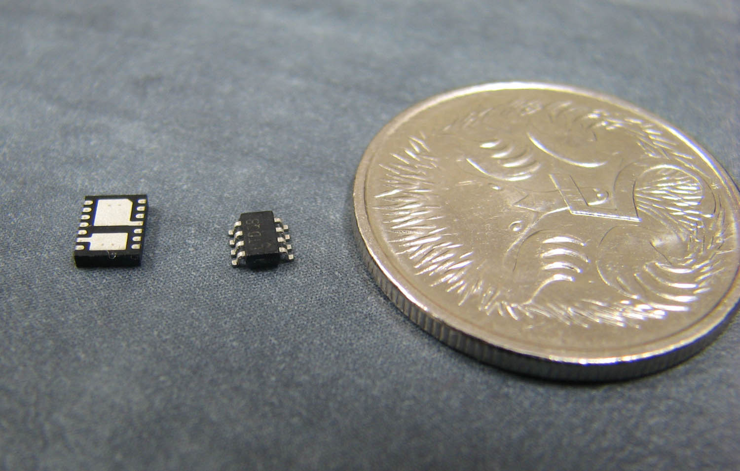

all except the LT1764A and LT3032 regs on this just used a standard 1.2mm chisel tip and this 4 layer board sinks to the ground plane so the tabs of the lt1764A needed a bigger tip. the DFN14 powerpad package regs were a bit tricky as they dont have leads, but still doable thanks to a custom land pattern and a couple of vias
