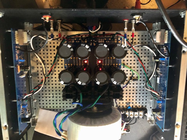

@ChrisM91, congratulations on a beautiful, clean build!
but why does the right channel look like it's either built with components mounted on the wrong side if that's even possible or you somehow ended up with 2 left channels?
Why are your mosfets at the top on the right channel?
If you refer to the picture in the first post - 6L6 has a shot of both boards - one says Channel A and the other should say Channel B.
The store sent me two of the same PCB....@ChrisM91, congratulations on a beautiful, clean build!
Thank you for the generous offer! The store actually sent me a new set after I informed them of their error. Debating whether to built the new board or not...is it worth desoldering the precious FETs and transformer...Amp sounds and works great, listening right now in fact!

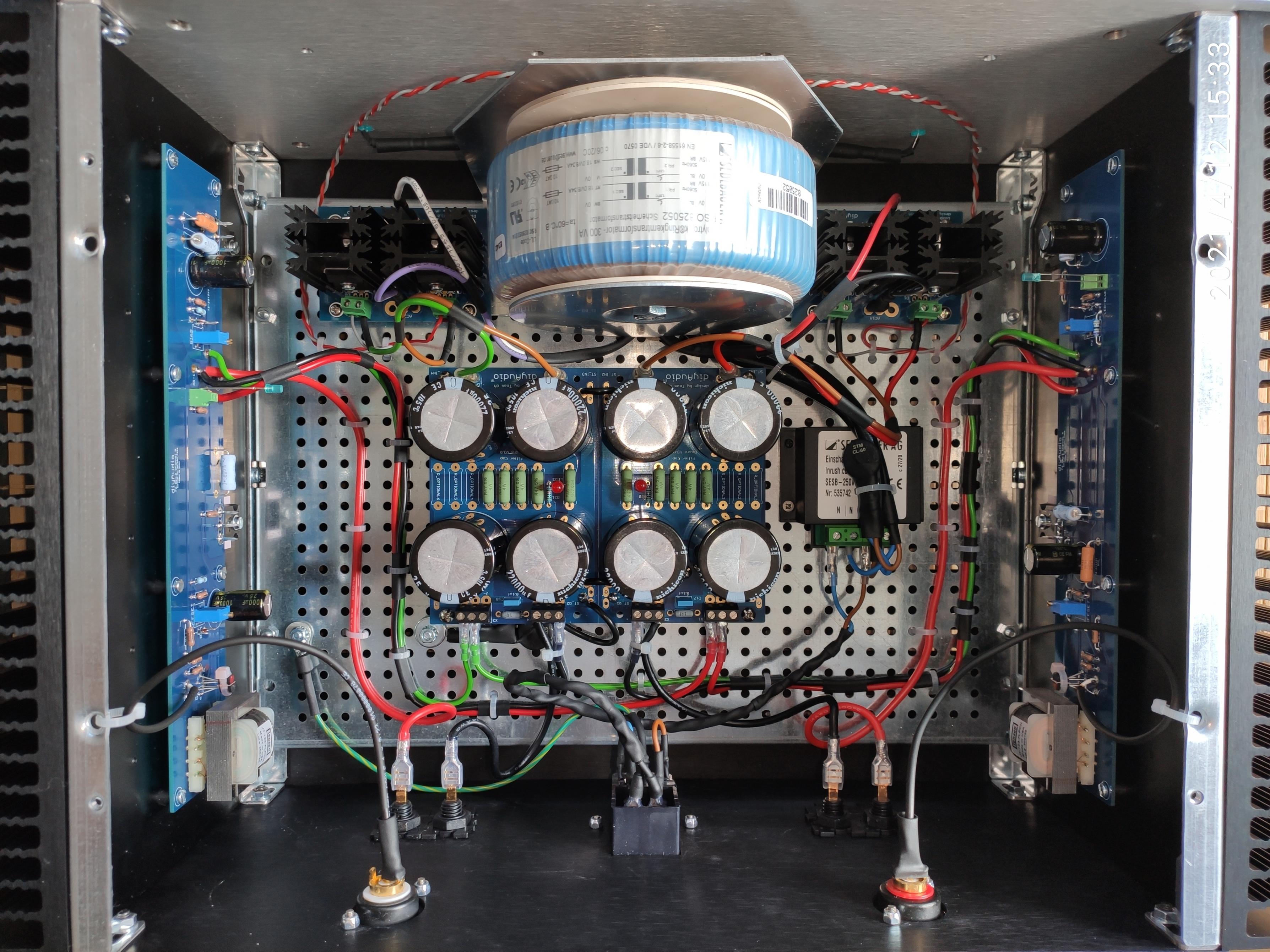

AMP finished and works perfectly
Thanks to the forum and all people who helped me the work is completed.
Absolutely no issue even for the final tuning, thanks to the methodology regarding pots settings before power up (I mean setting one to ground and the other to negative rail); need to turn and turn and turn clockwise until the good value is reached ont the DMM, then power up the amp and wait some minutes before turning Bias pot counterclockwise to reach 500 mV. Then wait at least 10 minutes to reach the good temp. Any action on one pot modifies the other setting. As said, just be patient.
At the end, the amp is not very warm.
Sound is perfect. No hum, not any noise.
Actual config uses a Cambridge DAC, Nutube preamp now connected to the F6.

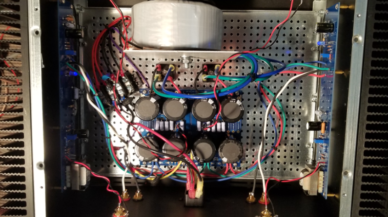

Yipeeee. The F6 is up and playing music. Bias at 0.500 volts. I'm using a BDP 105d without a preamp. My speakers are stock block Martin King OBs with the Jordans and 18-inch Goldwood woofers. See attached. The upper and mid-ranges sound good, clear, and tight. The low end is fairly weak. I know, OBs are supposed to have weaker base. However, my PP6A3 amps provided stronger base.
The F6 has a frequency response that goes down to the basement. Could the lack of a preamp be the issue? Maybe my speakers are not a good match for the F6. As always, your comments would be appreciated.
Thank you ZM, I got the resistors to adjust the damping factor. The 0R33 mills brought the bass up to where I like it. Next, I cranked up the bias to 0.550 V. In the process I got a spark from the left channel 0R47 resistor to my shielded meter probe. Now I have a persistent 120Hz? hum on the left channel. The bias and offset remain correct on both channels at 0.550 V. I don't have a scope to snoop for the hum. Any ideas? HeyBill
