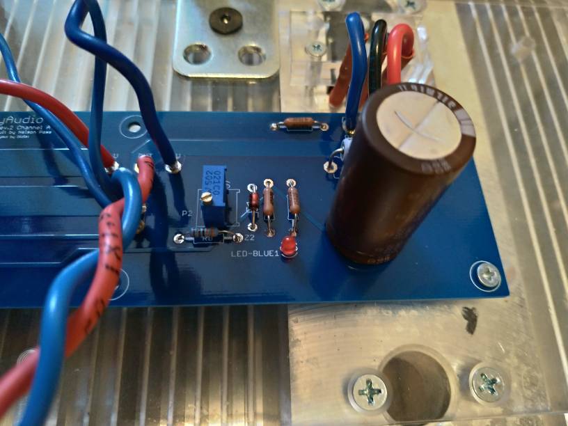

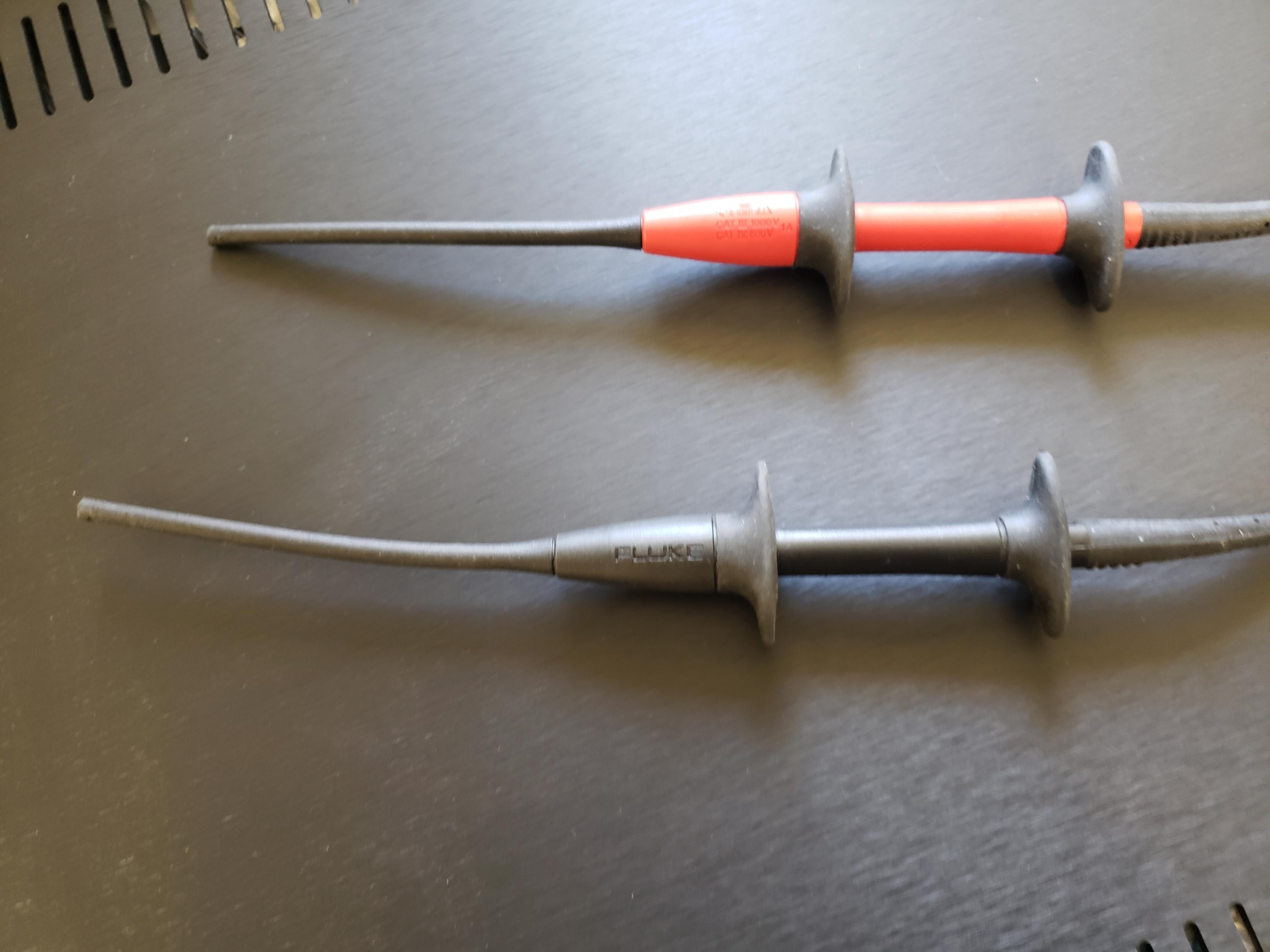

Referring to post 3458, I picked up a hum after arcing to my meter probe while setting the bias. Diode bridges are OK. The bias and offset work normally. Before unsoldering parts, I need an opinion. Could C1 have been damaged causing the hum? Regards, Bill Edit: I meant C2.
At this point, a picture or two might be useful for us to see. C2 or C1? Perhaps. That's assuming that all else in your build was good in the 1st place and you didn't have any cold solder joints that slowly lost conductivity since your initial fire up was a success.
All that being said, have you invested in mingrabber test clips yet?

Actually, the desoldering screwed it up. Too much heat and pulled on the legs too hard I think. It was a dead short after the desoldering attempt.
It was one of the JFETs I got from Spencer that was the victim. I picked up the issue even before adding any power.
Poseidonsvoice, Thank you for the advice. I do have good Fluke high voltage test leads but when I extended the clips I got the arc. You can see in the picture of Board A that the bias resistor is just below C2. I will check to see if the bias resistor is soldered properly. The amp did work fine before the arc. Regards, Bill
Changes out C2. Also reflowed the bias resistor. Still have the low level hum. Switched the RCA's around on the OPPO to see if that was it. Nope. This is the time for a scope but I don't have one yet. Should I be able to see the the hum using my DMM? If so, what would be the best approach? Bill

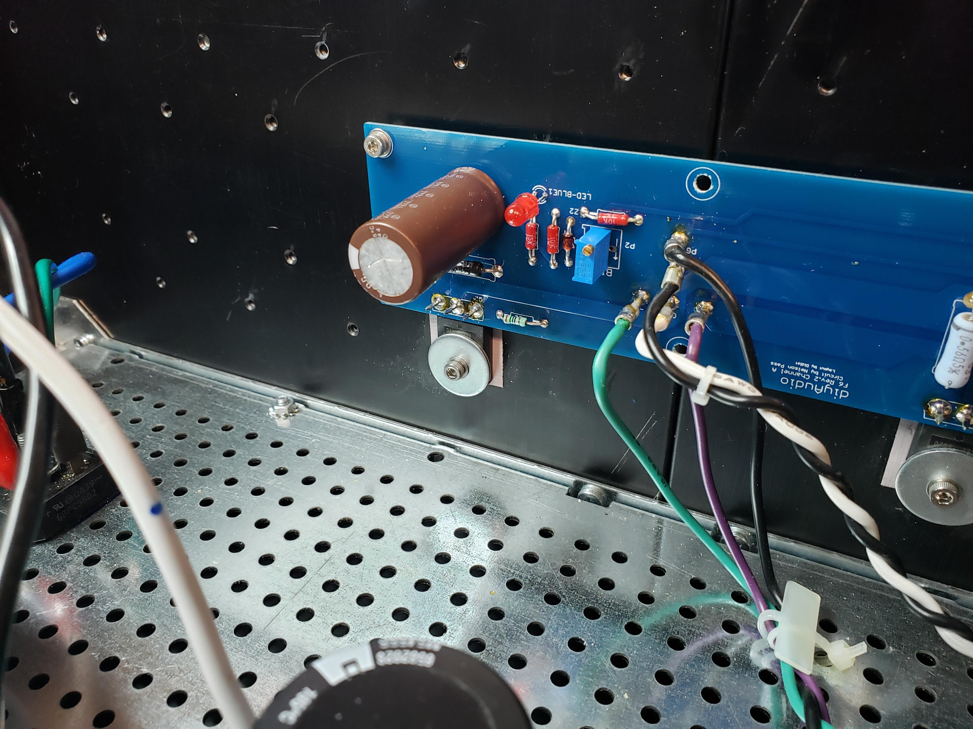

Bill,
Is this a 60Hz hum or a 120Hz hum? Do you have an app for your phone that can check the spectra? I have one called 'Spectrum'.
You are using the Oppo BDP 105 direct to the F6, yes? So it would be highly unusual for the Oppo to be a source of the hum in all honesty. Did you check your interconnect and make sure the RCA center pin from one end is connected to the other and the RCA ground is connected from one end to the other? Do you have another CD player or source you can connect to the F6 to double check? I would make sure it's a viable source that is well designed from a "grounding" standpoint. Many diy projects and some commercial designs are not great tests for this and can lead to more confusion.
Next, is there hum without anything connected to the RCA input of the F6? Is there hum, if you were to disconnect the RCA's to the input of the F6 pcb, and connect/solder a small wire from the input (+) on the amp pcb to input (gnd) on the amp pcb? Is the hum on both channels or only 1 channel? Are the RCA's well isolated from the chassis? Disconnecting the wires attached from the RCA to the PCB, is the RCA signal tab and RCA ground tab isolated from the chassis?
You can check all these with a multimeter.
Are all the power supply caps well soldered and seated on the PCB? It is highly unusual for a power supply cap to fail and not look ugly on the PCB. It is common to have a cold solder joint on a power supply cap due to poor thermal capacity of the soldering iron, poor soldering technique, etc...Did you tug on the ground wires going from each amp PCB to the power supply PCB and make sure there is good continuity? Is the CL60 properly connected from the PS PCB to chassis ground? Is the chassis ground properly connected to the IEC ground tab? Is the CL60 thermistor functioning as a ground loop breaker as it should?
Poke around, there is something loose somewhere. Again, all of these can be checked with a multimeter.

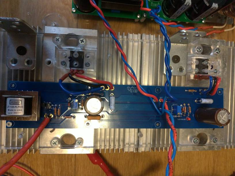

Your build pic for others to examine and see:
https://www.diyaudio.com/forums/pass-labs/360807-ultimate-4u-500mm-chassis-123.html#post6612774
Are those Cardas RCA's and binding posts? Are you sure the body of the RCA isn't touching/shorting onto the chassis from within the hole? Check. Cardas RCA's require a good amount of heat and thermal capacity from your soldering iron or else cold solder joints result.
99% of the time, most problematic situations in new diy builds can be solved with a multimeter, although I admit, I love my Keysight oscilloscope!

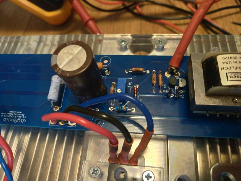

Anand,
Thank you for the very detailed reply. I loaded a spectrum analyzer app and found the hum to be 120Hz.
Hum only on left channel after I caused the arc when setting bias.
Checked interconnect continuity and found center pin and ground good end to end.
Hum is louder with interconnect disconnected.
Chassis RCA is not shorted to chassis based on meter test.
Disconnected wires from chassis RCA to pcb. Hum still present.
Shorted + and - signal wires after removing them from chassis RCA. Hum still present.
Checked my solder connections to PS and pcb. All appear to be good and remain tight after tugging on them.
CL60 ground lift seems good.
The Chassis RCA's are Cardas. I used the 750F setting on my Weller iron to get the ground and center pin soldered correctly. They were tight.
The odd thing is that the hum started after the arc to my meter probe, but it could be coincidental.
Anand, thank you again for you help. Regards, Bill

Anand and henryve,
Found that I have 0.0V across R10 on the side with the hum and 1.5V on the other board. Still able to set bias, but I must has fried R10. I'll change it and see what happens. Hopefully I have another one.
Edit: The power off resistance in circuit is 10K. Now sure where to go from here. Regards, Bill

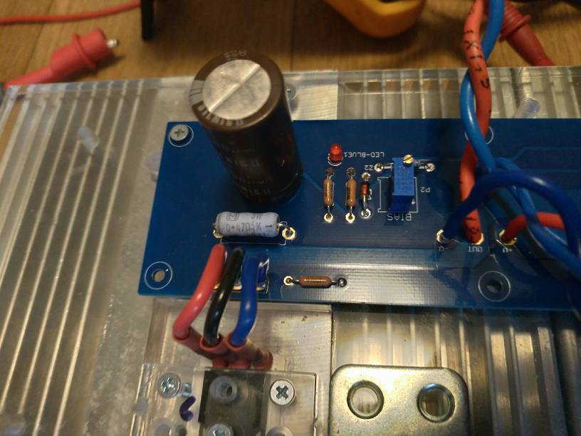

Bill,
Looks like from your testing that the hum source is intrinsic to F6 and not extrinsic.
Make a copy of the schematic and then annotate systemically what voltages you are getting (relative to ground) for the various parts of the left channel (then upload here). It’s a simple circuit - we should able to see if it’s a passive part that’s failing or (more commonly) an active device like the JFETS. Be careful and take your time. Comparing to the other channel can be helpful.
Although 120Hz points more towards a PS filter issue, I think here your PS is okay given that ripple is equal (and reasonably low) for +/- voltages.
The last F6 I repaired, the JFETS were fried. It was obvious by visual inspection (the labelling on the JFETS were tarnished) and immediately obvious on my transistor tester.

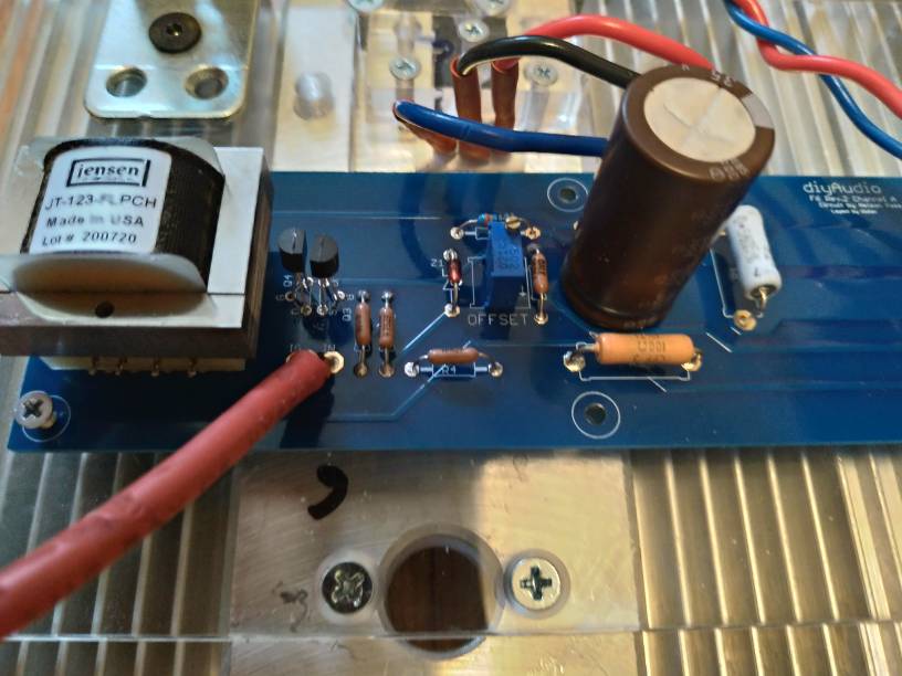

hello, friends. i'm now firing up my F6 and i have a problem with one channel.
i made a mistake and mixed up Q3 and Q4 in one channel and got -24V DC at the output.
i have replaced them with new ones, but the channel does not want to adjust bias and offset.
when bias is 0, offset DM reads 0 too. but when i turn bias pot down and increase bias, bias DM reads 0.1 maximum, but offset DM reads -24V DC, and i cant adjust it.
if i decrease bias to 0, offset DM slowly goes to 0.
i checked every resistor before soldering.
Zenners are 6.8V, R7,R8 are 3k3
Jfets are from the DIY store
