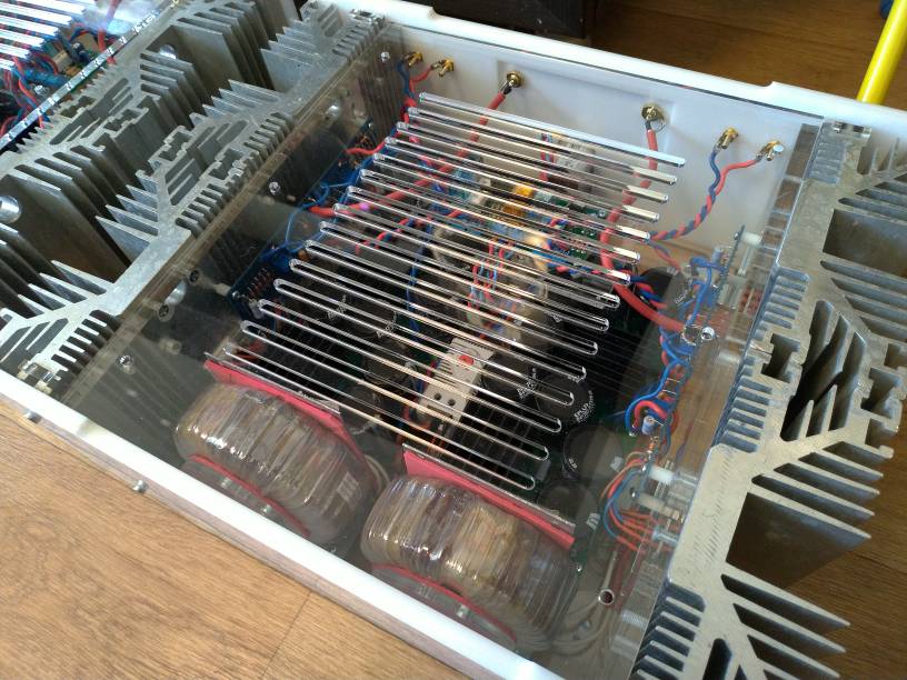

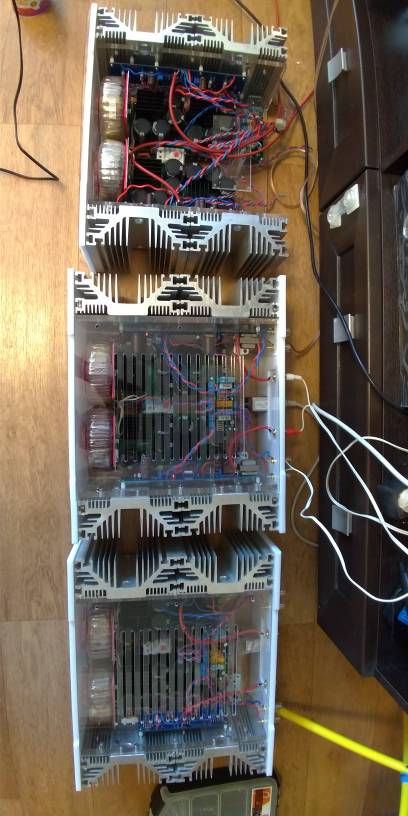

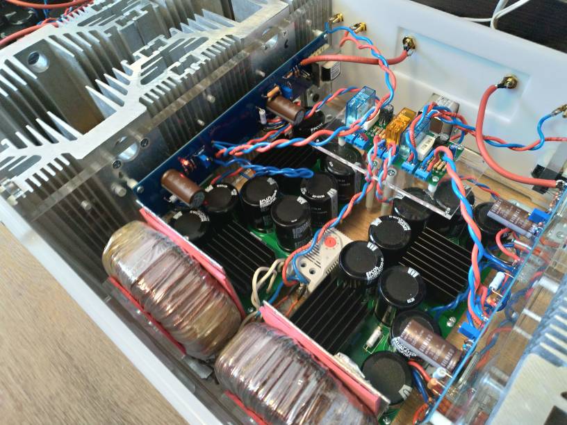

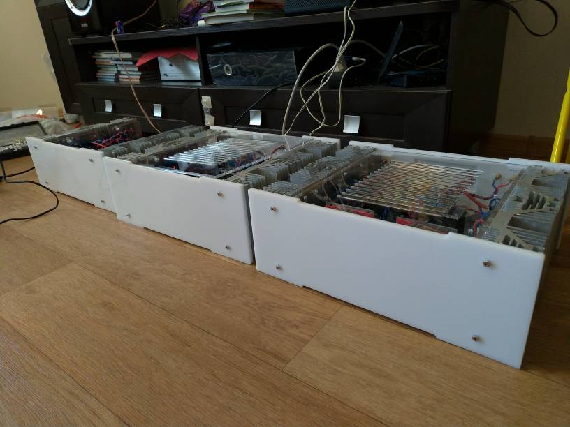

My F6 is alive! Output transistor was fried.
Now all is ok, and it plays its first track)
Bias is 1.1A.
Please, have a look at my twins) left to right: F4 with BA3 front end (waiting for JFETS), F6, F5. It is the coolest arithmetic i've ever learned))
Many thanks to all of you, to 6l6 for the build guide, to ZM for advices, and to Mr. Pass for his genius!

Try increasing the bias to 1.6 Amps or as much as 1.8 Amps. As long as the heat sinks can be touched for 10 seconds, you’re Ok.
I have seen ( using QA401 ) that over 1.5 A , distortion is rising as much as the temperature , and for me the "sound " doesn't benefit , it may depends of the setup of each one
I personally stop and stay at 1.4 A , it seems to be the best sound/distortion ratio 😉
It also seems that some like it more "colored" , so why not 😉

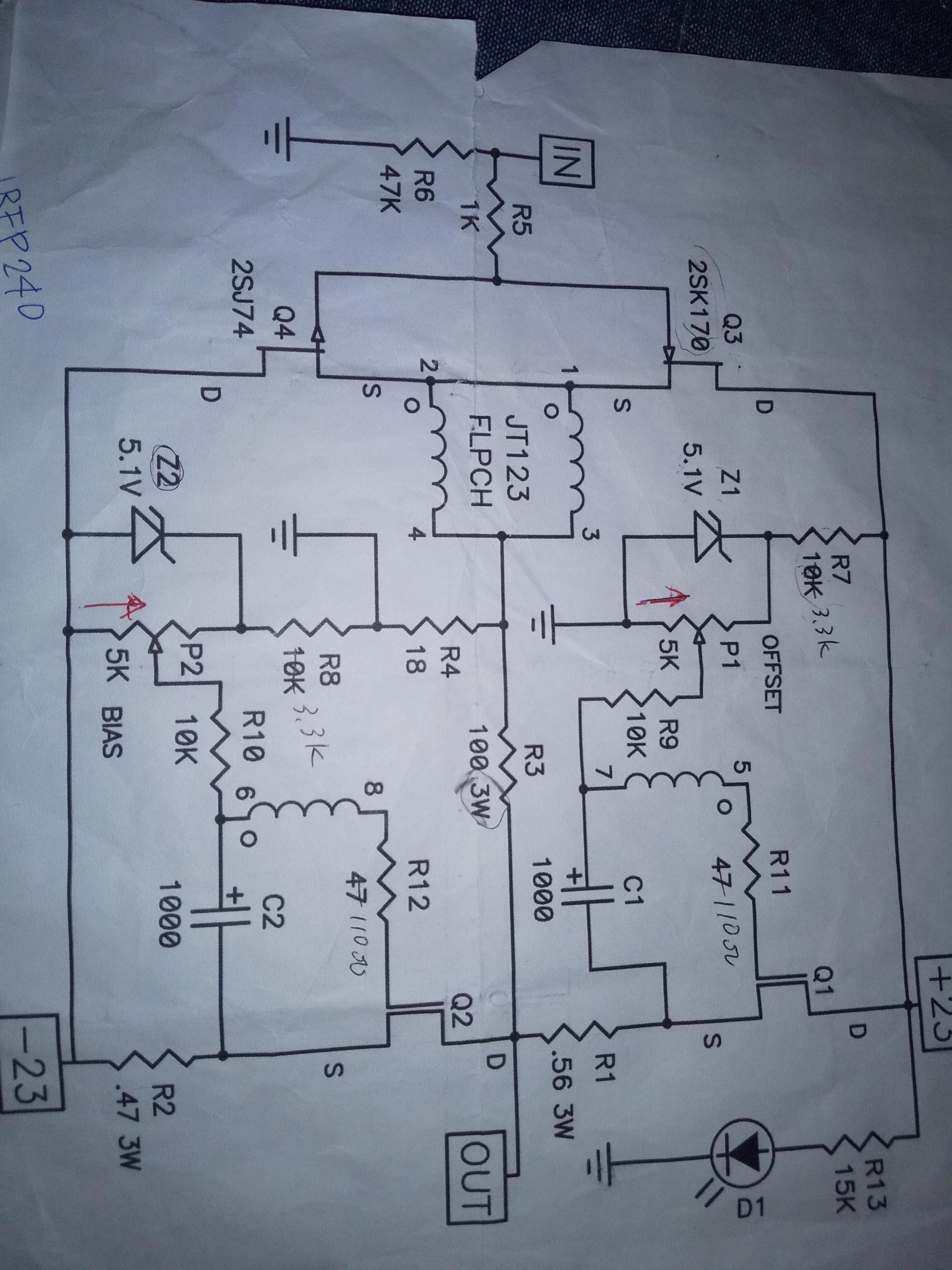

I feel so sorry because of my stupidness.
I had silly mistake for wiring PSU rail +/- opposite
when changing reflector diode only few seconds.
There was no smoke but no sound come out.
3 Leds instead of zenner diode still lights on
But when I turn off, Z1 stay on for few seconds but Z2
Turn off quickly.
What is possibly damaged?

Have a look at R1 and R2 , I made the same mistake years ago and those resistor were well burn and almost dead 😉
what you did is kinda short , so high current occur in the all power supply circuit , have a look at the all power supply
