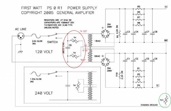

I also didn't see any inrush current limiting mechanism or 'safety' caps in the build. Is there something in place that I did not see? If not, what value fuses/fuse types are you using? Is it a 300VA or 400VA transformer; I can't quite see, but from the size, that's my guess. Neither the caps nor the inrush limiter are strictly necessary, but it's just my curiosity.

There is no soft start it looks like in your build. The transformer goes straight to the mains. Typically you would have an arrangement of three cl-60's or a soft start board. I did run my F6 for a few days without it when I first built it but I did notice more startup hum from the transformer. Look at 6l6's pic of it in the first post of the build guide. I believe there is some discussion within the last few pages of this thread about it as well.
Three? In general, in a 'standard First Watt power supply' if one or two are used, it depends on the mains voltage and transformer primary arrangement. It may be helpful if you point to a schematic.
Are you perhaps adding the two which might be typical with 120VAC mains voltage using a dual primary transformer wired in parallel along with another similar device used as a ground lift? Total - 3.

No need. Jim's PSU is based off the standard First Watt PSU. My guess is that you're adding the two thermistors used in one specific configuration to limit the inrush current (see 120 VAC reference below with the thermistors circled in red) to the device used to lift the ground (circled in green). Two are for 'soft start', and the other is for a ground lift. Thanks for explaining your POV. All clear.

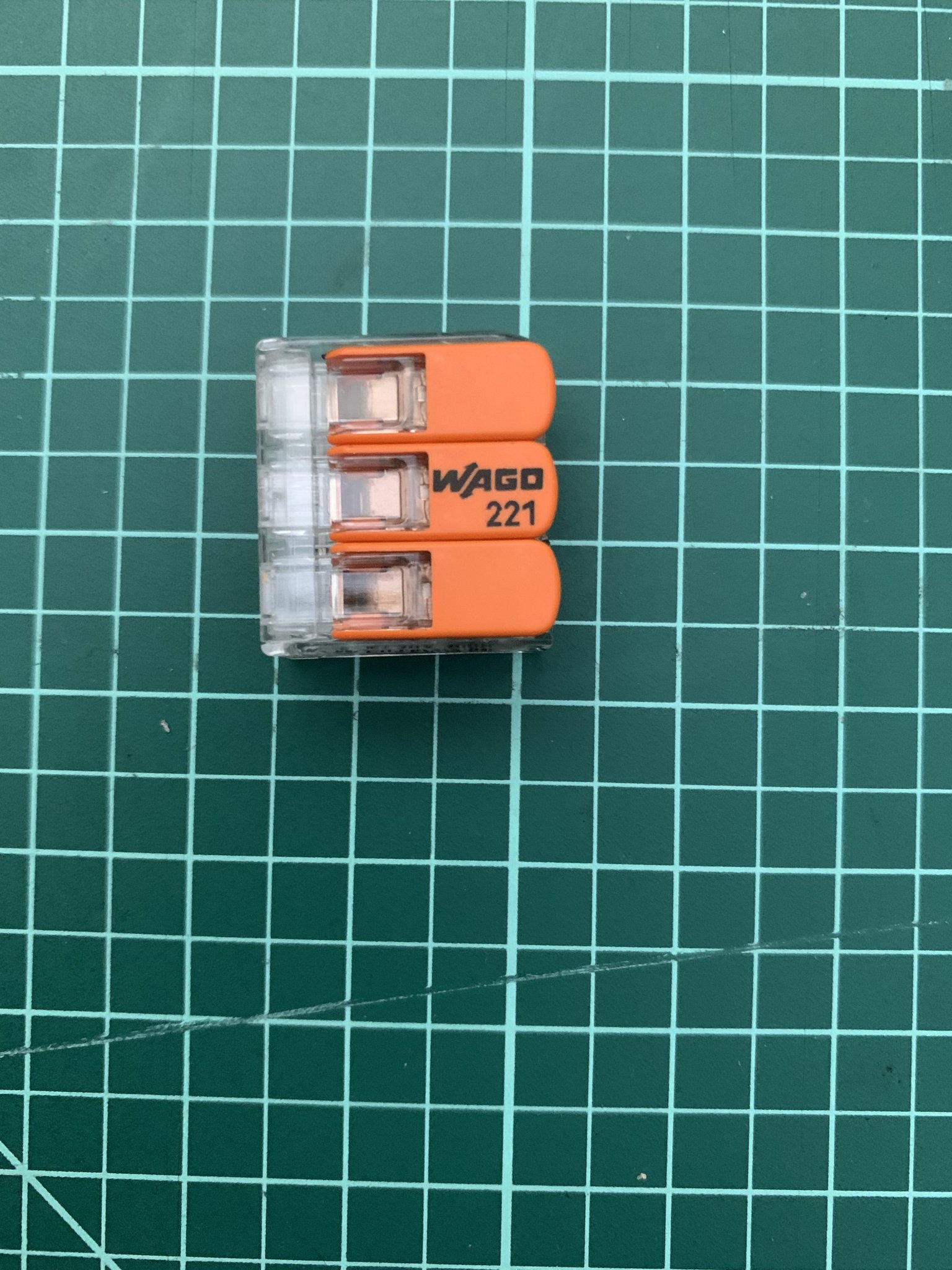

Thanks for the as-built review and recommendations. I do not have any in-rush protection or cl60 installed. I’ll do some power supply build reviews to see how to add. The fuses are 3 amp that came with the switch. I’ve got the bias at 0.5 and the offsets near zero. No hum at all so far. The transformer is AnTek 300 VA, AS-3218.
This is my third amp build after the amp camp and the Nutube pre-amp So my knowledge if power supplies and amps is limited.

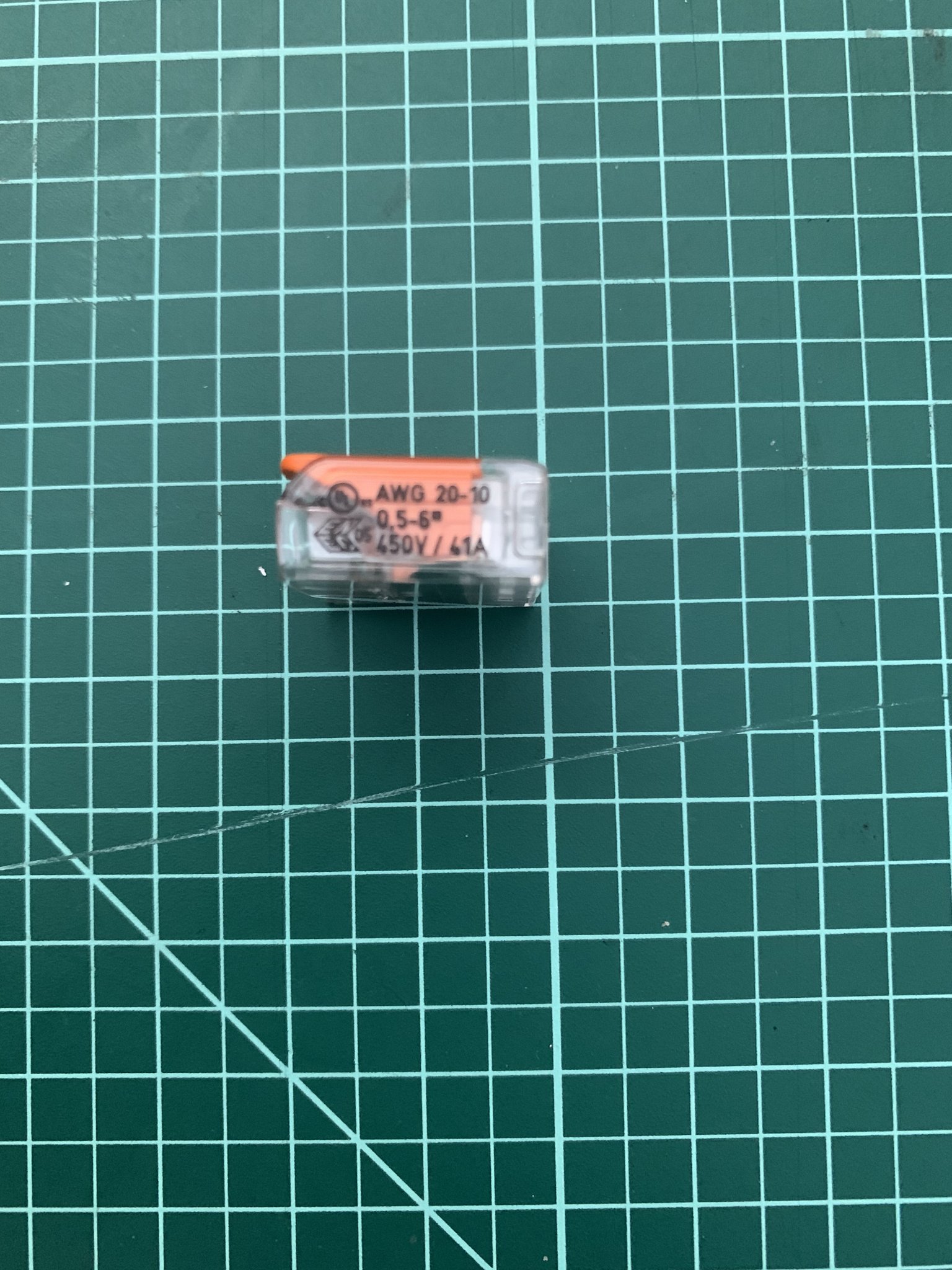

The Wago connector is used to connect the mains to the transformer. They feel solid. See picture of the connector and rating.

The Wagos are heavily used for mains wiring in junction boxes etc. in Germany. It's the standard way of connecting wiring nowadays.
When I was a kid, mostly screw terminals (terminal blocks / Euroblocks) where used in this application, but these tended to suffer from corrosion long-term (years to decades), and you could safely use them with multi-stranded wire (as opposed to solid-core) only when you put ferrules on the stripped ends of the wires before fastening them. The Wagos work for both solid-core and multi-strand.
We frown upon wirenuts here 😉

I wish not to side track this thread with connector chat, but WAGO 221 connectors are perfectly acceptable for electrical use as Claas mentioned. DIY audio amplifier power requirements do not come close to stressing them.
https://www.wago.com/us/discover-wire-and-splicing-connectors/221
You are probably right. I have seen too many of them with burn marks on them that I don't trust them all that much. Maybe it is due to an installer error. I do handyman work so I run across them every once in a while.
