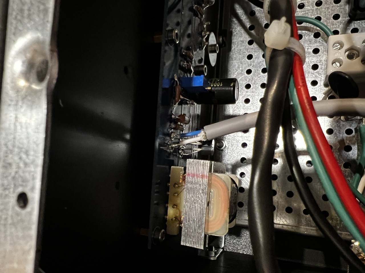

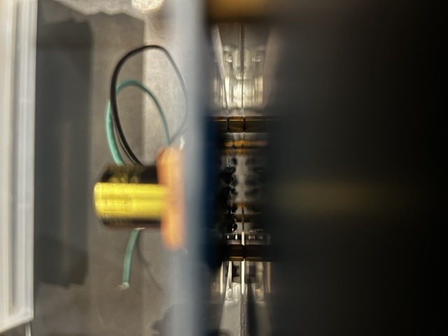

Hi guys, I almost finished my F6 today when my right channel assembly went wrong.
don’t know why I removed the dim bulb tester. Thinking that since the left channel was good, the right side must be too! overconfident. Pop went the jfets! It shot a neat string of cloud across the bench
I ordered a new quad set from the store few hours ago, and I just got notification that it’s been shipped. Insanely good.
I may have reversed the polarity. But after checking the wires it seemed I did not? I used green wires for v+ red for v- and black for ground.

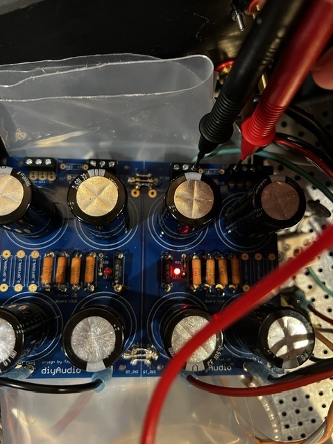

the opposing side of the power supply to the shot right F6 board (left supply) is now dead outputting 38mV at the V+ To ground terminals, while right side still outputting 25v steady with its LED still lit.
I tested all supply resistors by lifting up one leg, all were still good including bleeders and led limiters. So it must be one or all of the 4 supply caps that also blew Along with jfets.
tomorrow morning I’ll have to disassemble it all.

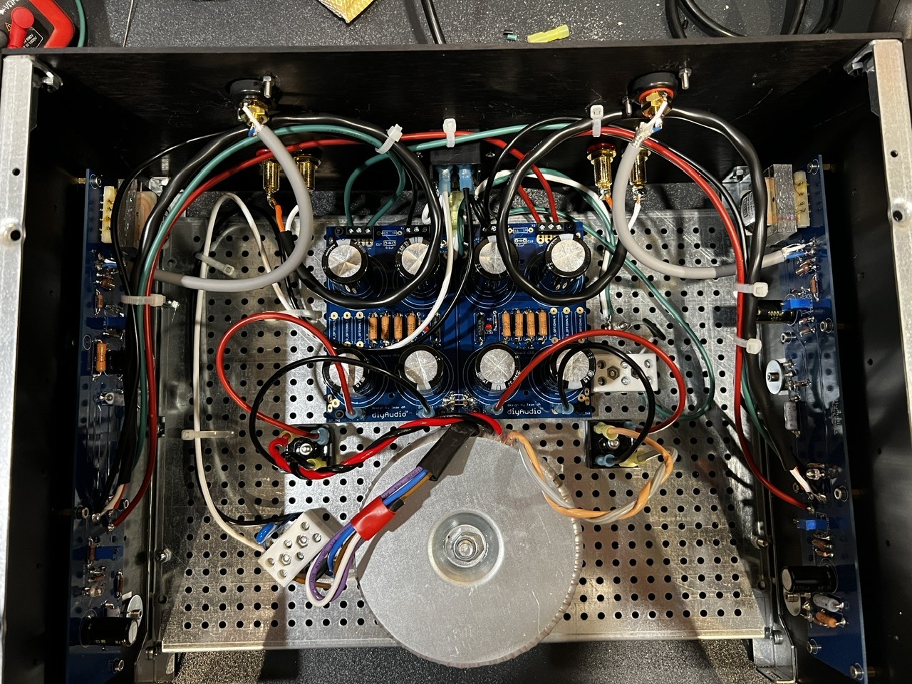

cl-60 to ground. 2 fuses of 250v 1.5A installed In switch carrier.

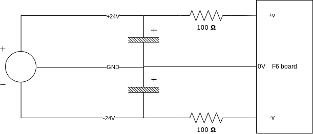

4. Yes, you will need a -V as well. Provided that the bias is tuned down to a minimum you should be able to use a 100 ohm resistor (or slightly less) in series with +V and +V and have a fully working amplifier. You would even be able to play music on it (not very loud...). If I remember correctly the F6 will work as an amplifier from ca +-10V and upwards.

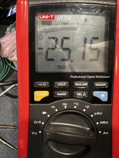

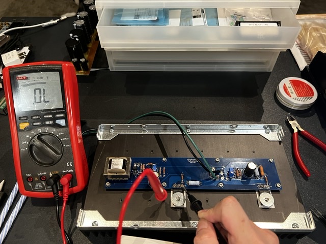

1. I have a DMM and have measured before connecting, that indeed the wires from v- reading goes to v- board connection. this picture is from the v- terminal to ground measuring -25.15v. The opposite side (left) had identical inverted +25.15v before being blown up.

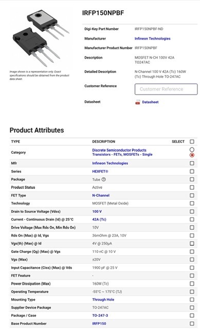

3. I currently have 4 of these on hand IRFP150 is this good enough? or these IRFP250 ? local shop stocks both.

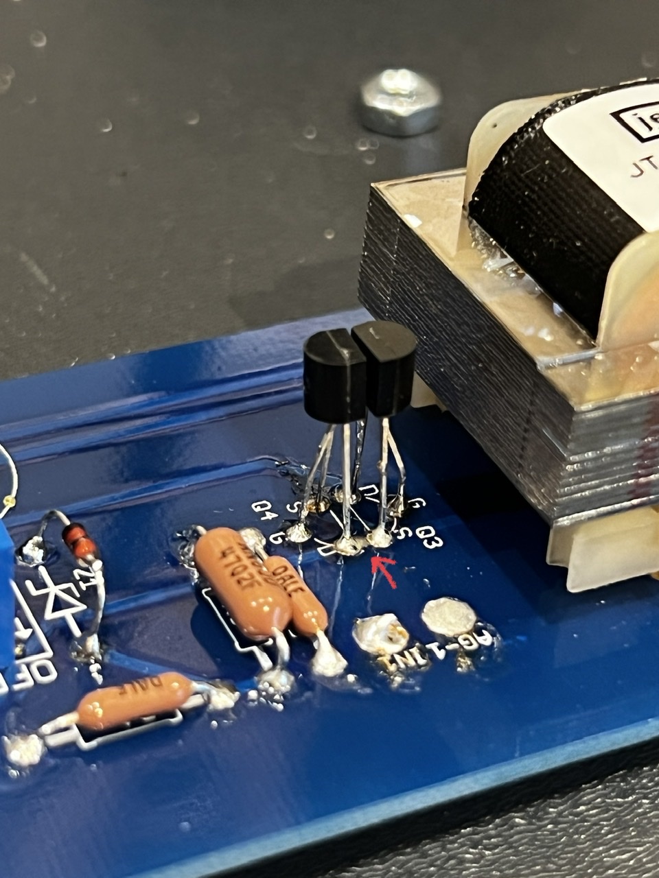

Hey Mike, the Jfets sure are in the correct spots. The DMM reports correct voltage and polarity at the terminals on both sides pre-smoke puff per the above pics. I also checked for mosfet leg shorts or any shorts to heat sink but it was well insulated. No continuity to sink.That stinks. Were the JFETs in the correct spots? Referencing to ground using a mono supply, you should have positive to both sides so long as the power supply wires are hooked up right. How are you checking between your + supply voltage on the left board and ground?
Freebee, my soldering skills sure needs work, but I did not see a drippy bridge on the legs. The back side of the mosfets wasn’t reflowed as well as the front tho.Have you checked all the solder work? Are there perhaps any 'bridges' or shorts (e.g. FETs or MOSFETs)?

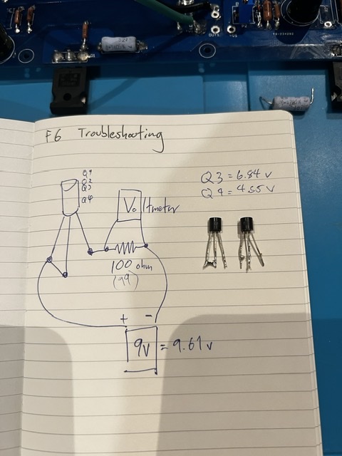

The point of using a 100 ohm resistor is best illustrated by attached picture. Since you will have a bench power supply this will possibly be moot. Start off by limiting current (if possible) and use +-10V and go up.
@strongbow60 much appreciated for the picture. Very easy to understand. Did you just drew that in a program for me? That’s awesome. I learned a lot thank you.

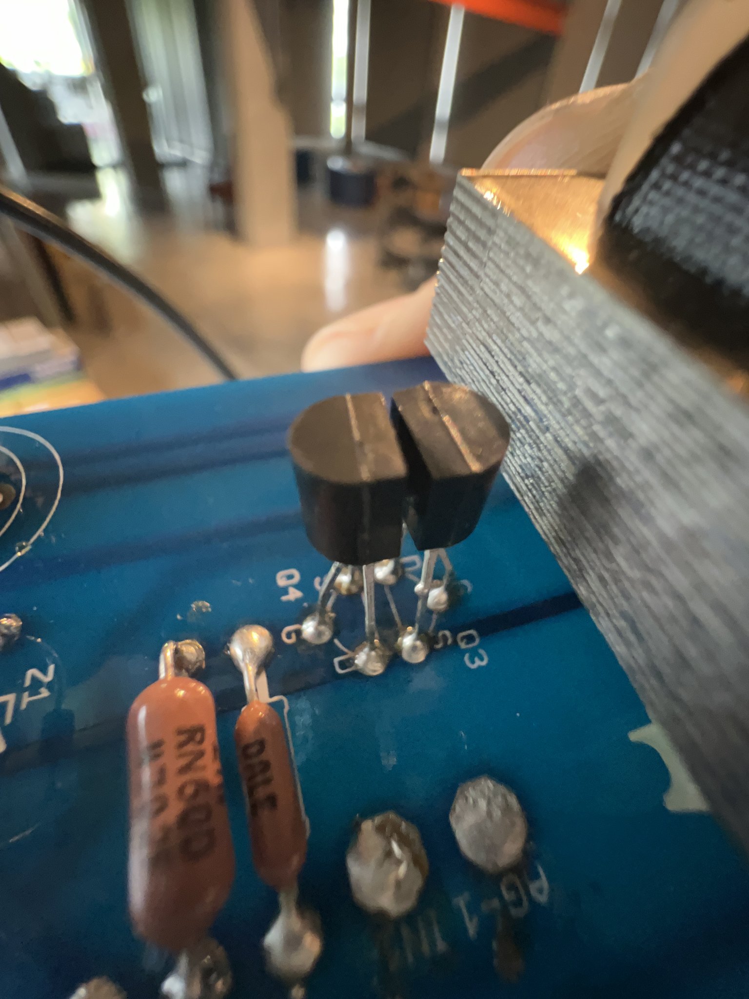

I think this could be the short. Before reflow there's barely any space. In fact, if I recall the smoke explosion, it looked a lot like solder flying from the small bridge. The Jfets casing is intact with no burns. I have since cleaned the boards and about to go into testing the Jfets individual health.
after hot air reflow below
@Mikerodrig27 I may have found the “short“ above. It could be dried rosin reflecting, but the first picture the spacing was less than 0.1mm Before reflow. And also a question for you on the IRFP150. It appears I have IRFP150NPBF version, and FQH44N10 is no longer available. Seems similar enough but I don’t want to assume things. Based on the data sheet, do you and others think this okay on slightly lower input capacitance specs?

Outch, not good!

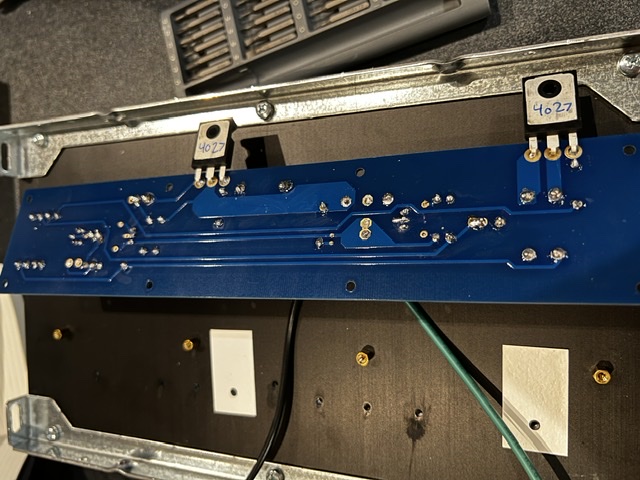

Besides, as a personal observation, I think that you are using to much solder on each joint. Each hole is plated through, It requires just a small amount on each joint on one side only.
A solder joint should be smooth, a few (less than five) seconds for most joints. For the bigger resistor and mosfets it will unfortunately take longer (or turn up the heat or use another point). The reason is that the wide copper traces will transfer away heat very fast.
Yeah I just saw an old post of Zen Mod in the aleph J thread saying the same thing to someone else having a short. Welp, lesson learned! will be gentle with the rebuild.Outch, not good!
