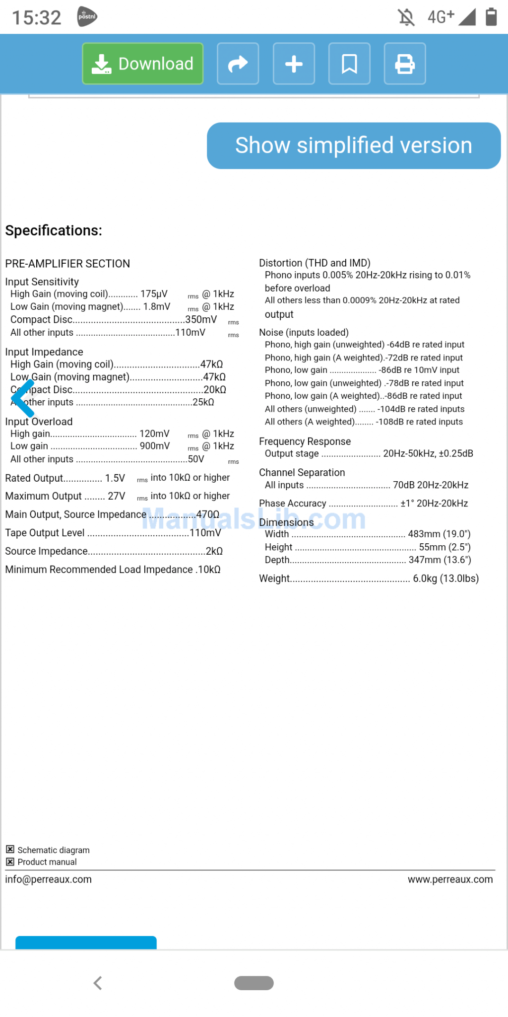

Volume knob is between 9 and 12. For the phono I need to 'boost' the signal via the switch at the back.
I am now listening through my Quad 33 and this sounds way better than the Perreaux (less anaemic, rounder but not as detailed).

Find that my F6 is detailed, however is not as dynamic as I had hoped. Could it be a mismatch with my Perreaux SM3 preamp? Or will the sound change after 100 hours or so? Have upped the bias from 575mv to 700mv.

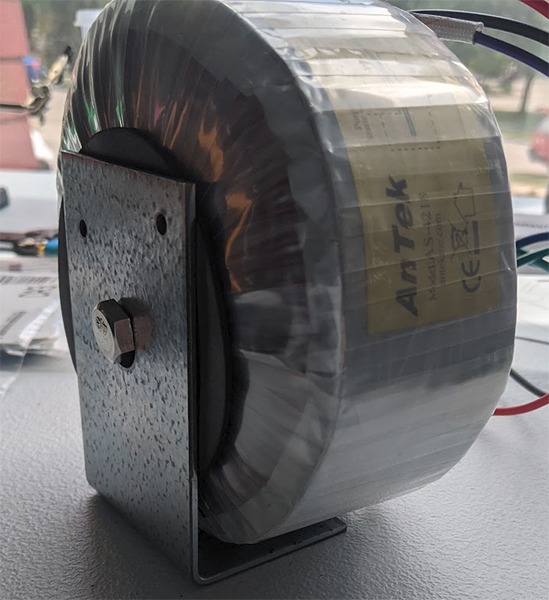

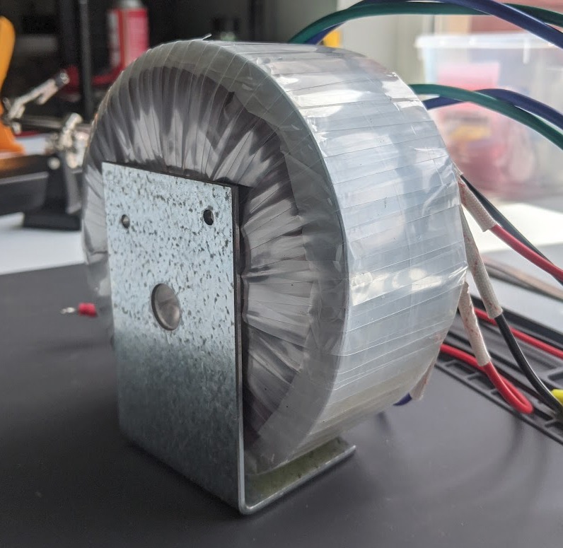

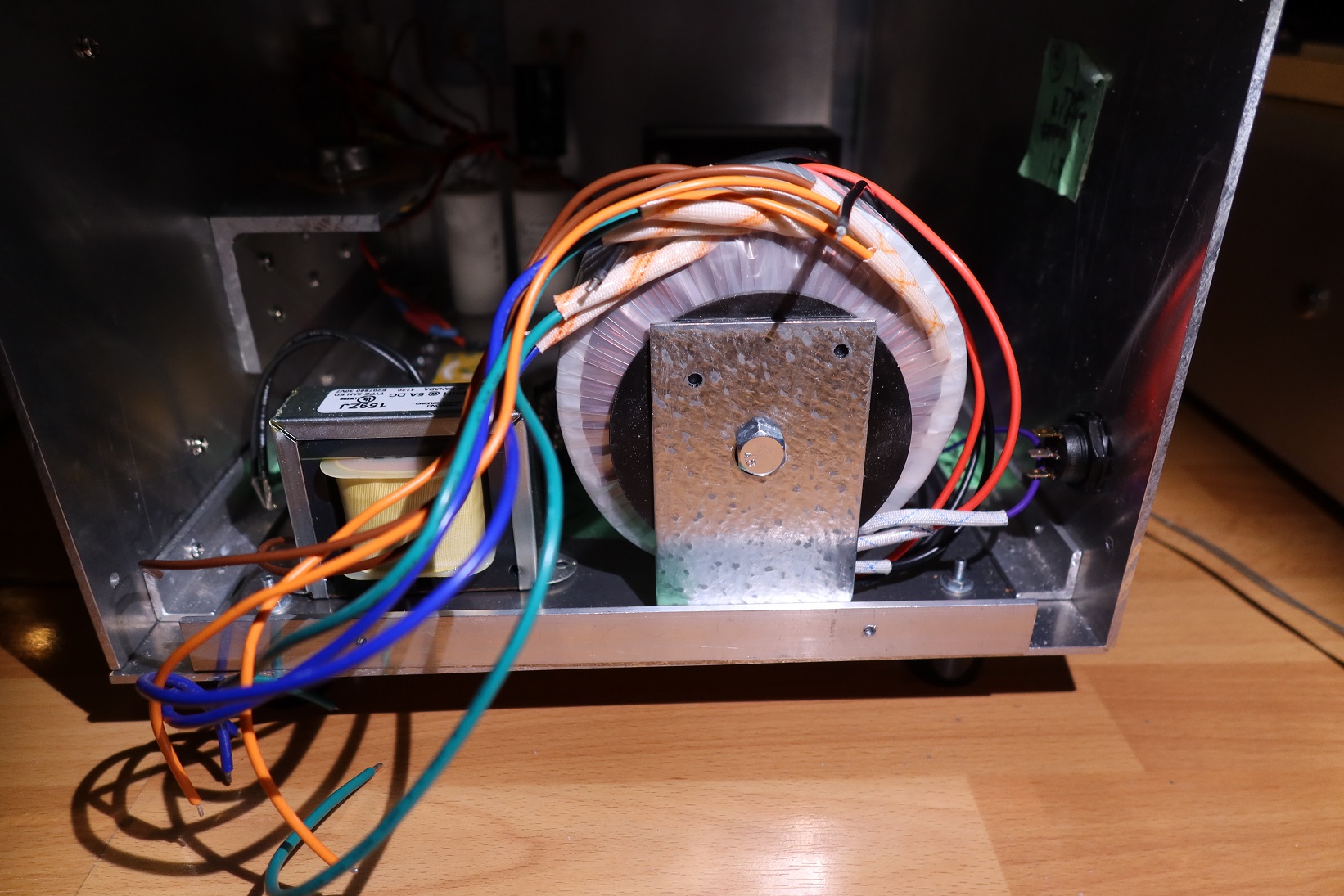

I already have my power supply built/working, but was looking to mount it vertically to free up some case room - I bought a strongtie bracket that I saw suggested somewhere else here on diyaudio and when I was checking the sizing on it today against my transformer, is it a problem if the side of the transformer comes into contact with the side of the mounting bracket like this rather than being high enough to be floating? Should I try and see if I can fit a piece of rubber to protect the windings or is that not necessary?
woops, apologies for being unclear, I meant the side of the xformer having contact with the bracket assuming that the regular mounting hardware was also present like this, I think you're probably right and this bracket may be too small either way but wasn't sure if this is hypothetically a problem, I don't think it causes a short but wasn't sure if it could hurt anything else
