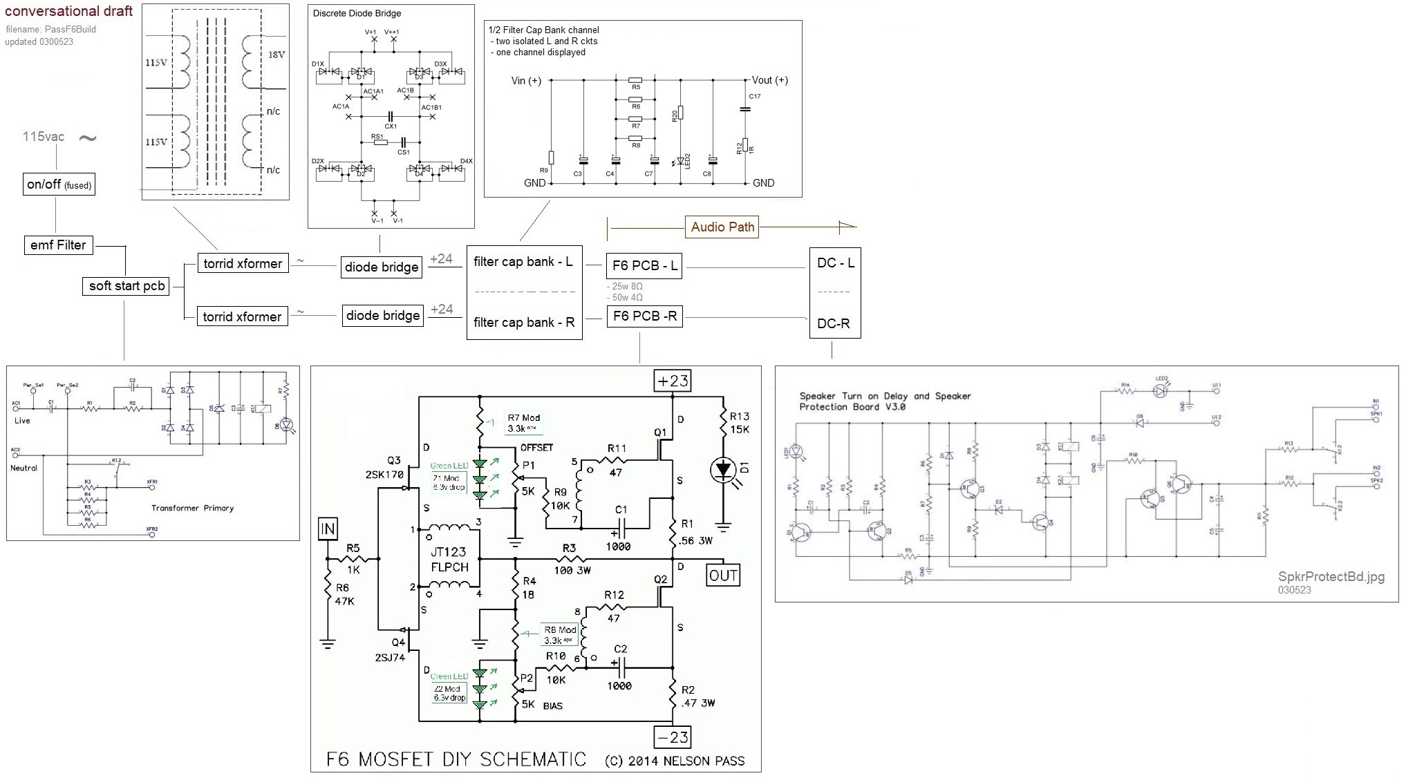

Soft start goes before the transformers. If you are planning on the DIYaudio one, there is a mains neutral, hot/switch out, and switch in. Then after all the circuitry controled mains out to the transformer.I am having understanding issues... many here can easily answer these.
- where does the 'SOFT START & SPEAKER TURN-ON DELAY / DC' fit into the flow
- having confusion as to which torrid transformer to order... suggestion as what to order
- any scuttle as to when the F6 kits will be back into inventory
The speaker DC board goes from the speaker out of the amplifier board into the DC board, then out to the speaker terminals.
Read the soft start thread as there is a capacitor value that can be changed depending on how long you want the soft start to wait before switching the relay.
If you do not have the transformer already, most here use the 18vas with 2 secondaries instead of center tapping. you will have 18vac coming out of the transfomer which after it is converted to DC will turn into around 24 volts
In the interest of setting realistic expectations, 18 Vac secondaries will yield 22.5V DC rails or a little higher. This depends on the rectifiers and bias current. Better rectifiers will drop less voltage. Spend some time looking for alternatives to the usual GBPC35xx, such as the VS-MB series from Vishay.
Consider building a dual mono supply with a pair of 300VA transformers.

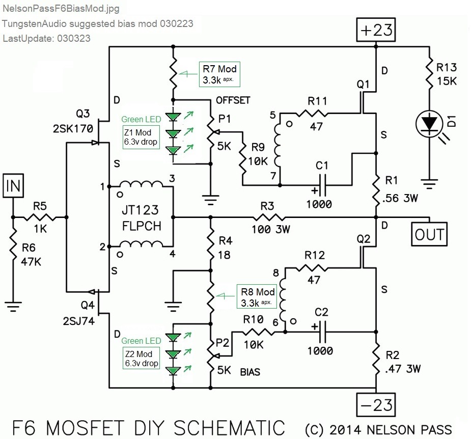

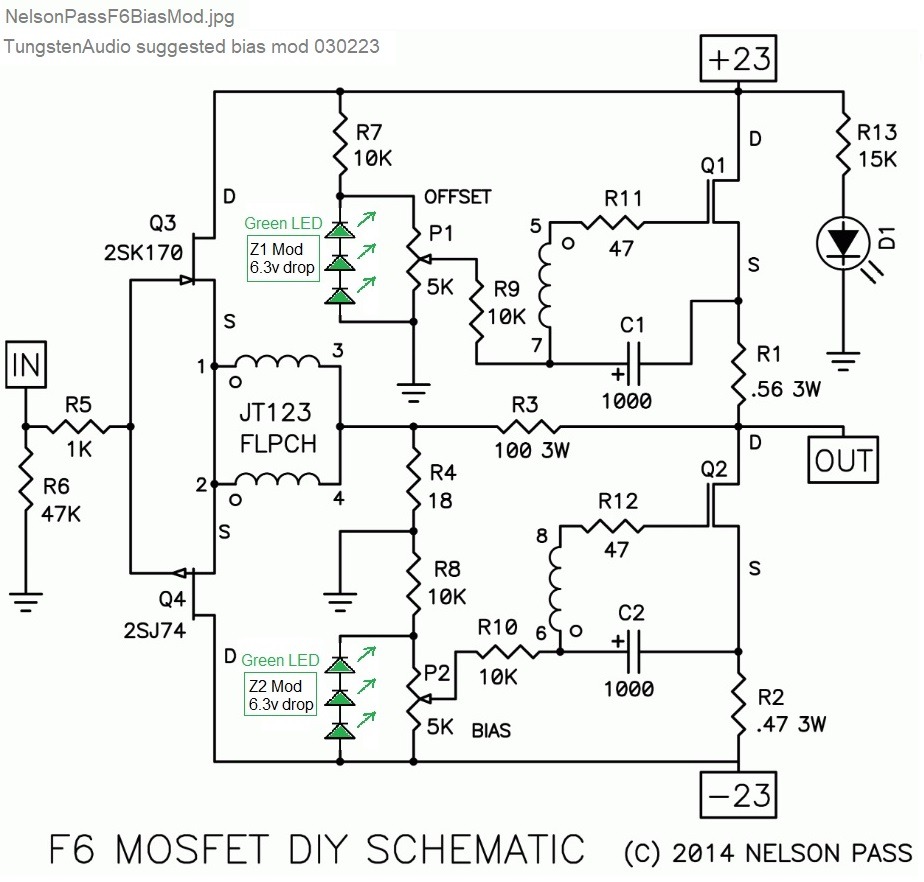

Well, there are some alternate bias circuit options for the F6. My favorite is using three small green LEDs in place of the zener diode. A search in this thread should turn up the modification.
The F6 can benefit from higher bias, and the LEDs have a negative temperature coefficient that lets the amp settle into its thermal equilibrium a little faster at a higher bias levels.
And more question for your insight and experience.:
Rectifier question:
Would this be acceptable or overkill?

Build value added F6 and ACA quality questions:
(1) any known issues with using an audio quality EMF filter sealed can?
(2) any known issues with a DC speaker protection ckt.?
(3) double torrid build on F6... for the money increase, would you build it this way?
AND... should I delete my previous post images to save server space?

No need for EMF filter
I have ran my F6's for years now and no DC never escape to the speakers , even with the water cooled one
double mono is the way to go , for not that much money after all , remenber when you diy you got way more for less than commercial stuff cost

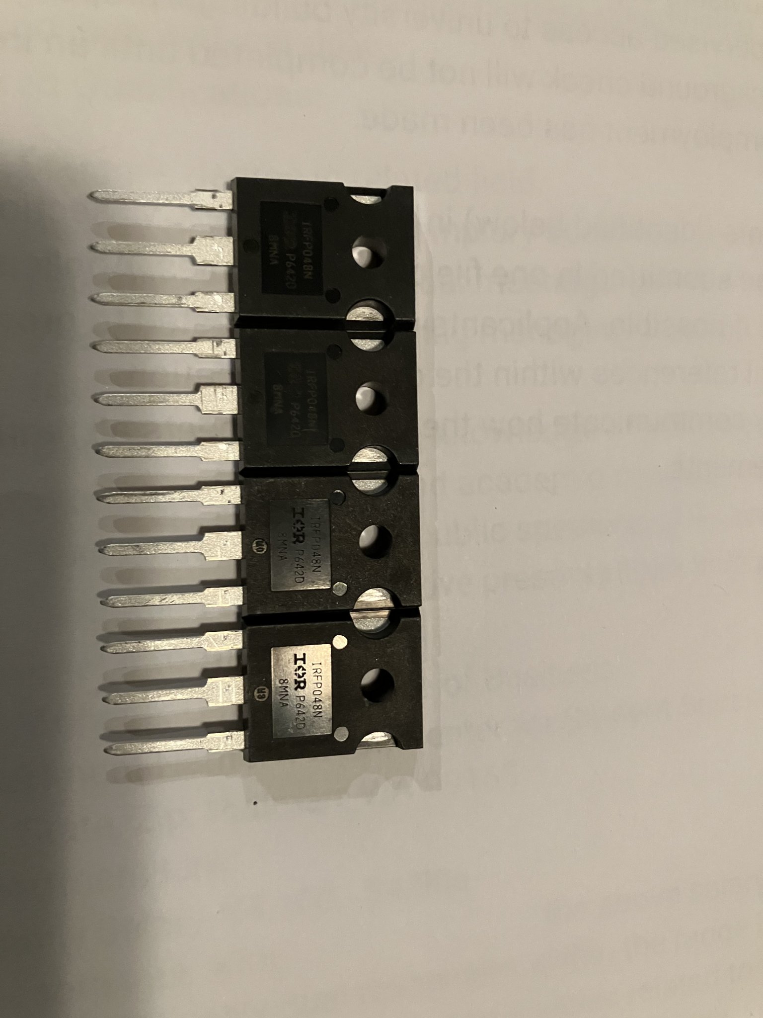

The new set of mosfets from the store comes with the irfp049 mosfets and the 9.1v zeners. The last two I ordered for my aleph j build, came with the 240s and 5.5v zeners (I think I measured them correctly. didn‘t need them for the aleph j).
Do the new mosfets have to be used with the 9.1v zeners, as shown in the original build guide, or can the lower voltage zeners still be used with the lower rated R7 and R8? Do the mosfets have anything to do with the zener value?
